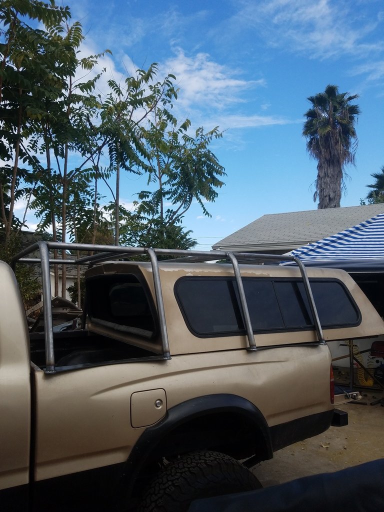

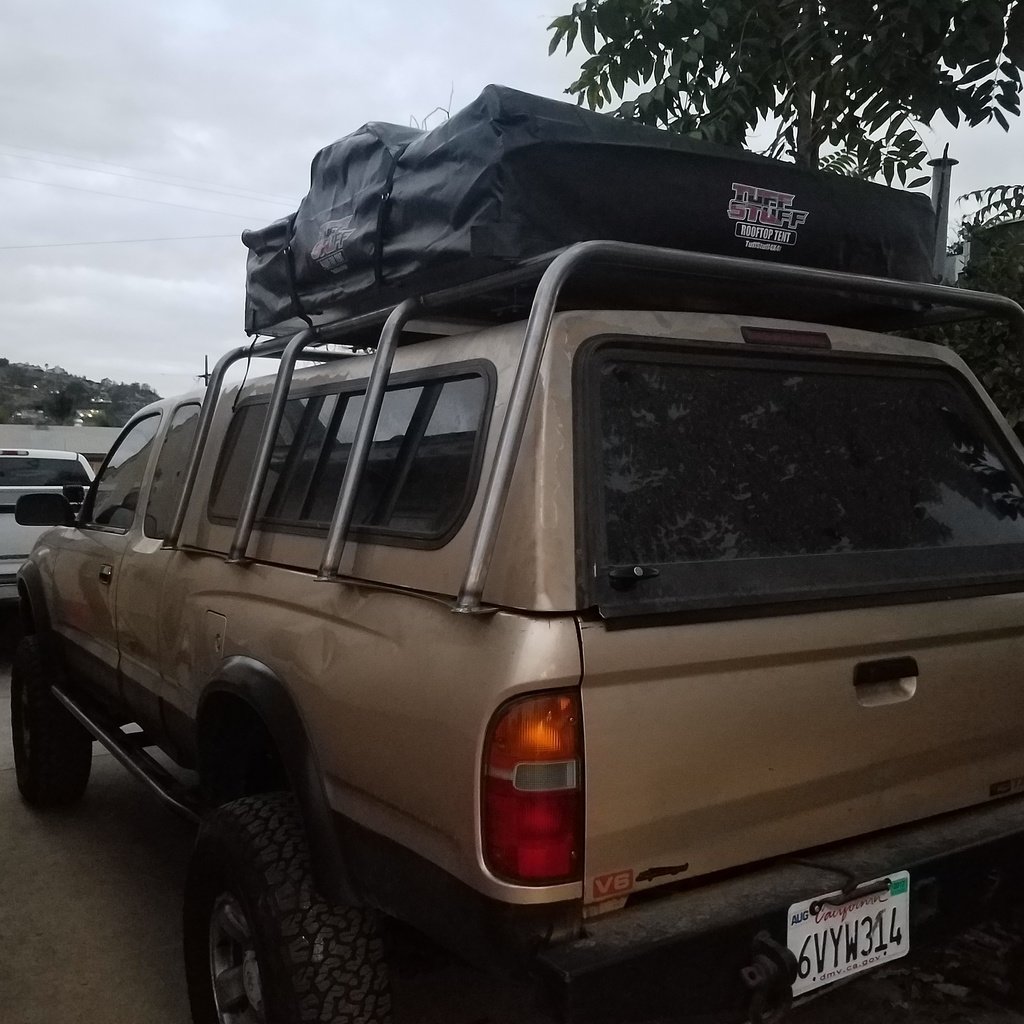

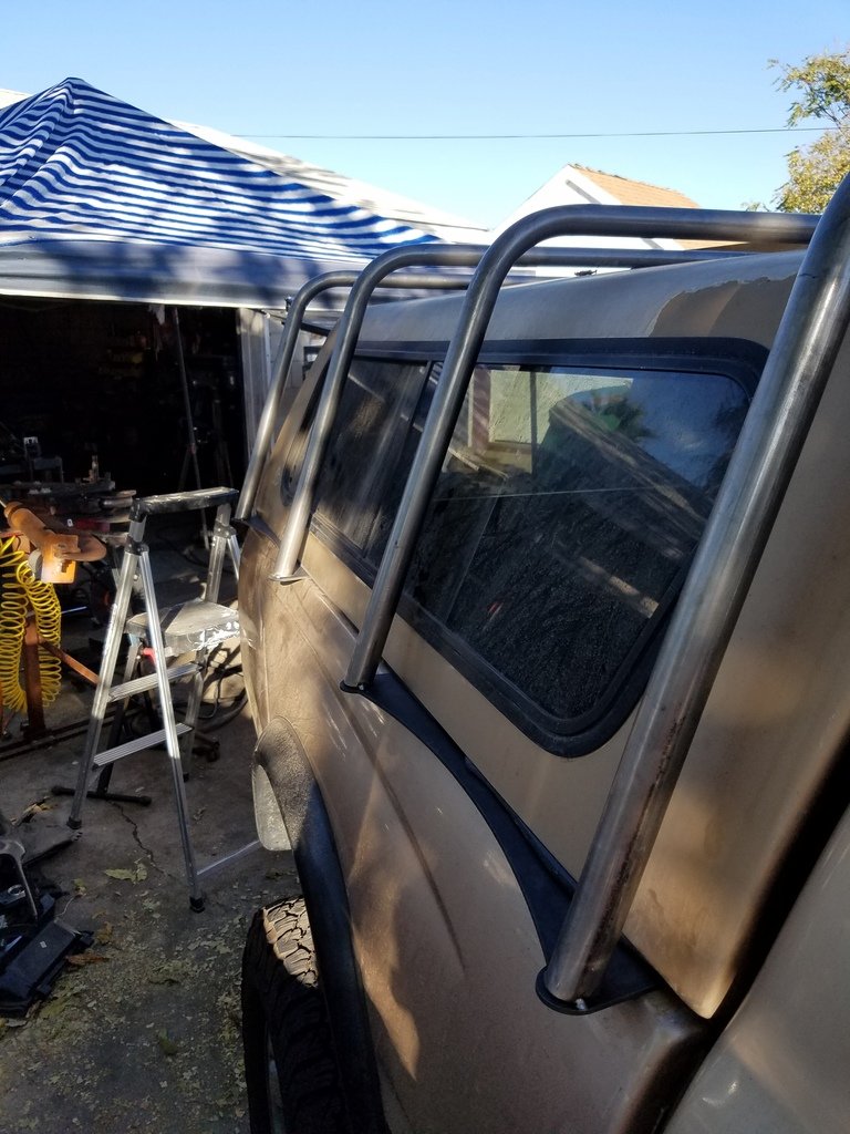

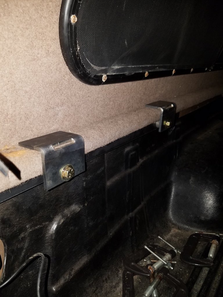

    bolt on bed rack for those of you who wanto to keep your shell.

    Looks good! I still need to hit you up soon on a custom rear bumper..

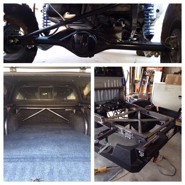

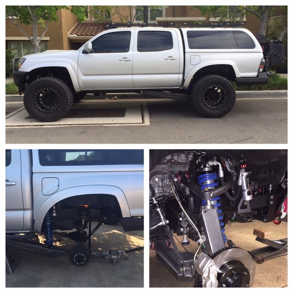

    whats the final travel numbers on this? 12" shocks? ive been staring at this all day... why do you guys do this to me

    I think it was 19.

    I think Jeff is right, bumped and strapped it ended up at 19-20" . ...you know...just what everyone needs to go camping :) Yes, 12" CO's, 55" links. If you went through the bed you could use 16's and hit stupid travel #'s but we purposely kept my bed sealed. The short bed is so useless I could not afford to give up space and did not want to open up the bed so the bed cage bolts through the bed to the shock towers and the frame perches Jeff built.
    Edit - btw the pic from the back underneath is with the ass end lifted up on a engine hoist which is why the panhard is at such an angle.

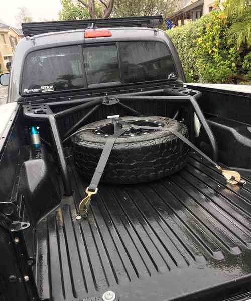

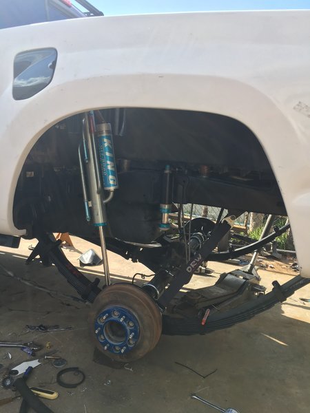

    The rear end jeff just completed for me! :D:thumbsup:
