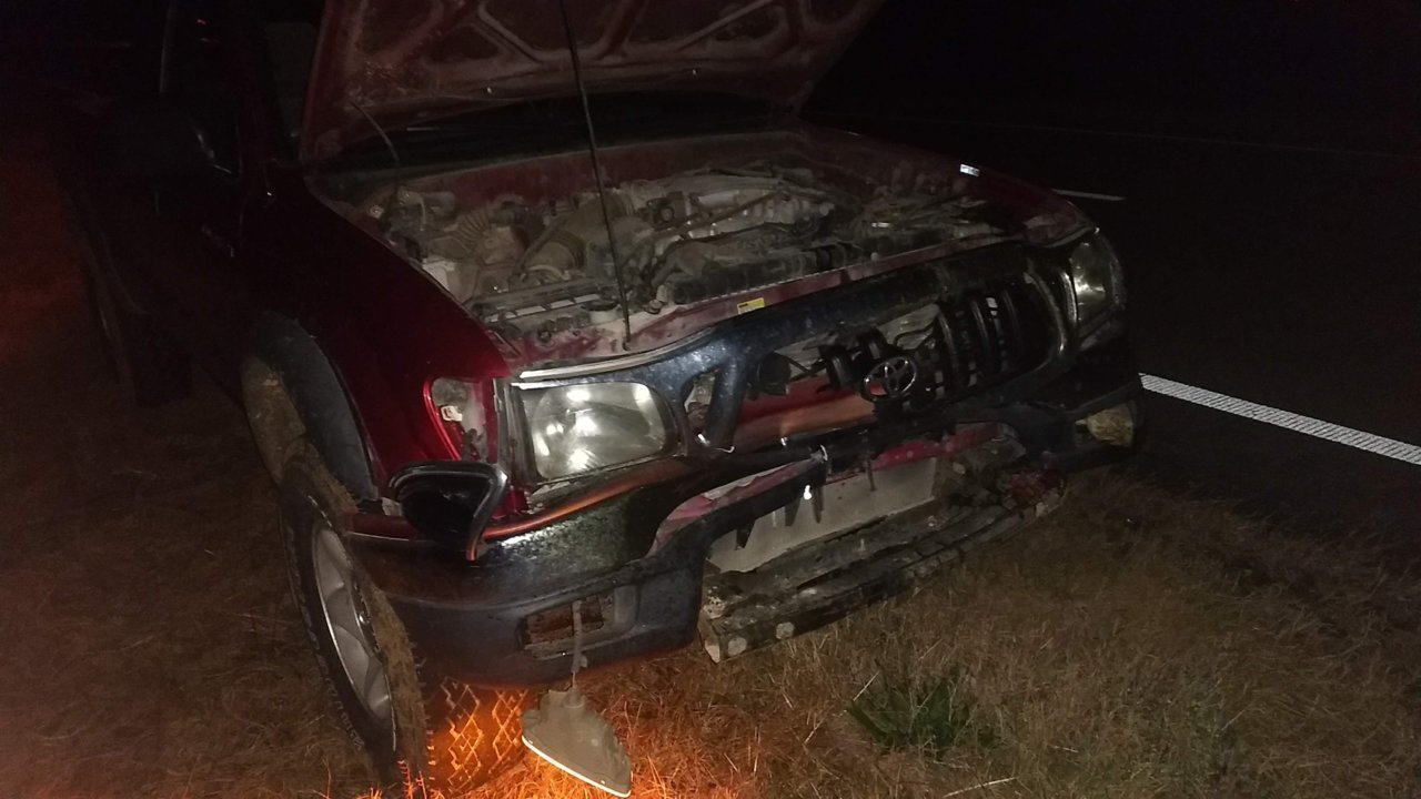

    I got my first Tacoma (impulse red pearl 2003 extra cab 4x4)winter of 2016 and it was my grandfathers before mine, but it met an unfortunate demise the day after I finished finals winter of 2018.
    I was heading to deer hunt early morning, and a doe jumped in front of me when i was going around 65 without enough time to react. busted radiator and radiator mounts, bulged fender flares and a destroyed front end ended with the truck being totaled.
    The aftermath:

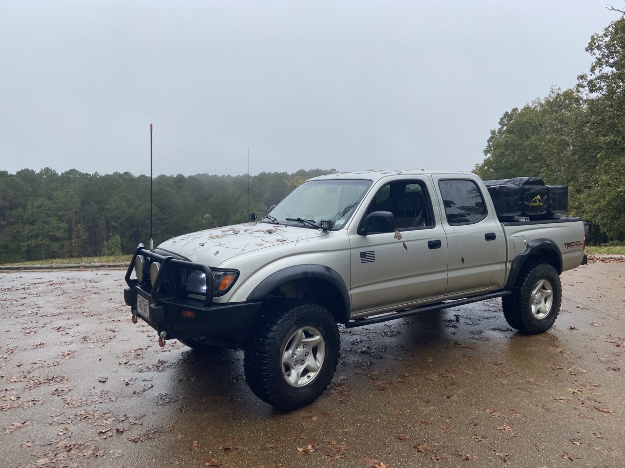

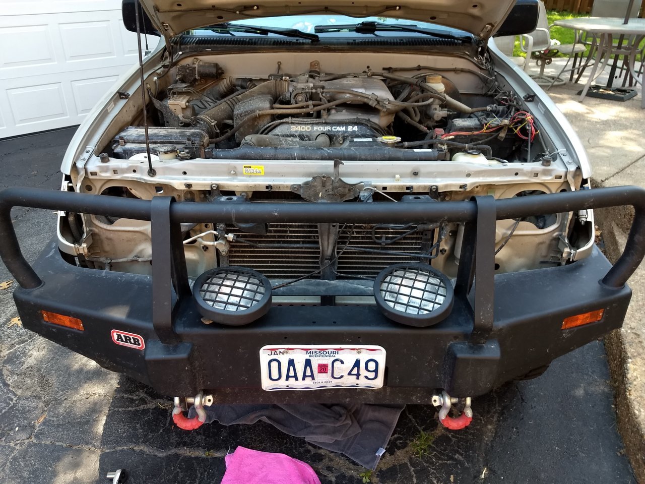

    Pics from different stages-

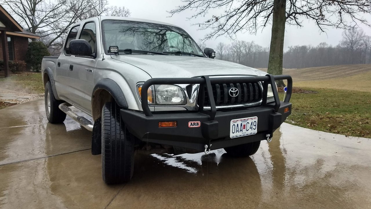

    Right after bumper install

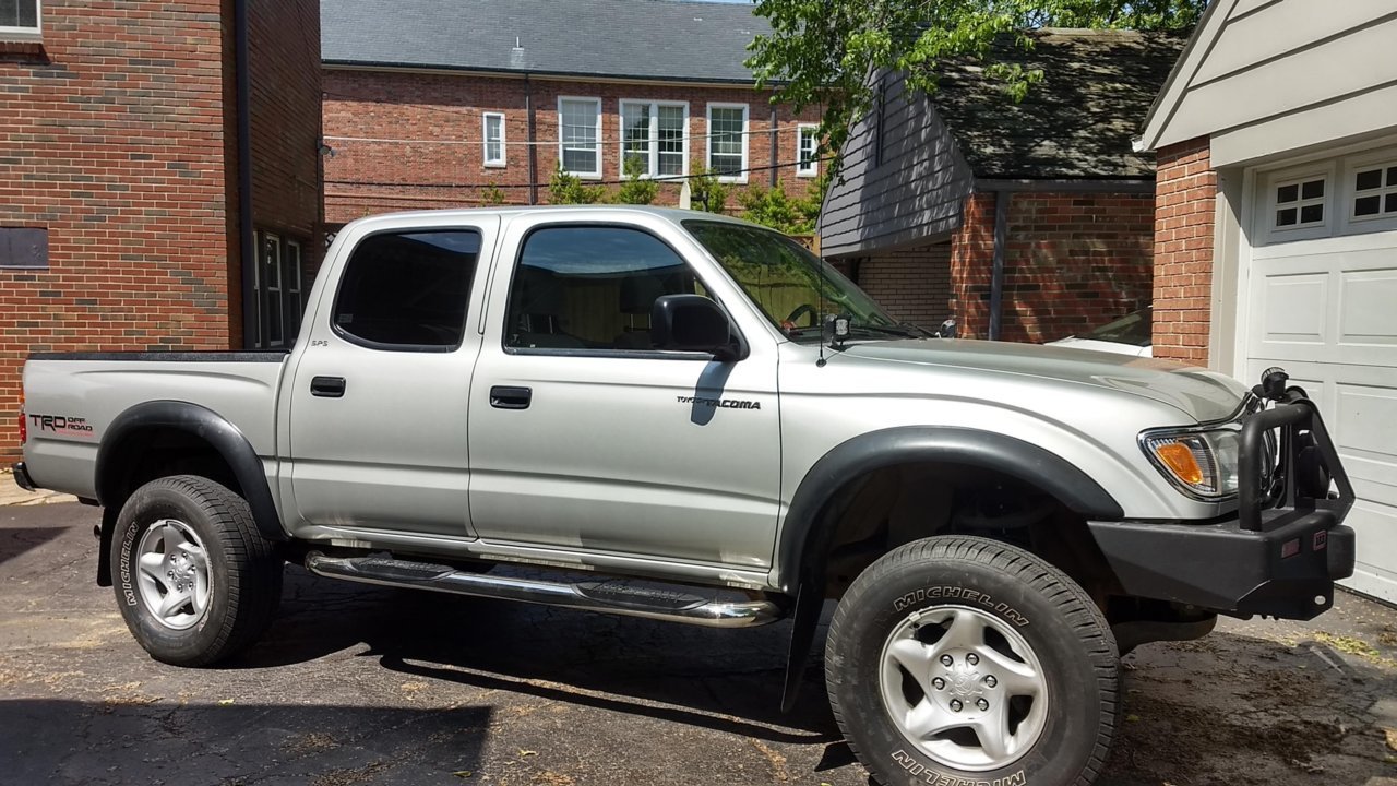

    I tournament fish for bass for Mississippi State, so towing this is my half ass excuse for not getting 33s
    Right after spending a couple nights at G.T.'s to finish up the liftIMG_20190514_150300809_HDR.jpg

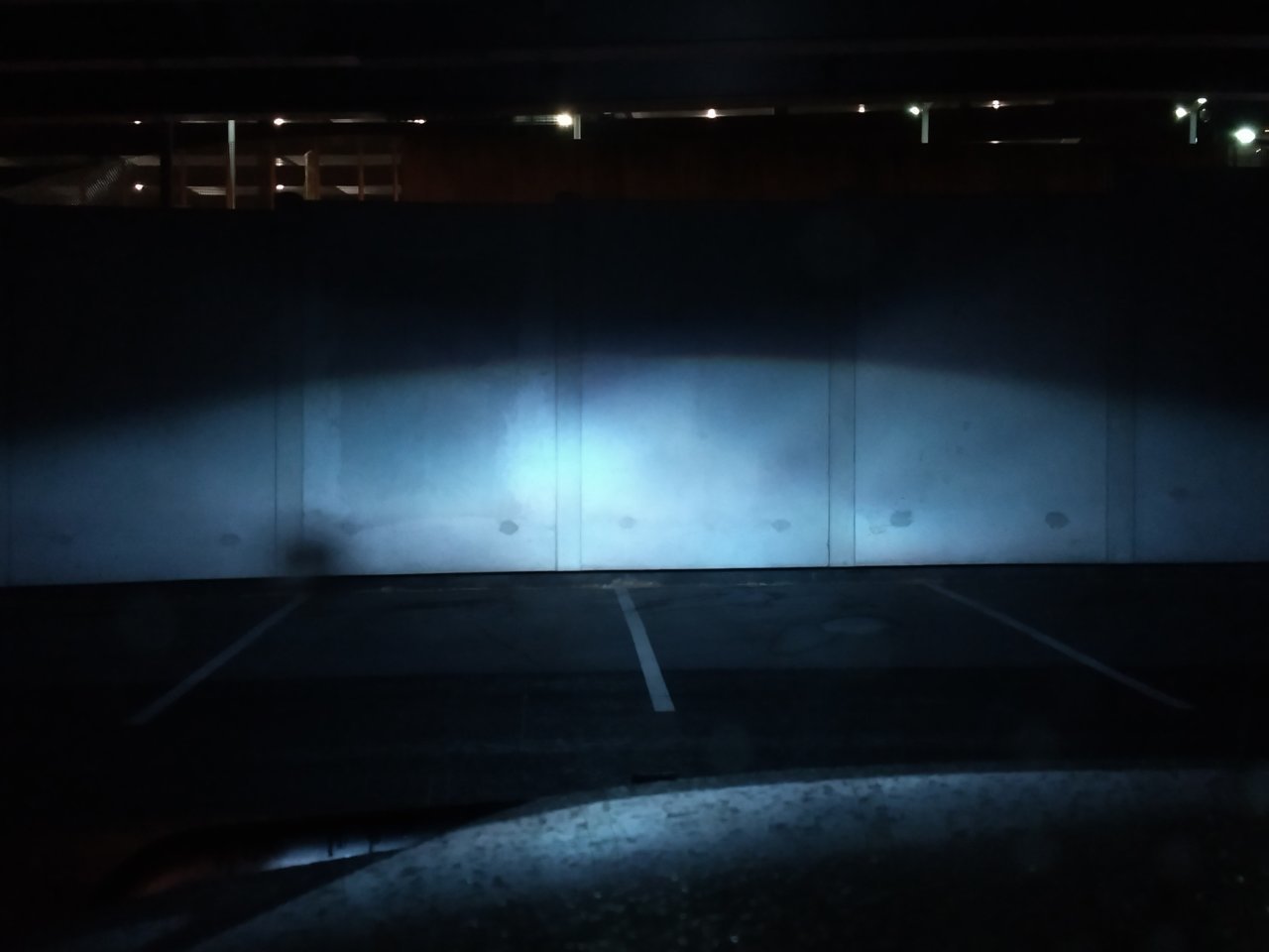

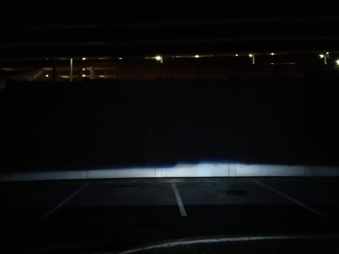

    New low beams
    High beams

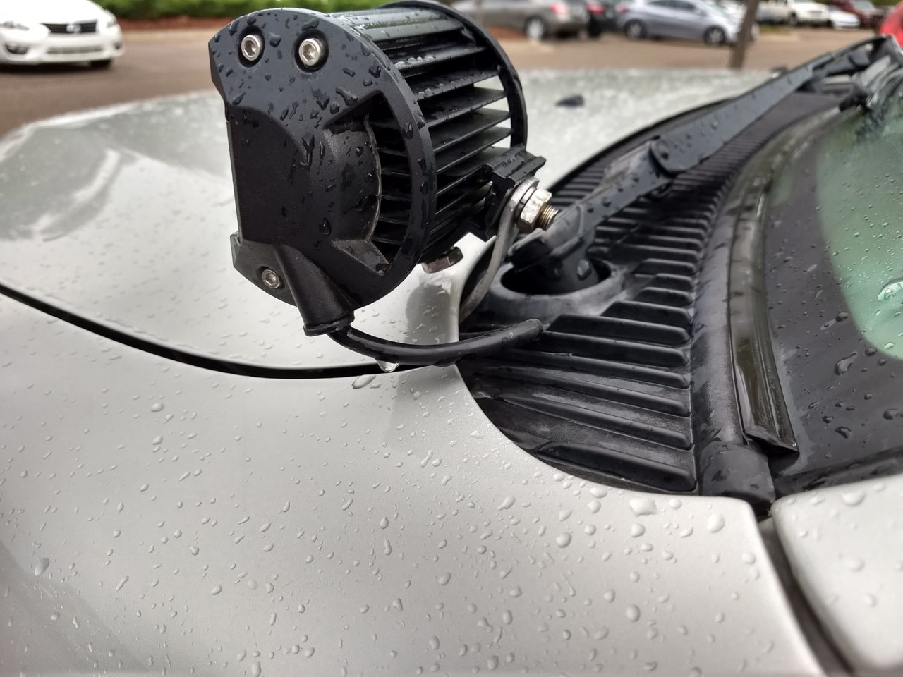

    First mod I did soon after purchase was ditch lights in hopes if seeing deer before it was too late this time. I bought cheap lights on Amazon that had good enough reviews and made my own mounts out of aluminum strip mounted to the hood hinges. They were meant to be a temporary fix, but 15,000 miles later they are still holding strong and I haven't had any trouble with them bouncing around too much or coming loose
    @chuckers here are the mounts
    Mounts:
    With lights on it reflects off the hood but it is not bad at all from the driver seat because it stays on the edges of the hood past where it dips down.

    Any recent pics? In the very first pics I'd like to know what headlights you installed and how you like them. Also, same pic, did you end up getting 33's after all. Good luck with build, have fun.

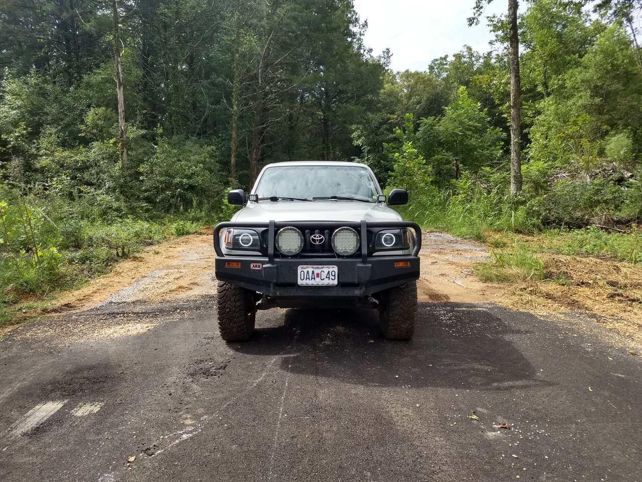

    Headlights I built myself. It is honestly pretty easy to do and everything is plug and play except for the Halo DRLs. It took me probably 10 hours all in working slowly but an easy 2 hours of that is into halos and another 2 for sliding my bumper on and off 3 times becuase it didn't want to line up or the nut clips would come out.
    Everything I used for the headlights except for a relay needed to wire up halos is listed under lighting in the first post(I chose to have them always on except for when headlights or parking lights are on to help with heat dissipation)

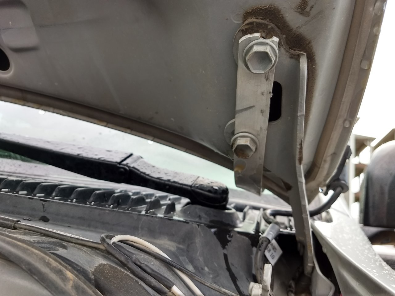

    Yea the ARB install instructions arnt really any help. I struggled on the install. If you have any questions let me know and I can probably help or take pictures of what mine is like now since it is all exposed with no skid plate. I'll try to do a write-up in here about the headlights to show how much work it is sometime this weekend.

    Thanks. My cross-member bar that held the stock skid plate was rusted so bad we cut it off. Wife ditched the skid plate long ago on an oil change when I was outta town. Wish she would have kept it. After bumper is installed I will be trying to figure out how to get that protection back. We left meat on the old cross-member to weld on something later if needed.

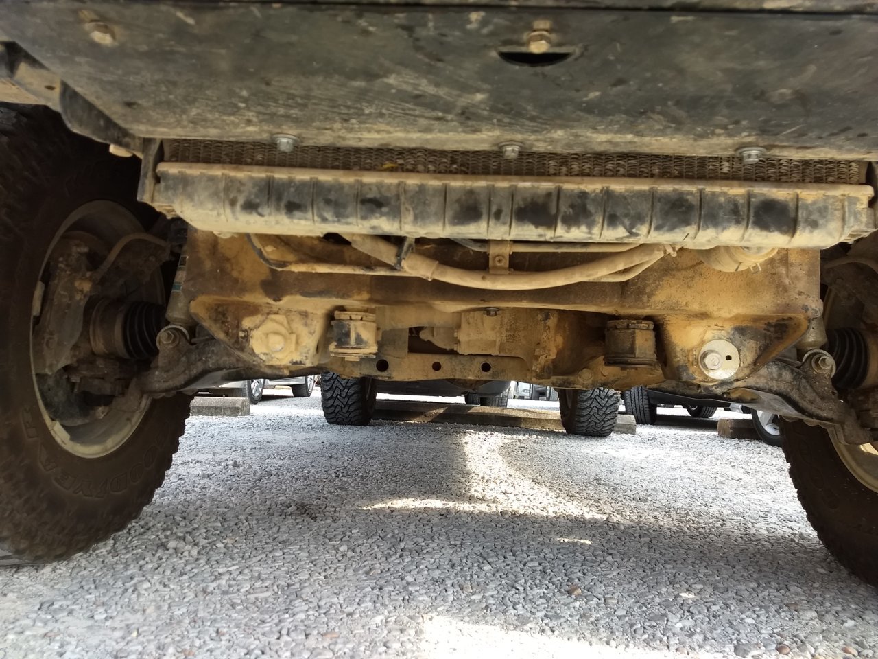

    When I put on my bumper the cross bar/bumper thing came off I honestly don't remember what the skid bolts to. My stock one was bolted to the cross member on the ARB that the back of the splash pan goes to, same one my aftermarket bolts to in 3 places, and the rear 2 bolts go just inside the rear LCA bolt where the stock one was supported
    The 3 bolts at the top is where both my skids have bolted to.
    Current skid and said big ass access hole

    Oops, try again, last reply was in your quote. Anyway, thanks, great pics. I need to get that cross member back in there. I like the new skid, is that custom? Sorry in that was already mentioned somewhere in build.

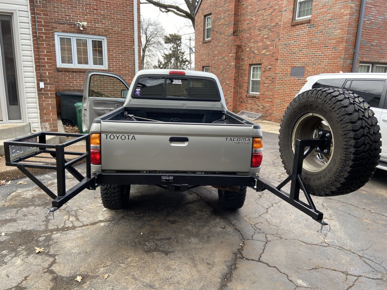

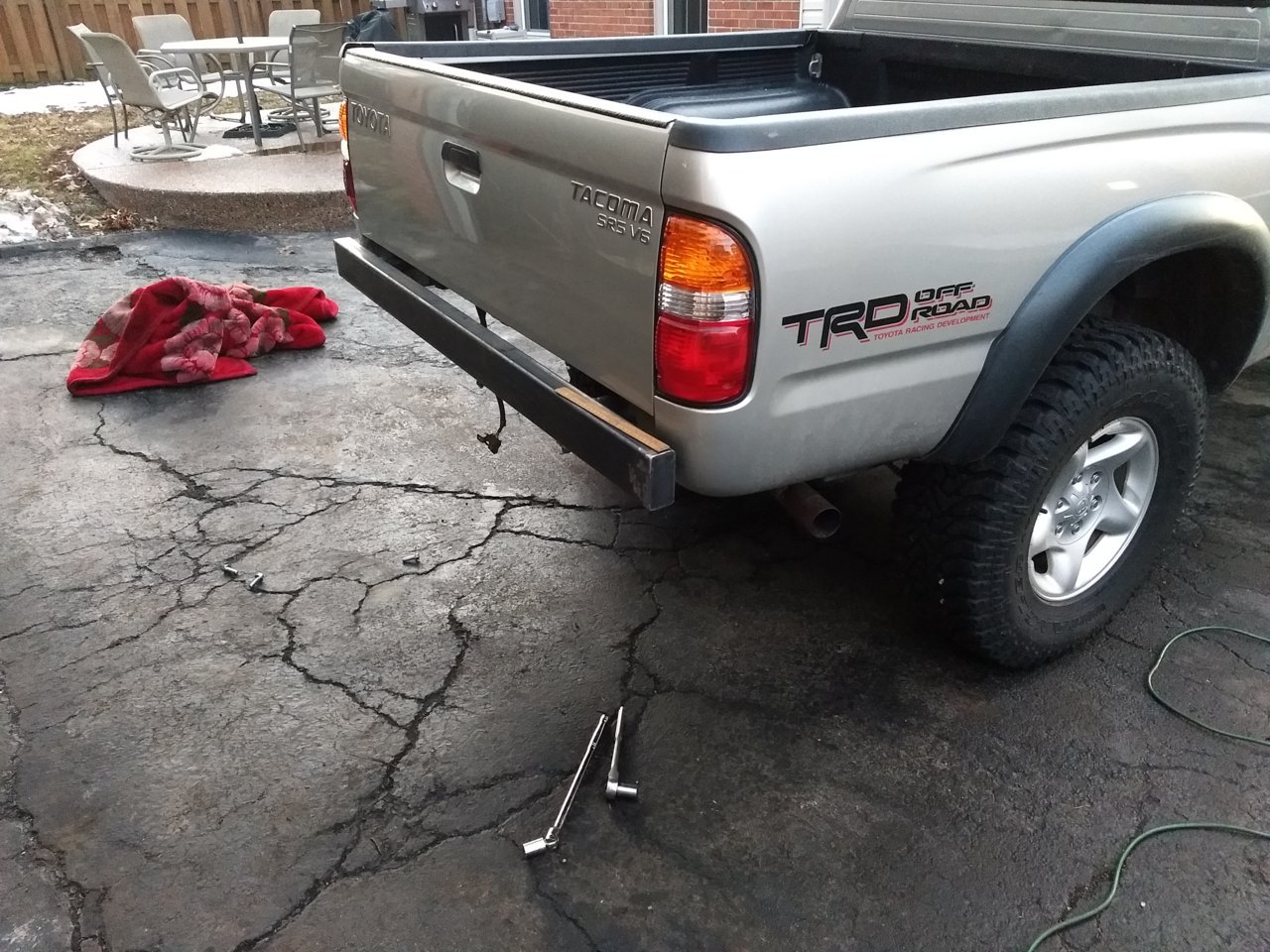

    Finally washed all the junk off the truck after a couple weeks of rain... I also built a dual swing out rear bumper in December. I’ll update with better pics soonB511E6E2-8F2D-4739-9AD8-BC015573C134.jpg87E25586-6F6E-482F-9FCE-B5D135E9CB1D.jpg

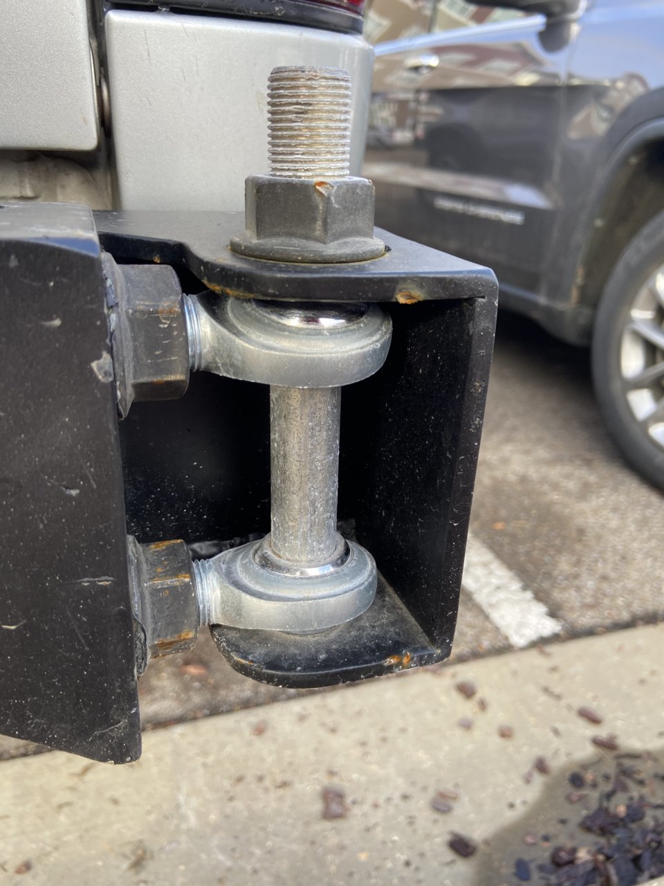

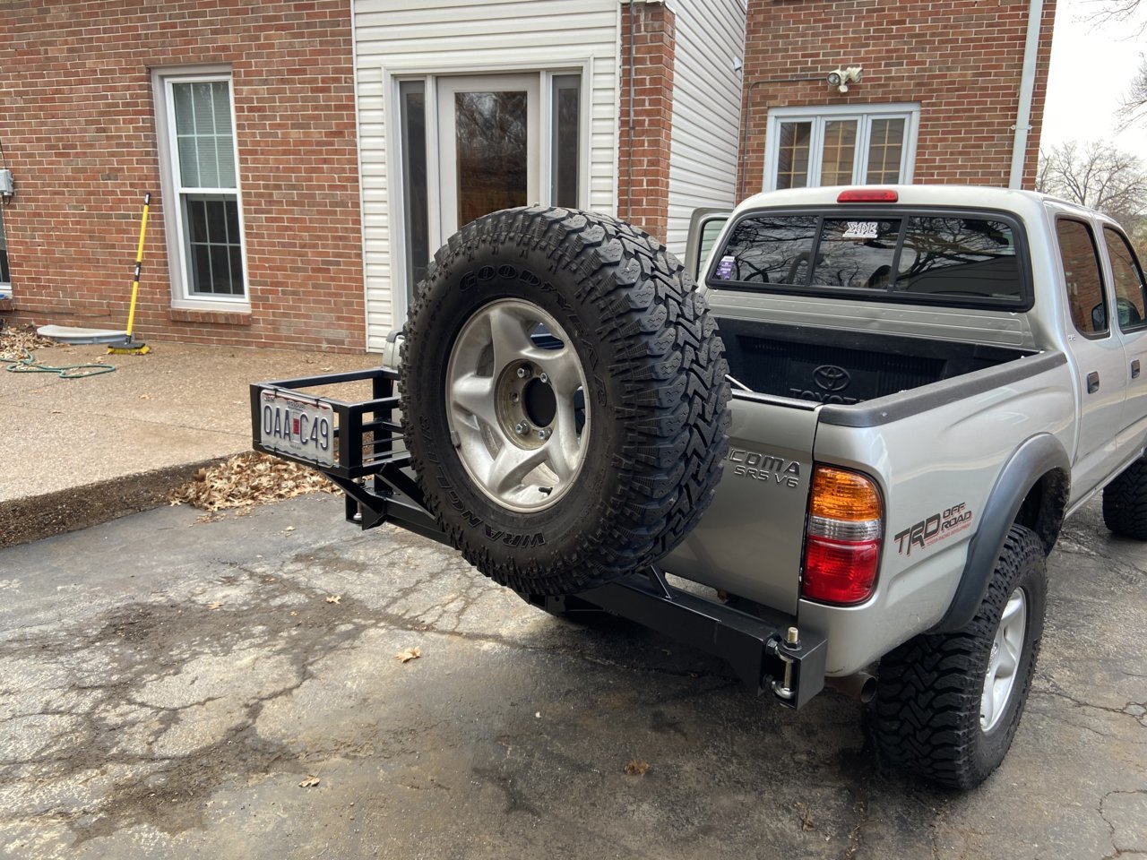

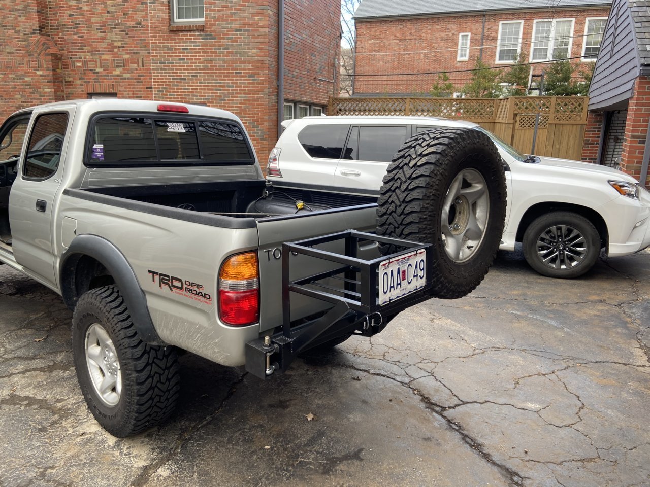

    Some pics of my rear bumper I built over the winter.
    4x2” 3/16 wall main tube with 1/4 plate where needed. Swingouts are a 3/4” bolt and 2 heims on either side made with both 2x2 3/16 wall and 1x1 1/8 wall tube. They are Held closed by 2x 3/8” pins
    Main tube before all the other junk
    Closeups of the heim pivots. It is cheaper than a big spindle and more importantly to me it is adjustable.

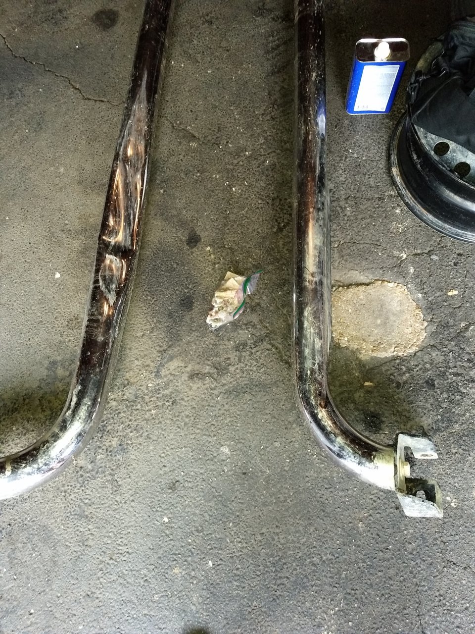

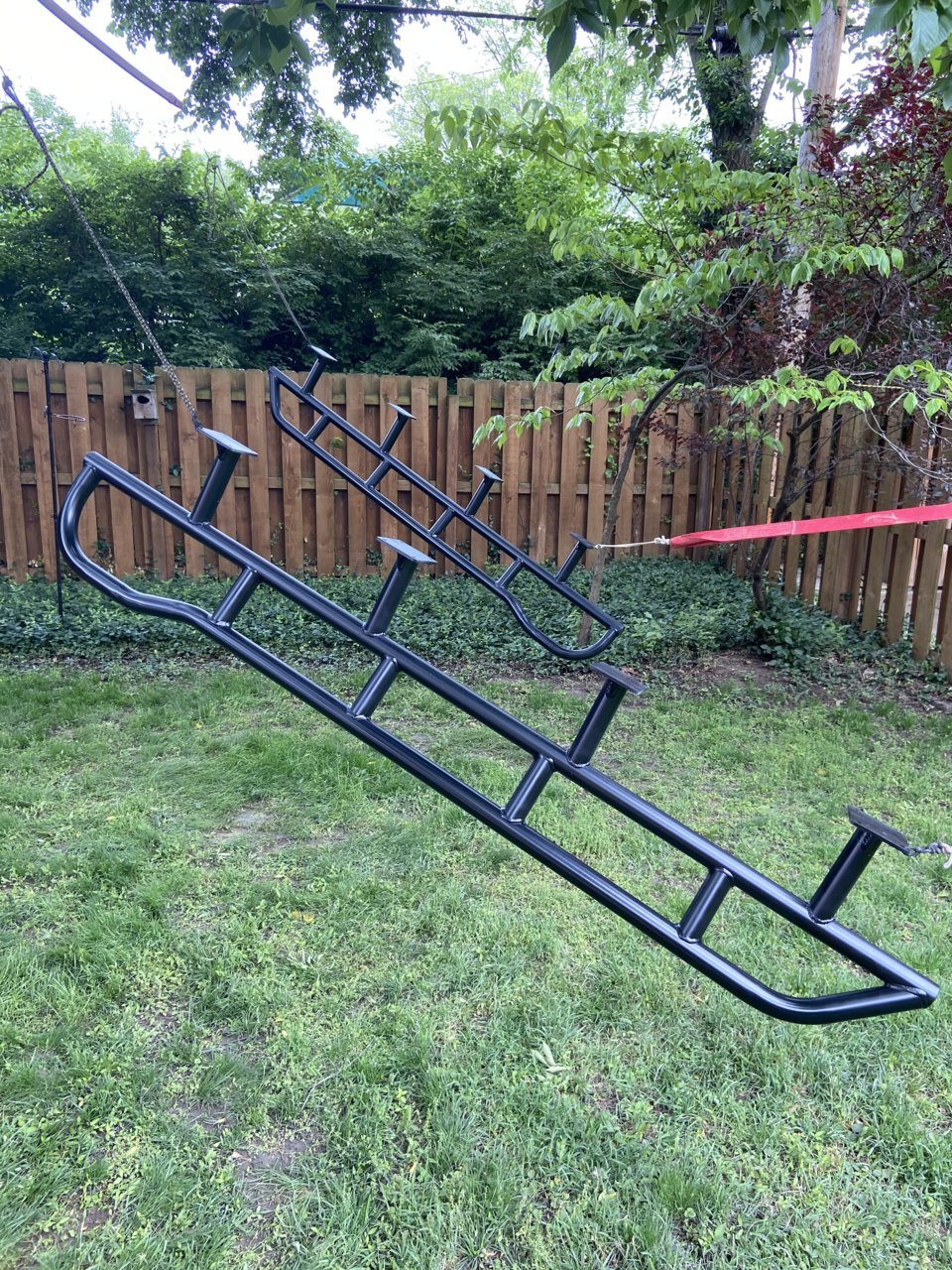

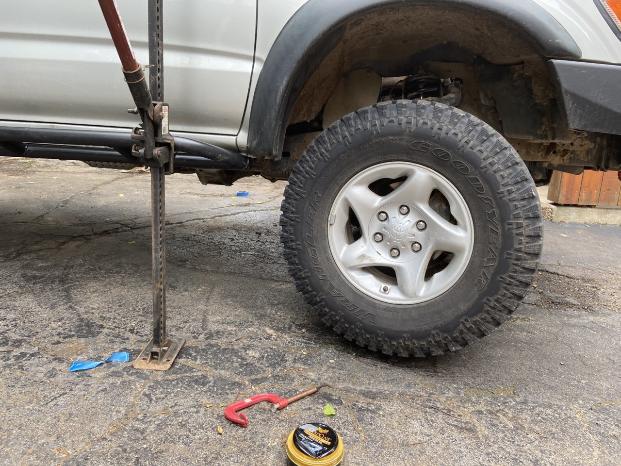

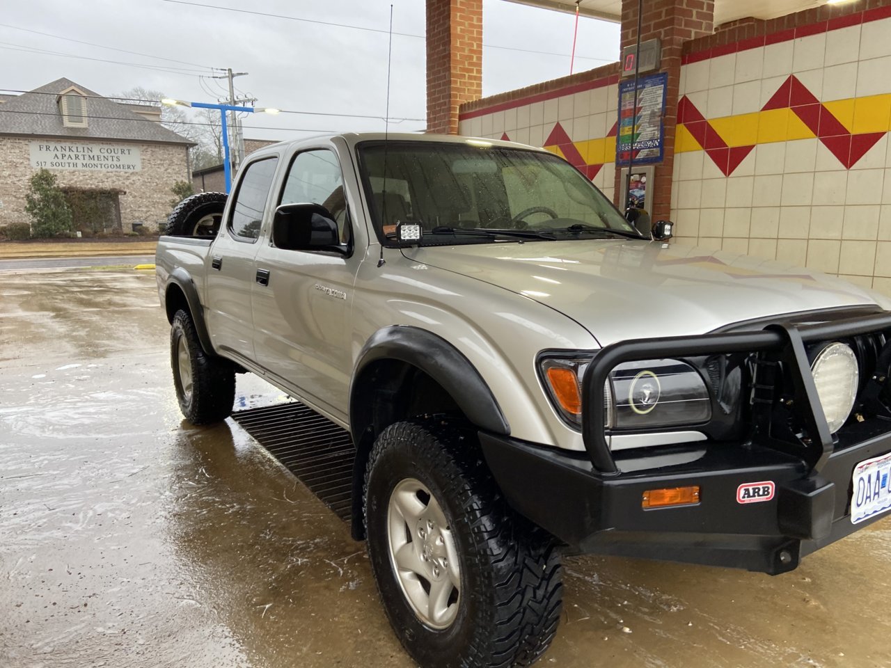

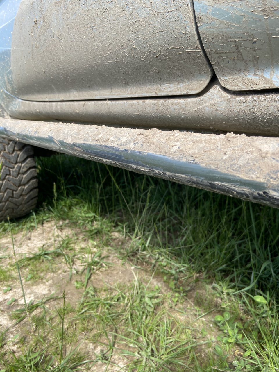

    Sliders went on in May. Long overdue but I wasn’t overly excited to weld them into the frame. They are welded at a bit over 18 degrees because that left the kickout about an inch from the door when open.
    3 coats of primer and 3 coats of satin paint
    Welded on- strong enough to keep me happy.

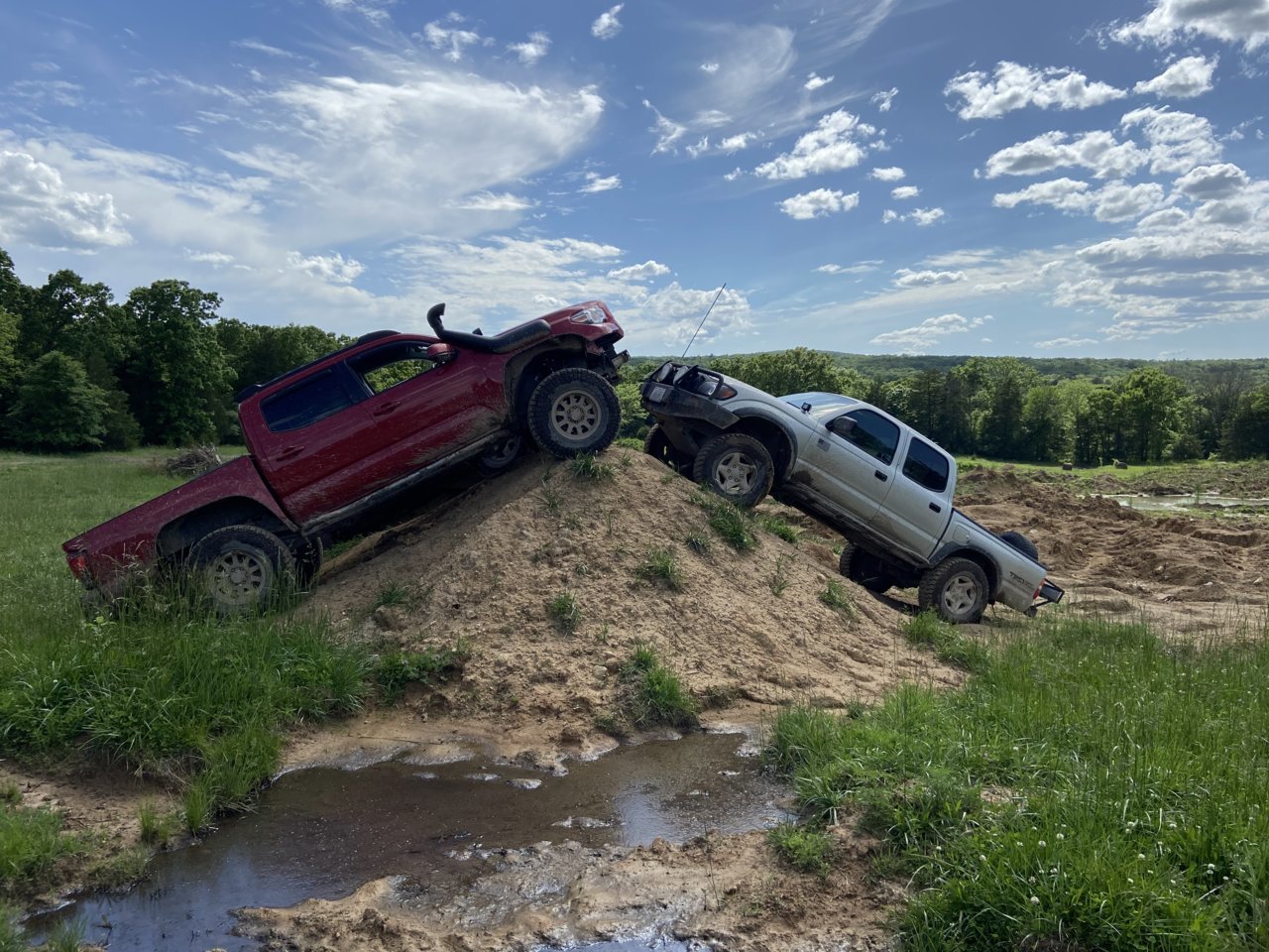

    Glad I took the time to paint them so thoroughly. Went wheeling the next day with @TacomaDad18 @Sasquatch3153 @uploadadventure and took some paint off both sides... I should probably touch it up or something3B90ECBB-87BC-44B7-878E-A2F33486B68B.jpgFB8BA5D6-CE2C-4860-8E64-557BE4A191BF.jpg
