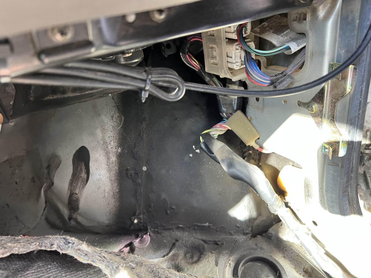

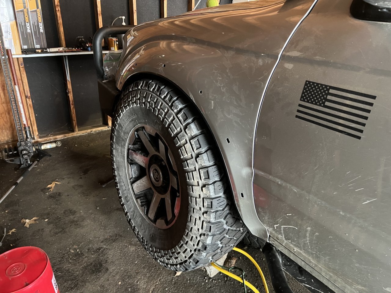

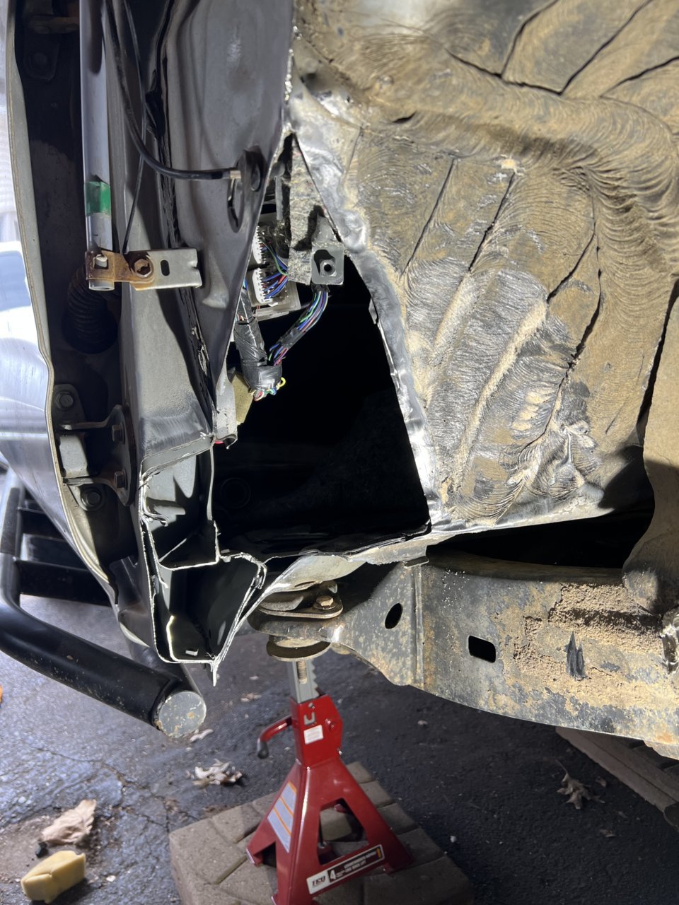

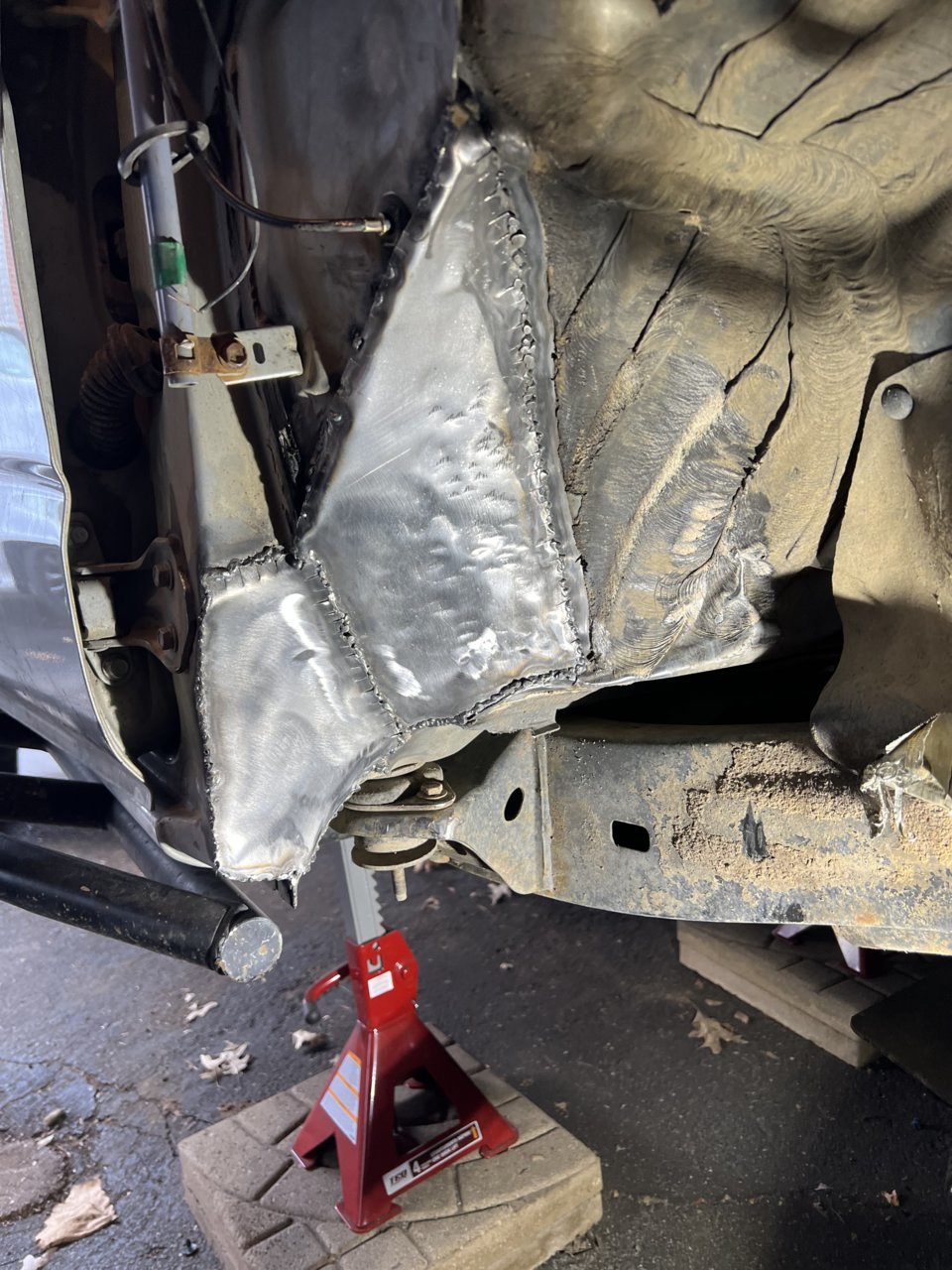

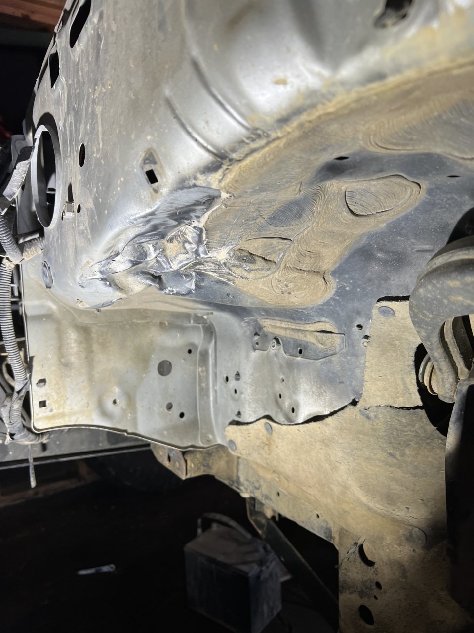

    Done with cab tub job for 35s. Probably spent 20 hours total including a couple store trips and an hour searching for a wiring issue that was just a relay that popped out.
    Removed tires, struts, fenders, bump stops and pulled back carpet and wires inside cab then cycled suspension and started cutting.
    Ended up about like this on each side. I highly recommended grinding with a wire wheel before cutting as it is a pain after. I hammered back the section to the right in addition to cutting here.
    Also had to hammer the upper front engine bay compartment, cut a fender support out, remove wiper fluid reservoir, and cut bumper.
    Welded plates in and was humbled trying to weld this thin with a shitty flux core HF welder
    Seam sealed and put a rubberized undercoat on it, cut fenders 1” (a bit more at the lower rear) and re installed to check clearance
    Had some electrical issues after (no gauge or accessory lights in cab and no tail lights) which turned out to just be a loose relay.
    I have my flares cut and ready to re install I’m just lazy and wanted to go test it. I’ll get them on before my next trip out.
    Still need to trim out the rear a bit more as well.

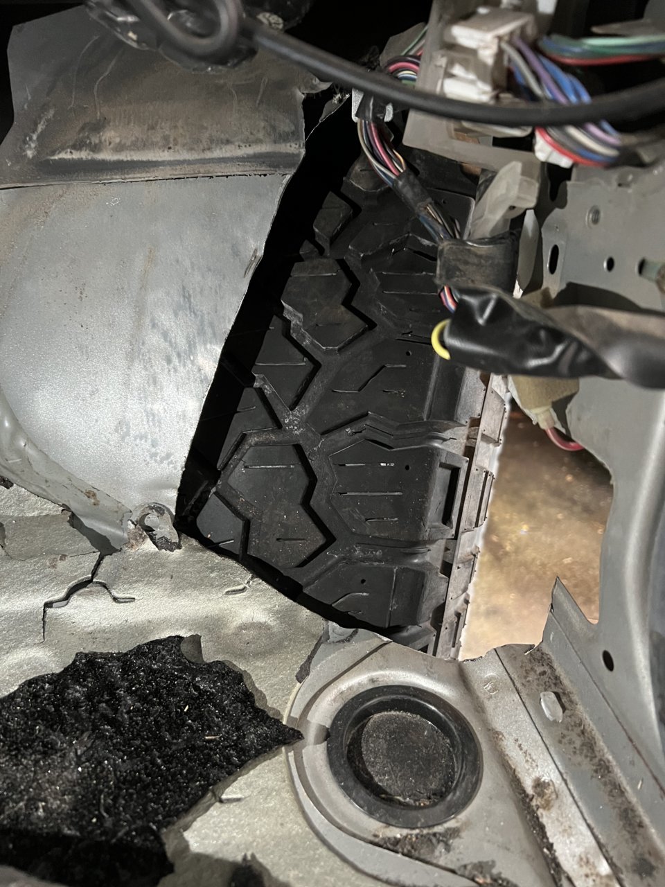

    What does the cab floor look like after you do this?

    I’ll get a pic tomorrow. I notice the loss of foot room and haven’t fixed up all the trim and carpet yet. Carpet and my husky liners sit a little funny but still works.

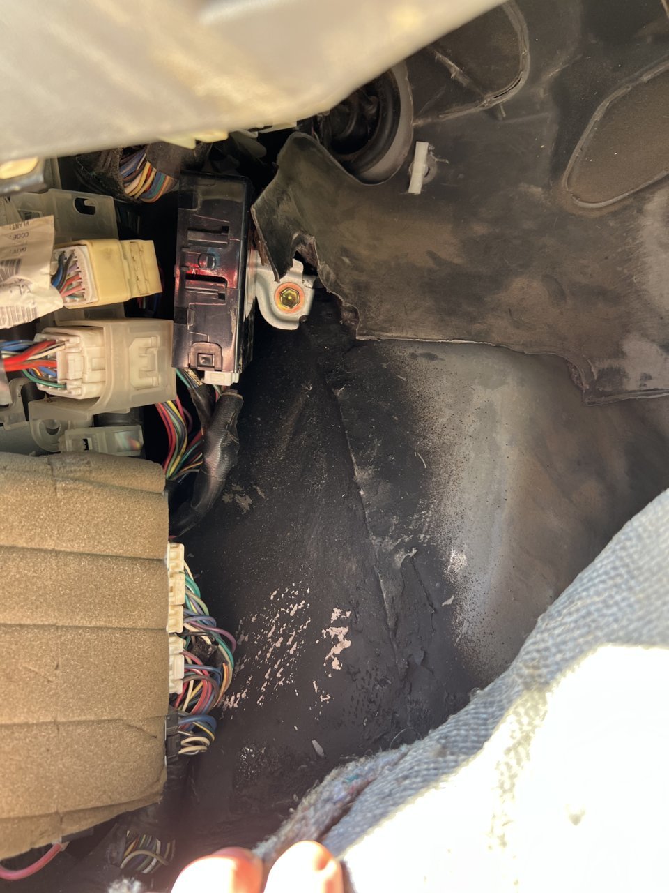

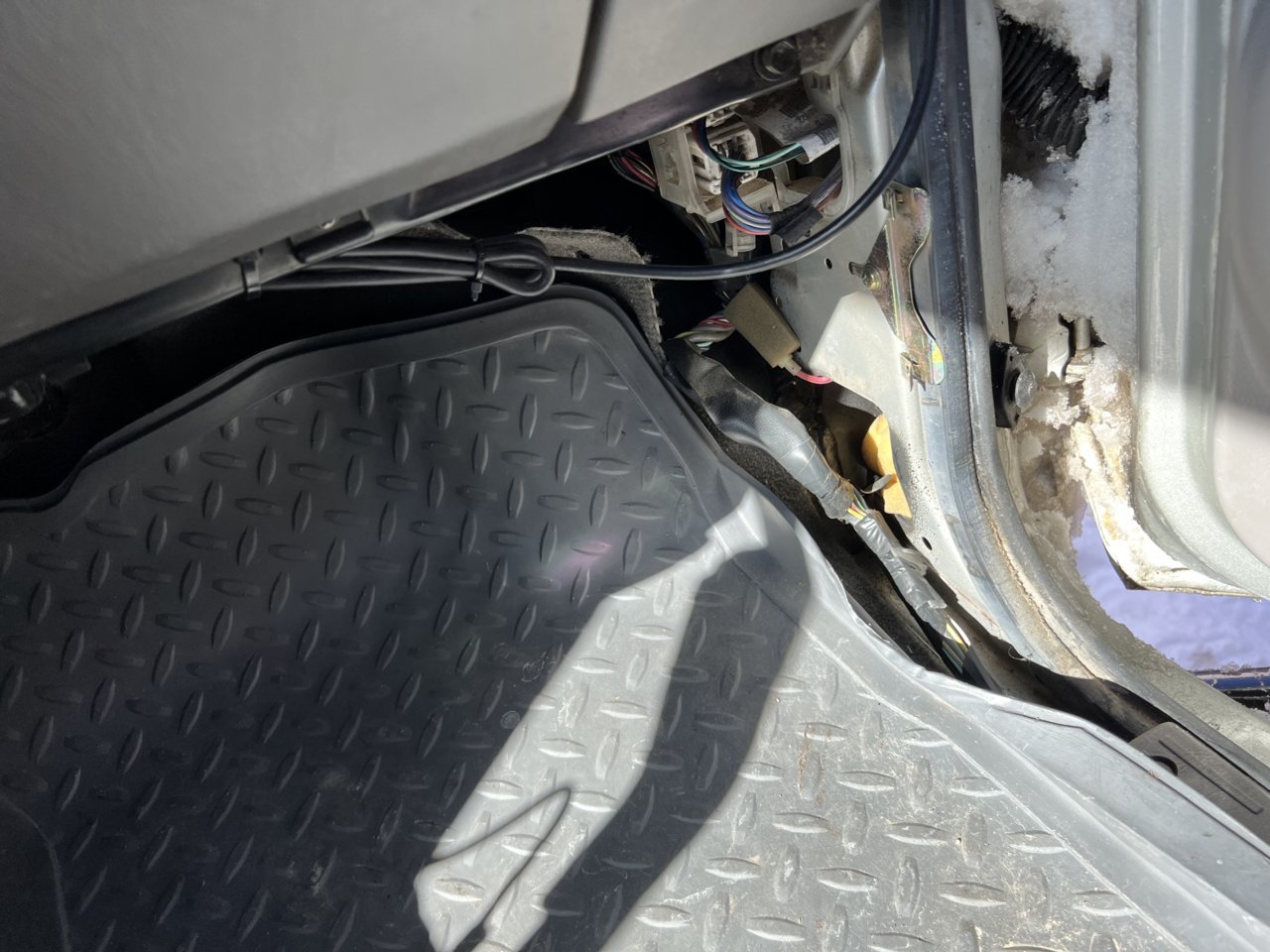

  15. Feb 4, 2022 at 1:42 PM
    #75
    JTFisherman
    JTFisherman [OP] Well-Known Member
    Feb 19, 2019
    #283636
    1,630
    Jake
    Texas / Missouri
    4Runner
    With carpet and liner, still need to install the trim piece to cover the wires and that side
    I seam sealed inside and outside of both sides then hit both sides with a rubberized undercoating. I think the cold kept it from drying so some of it is messed up and I’ll have to re do it.
    Passenger:
    Driver:
    Pretty tight on driver side with all the wires and crap.
    mcharfauros, 95tojo and jubei like this.

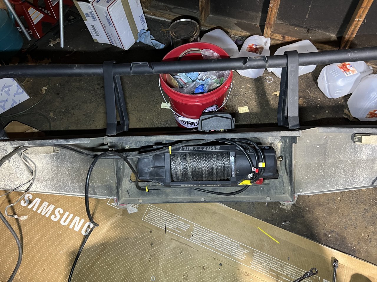

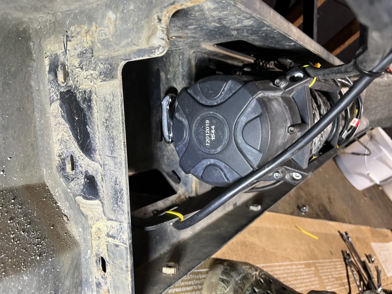

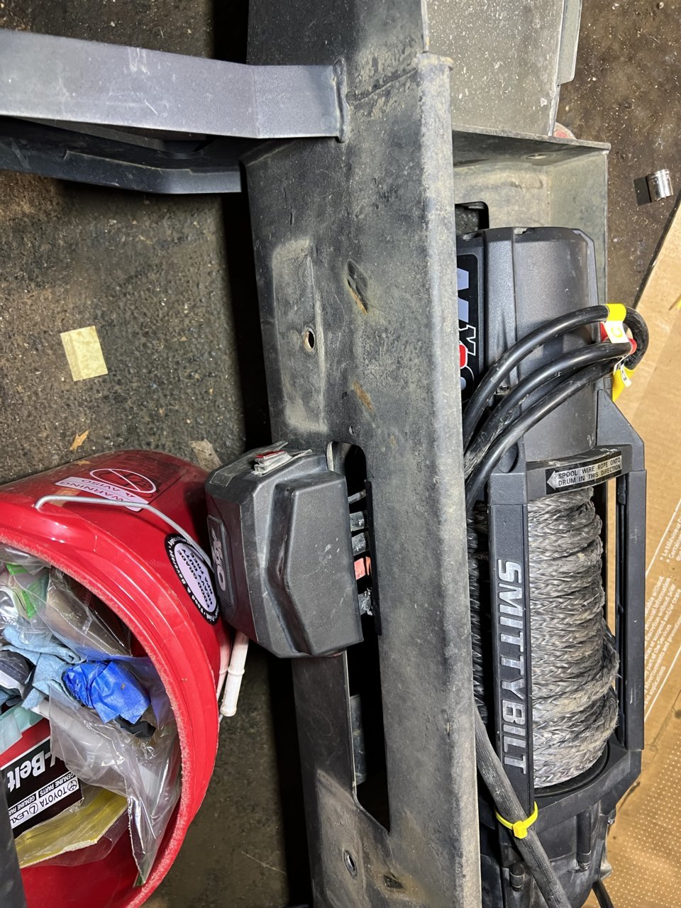

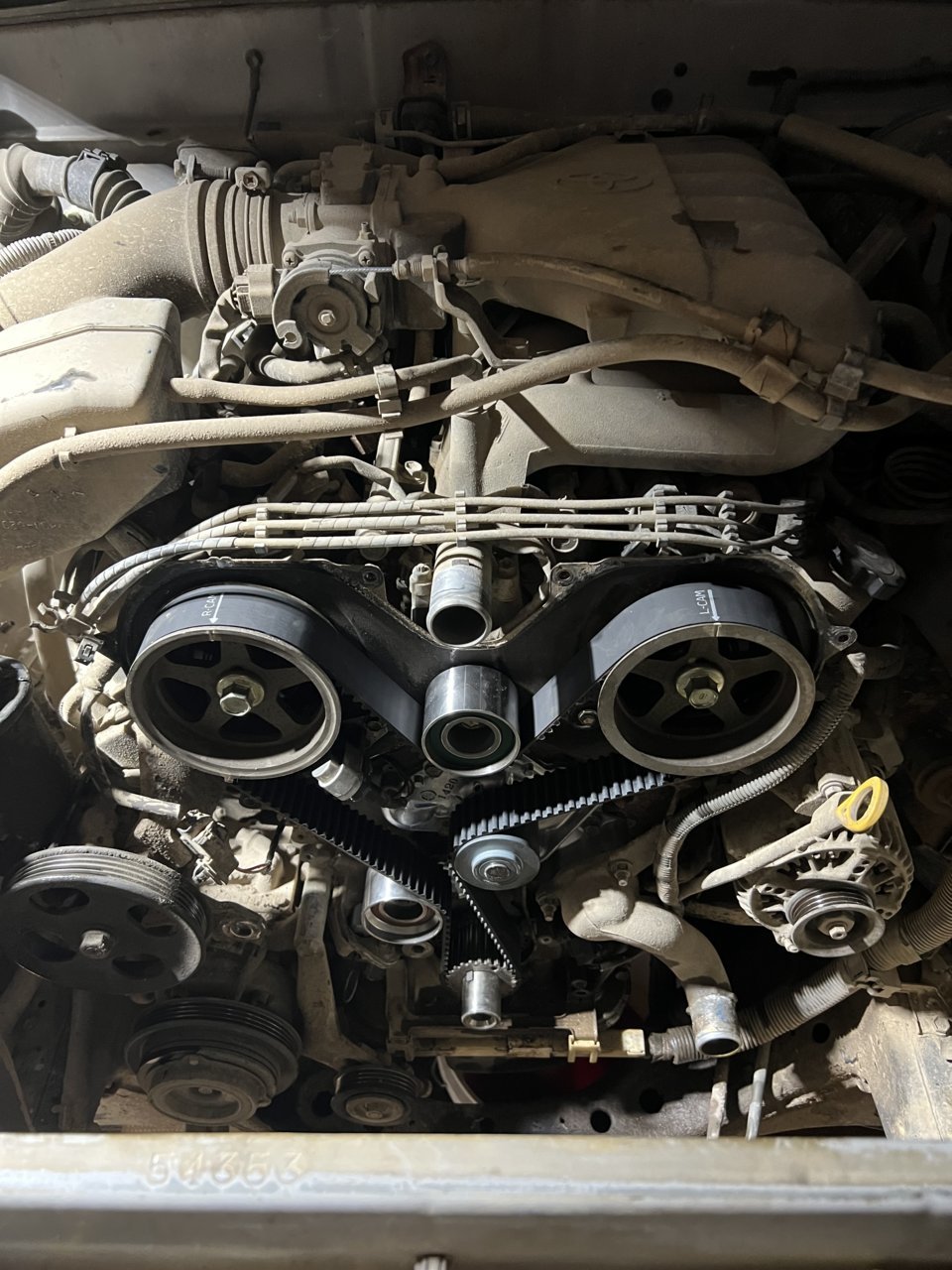

    Timing belt done.
    Installed winch in bumper. Smittybuilt X20 10k fits in the first gen ARB but it is tight and there is no great spot for the control box.

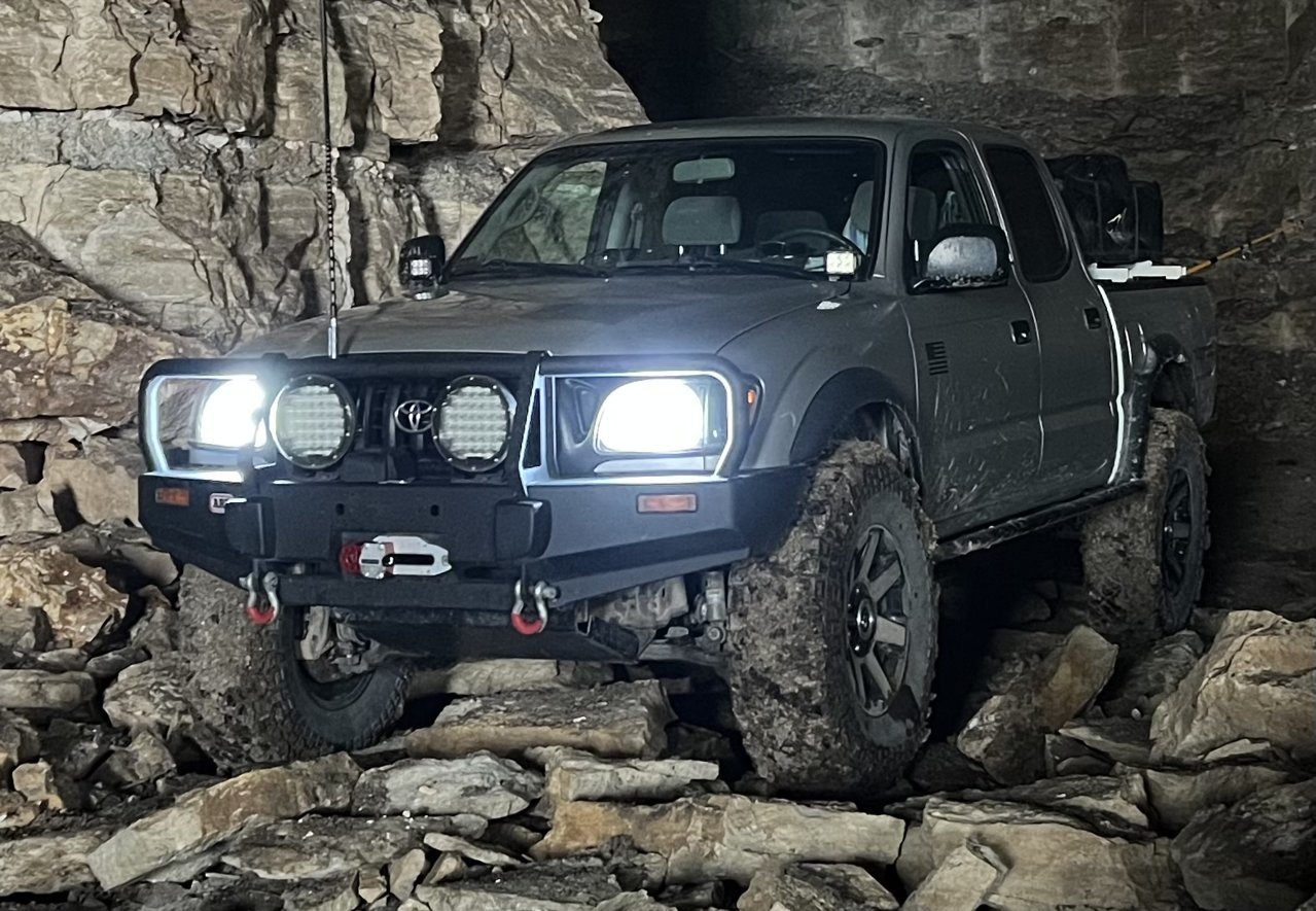

    I guess this must be called Underlanding?

    Where did you end up mounting the control for the winch?
  19. Apr 21, 2022 at 6:20 PM
    #79
    JTFisherman
    Feb 19, 2019
    #283636
    1,630
    Jake
    Texas / Missouri
    4Runner
    It is on top of the bumper between the 9” lights about where the above pictures show it. For me to get to the switch on the control box had to hammer the shit out of the light bracket. Mounted in place with a cut up listened plate off center because the wires are very short.
    You can kinda see it here on top of the bumper

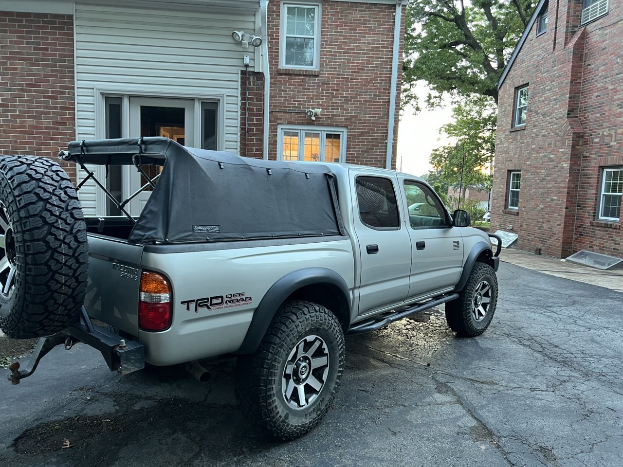

    Got a matching spare and a cheap old used softopper that needed work to change up the look.
