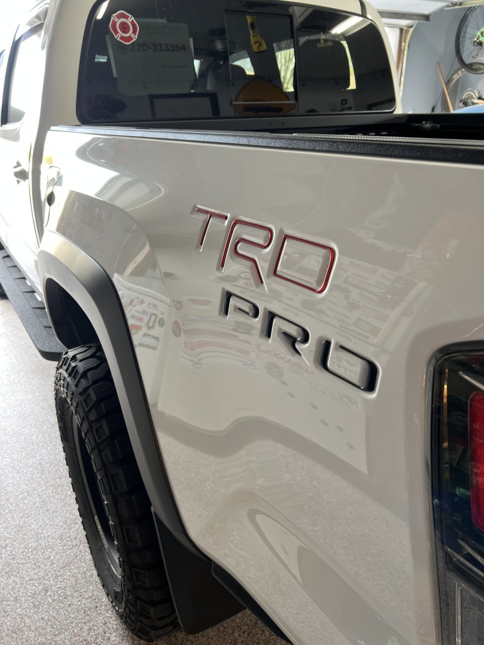

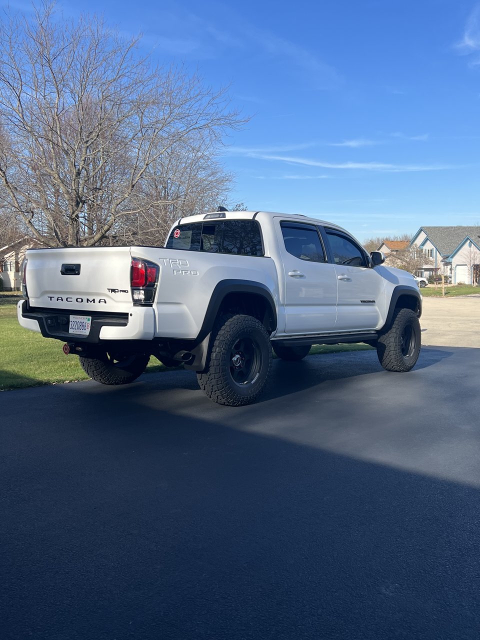

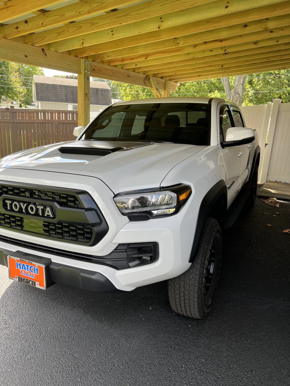

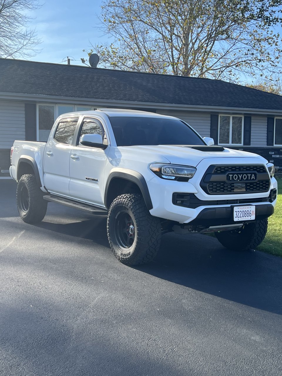

    I recently sold my well built 2014 Tacoma Baja edt. 6 spd. I wanted a newer truck with newer amenities and soon realized because of the truck prices buying new is the way to go. Finding one would be a task in itself as I decided I wanted a Pro and definitely wanted another 6 speed. I located 3 white 6 speed Pro’s throughout the country. 2 were spoken for so it left me with the one I bought being my only option.

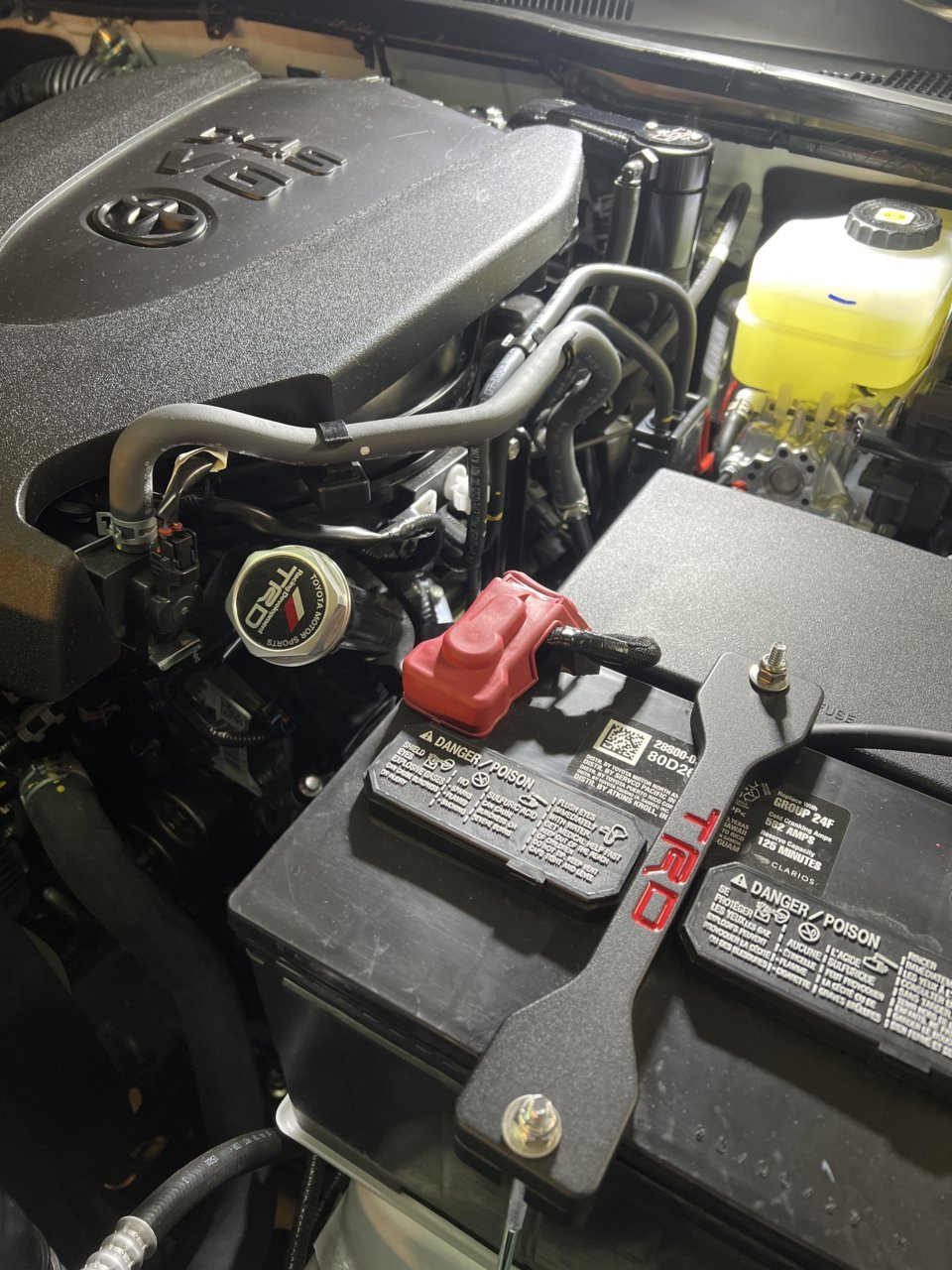

    I located my truck in New Mexico. The transaction went smooth. I got them to toss in a TRD CAI and I paid only $250 out of the $1500 for the shipping. I also have seen a bunch of horror stories of people ordering their vehicles and waiting a fairly long time. After I put my deposit down, they told me the truck would be at the dealer in 2 weeks. True to their word, it was and then sent to me. Another great thing is that all the manufacturers add ons done were things I’d absolutely want. Tailgate lock incorporated with the key fob, bed lighting, running boards, console safe etc.
    2022 Tacoma TRD Pro
    AFAF1B8A-E570-41F2-8DCD-7CC6F5457A7A.jpg E9E6785E-5972-48F3-B7C1-C94A3E31A370.jpg 5FAA3EFF-DA6E-4846-BBF4-BAA995BA4EB9.jpg
    SUSPENSION -
    - TRD Pro Fox suspension with the Wescott Designs 1 &1/2”added to the front 3” total lift.
    - TRD red billet UCA’s.
    - Icon Progressive AAL.
    PERFORMANCE -
    - Evolution 5.29 gears.
    - TRD CAI.
    - TRD exhaust.
    - Hurst Core short shifter.
    - Wilwood big brake kit.
    - J&L oil separator.
    WHEELS/TIRES -
    - Volks TE37 XT, matte black.
    - Rays dura lugs, red.
    - Kenda Klevers RT 285/70/17.
    Extras -
    - Toyota aluminum running boards.
    - TRD aluminum oil cap (imported from Japan).
    - TRD radiator cap.
    - TRD aluminum battery hold down, black (made by Coupe).
    - Front widows tinted to match the rears, windshield tinted to 35% (awesome upgrade).
    - Truxedo roll up tonneua cover.
    - VLED reverse lights.
    - VLED license plate lights.
    - VLED LP-X park brake reverse light system.
    - Cali Raised led Raptor style tail lights.
    - Tacoma lifestyle 3rd brake light.
    Interior -
    - Tuffskins and Meso interior accents as well as Tuffskins TRD stamped bedsides.
    - VLED front and rear footwell lighting.
    - VLED full interior lighting kit.
    - Weathertech front mats.
    FUTURE PLANS -
    - ECU retune OTT
    - Possible exhaust swap to AEW true duel exhaust
    - Possible running board swap to Go Rhino rb20 slim boards
    - mayyyybe forced induction….
    More to come

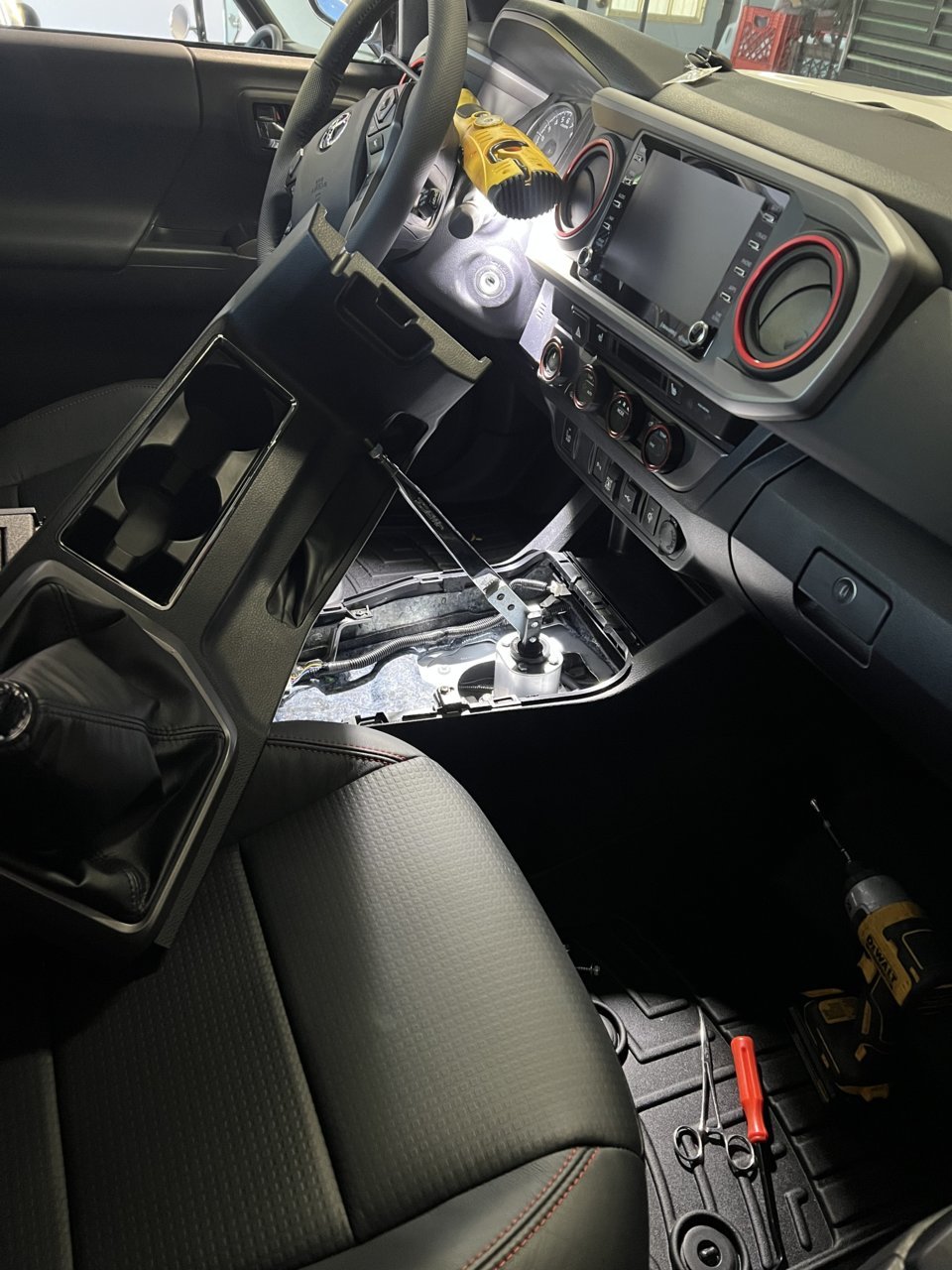

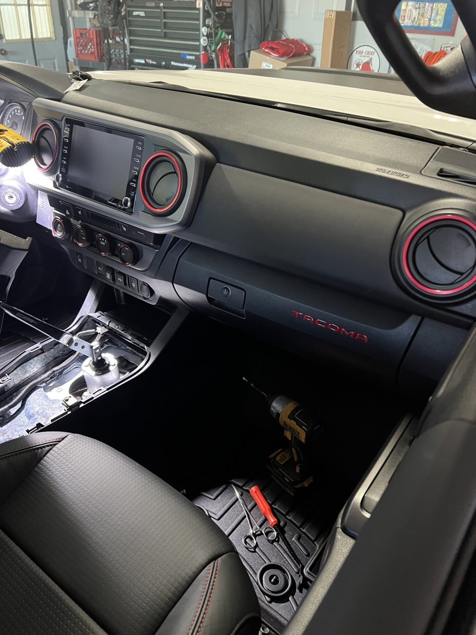

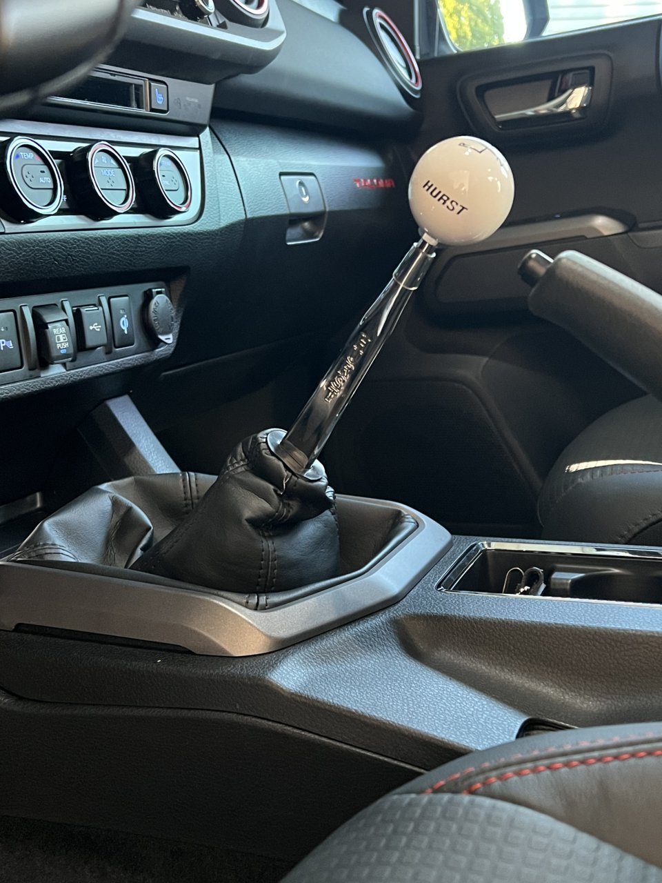

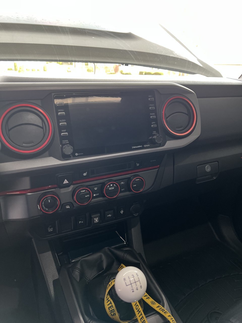

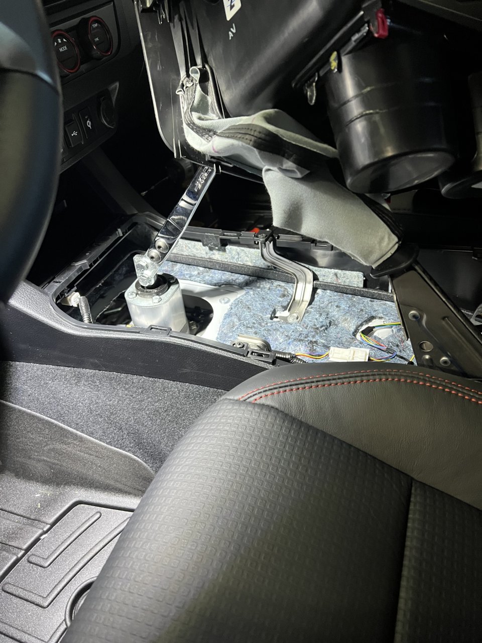

    During my short shifter swap. It went pretty easy and was straight forward.
    DF7B62D5-B051-4557-AE0F-ED575C075215.jpg DB99150A-E68E-44EA-B9FC-49D5A0478CEB.jpg 6F7E8CA5-6CB6-4E35-9D83-373D4B6A450F.jpg A17B1333-5D94-4F1D-9F53-4AD4E9489A8F.jpg

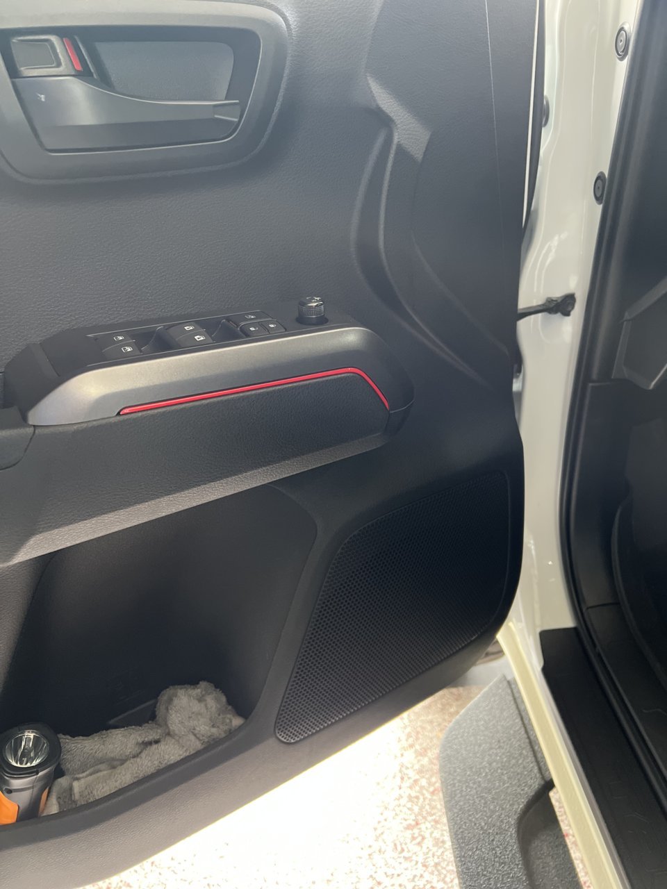

    More tuffskins

    Real nice build so far. How ya liking the 33's and 5.29s? I'm going 31.5 and 5.29 soon. I expect it to be a bit zippy.

    I never drove the truck with the 5.29’s and the stock wheels (31’s) I’d imagine it would be a bit too much for that small of a tire but it will work. This gearing with the 285’s is absolutely awesome. I was worried it may have been too much. I initially found in my research that 5.29 is the way to go for an auto and 4.56 is what to get for a manual. I found a couple videos of guys doing the 5.29 with a manual and was convinced to go that route…..glad I did. Now I can’t wait for my tune.

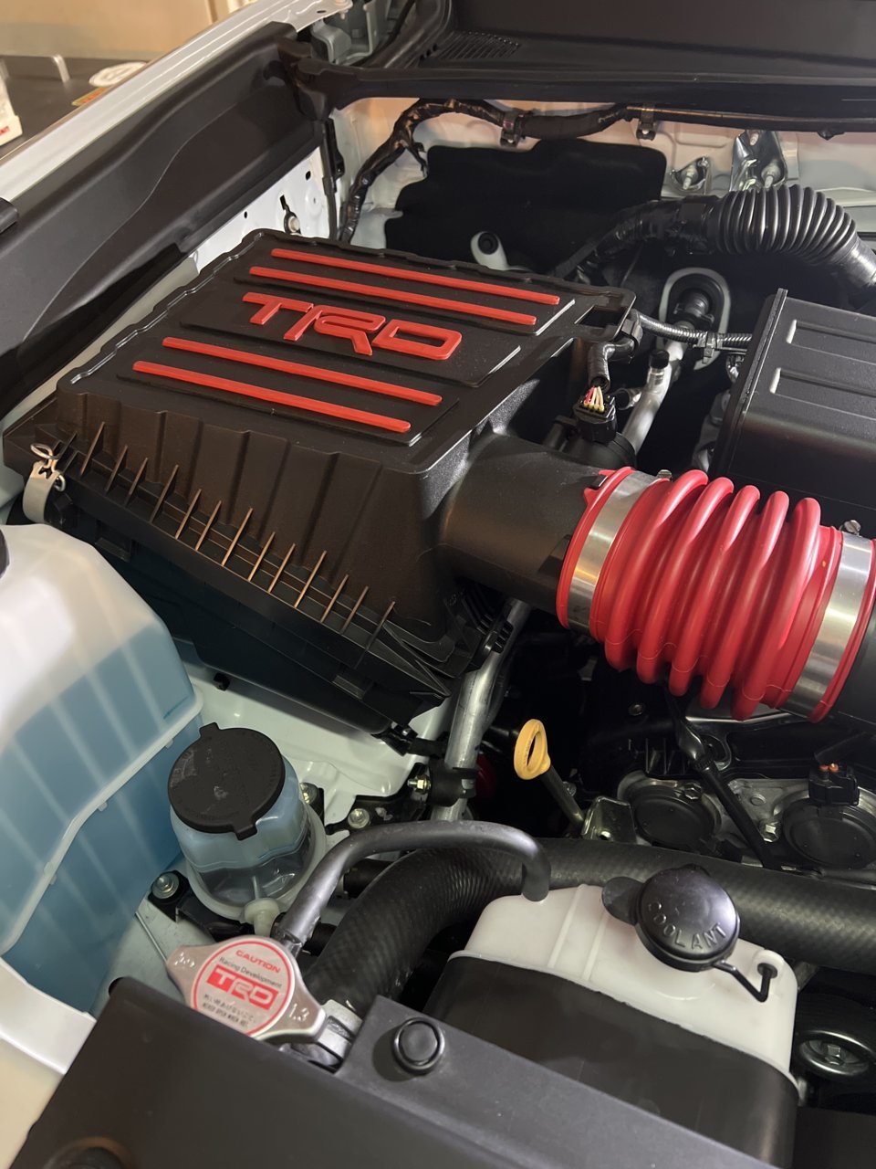

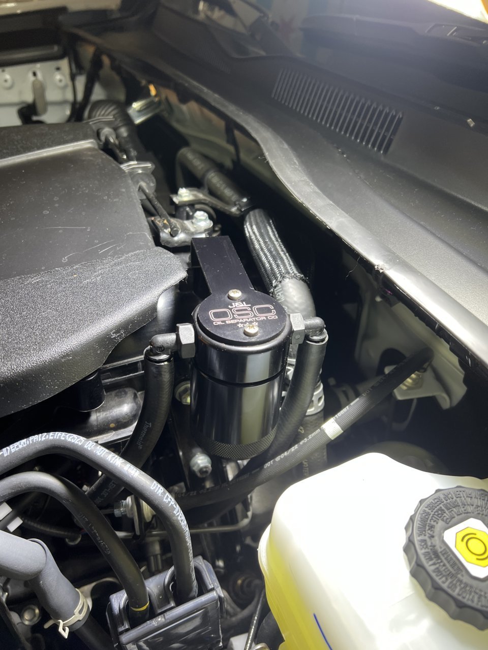

    So far under the hood…..

    That Hurst core shifter looks awesome! How are you liking it?

    @RDT415 i forgot to add about the Hurst core shifter. On my 2nd gen I had a TRD short shifter and switched to the core shifter. Honestly just to try something different. Im glad I did it because it’s a very solid unit.

    Right on, looks like an absolute tank of a short shifter set up, especially with Hurst’s reputation. Don’t mind the long throws, but all of my MTs in the past always felt better after a SS kit.

    Absolutely. Having a short shifter on the 2nd and 3rd gens is a must. So much better!!

    nice build so far! what is the wheel offset and did you have to trim at all? I have a 2023 pro and plan on the westcott lift. Trying to figure out what wheel offset would be best with 285/70r17 or 285/75r16

    Thanks! In my opinion, the offset and bs I have is a perfect setup giving just the right amount of poke. I’ve had the same set up on the 4 SCS wheels sets I’ve had and now these Volks. No trimming on my third gen, I did have to do very slight trimming on the front wheel well plastic on my 2nd gen. I did do a CMC on both trucks but did not need to.
    17x8.5 4.30 bs / -10 offset.
