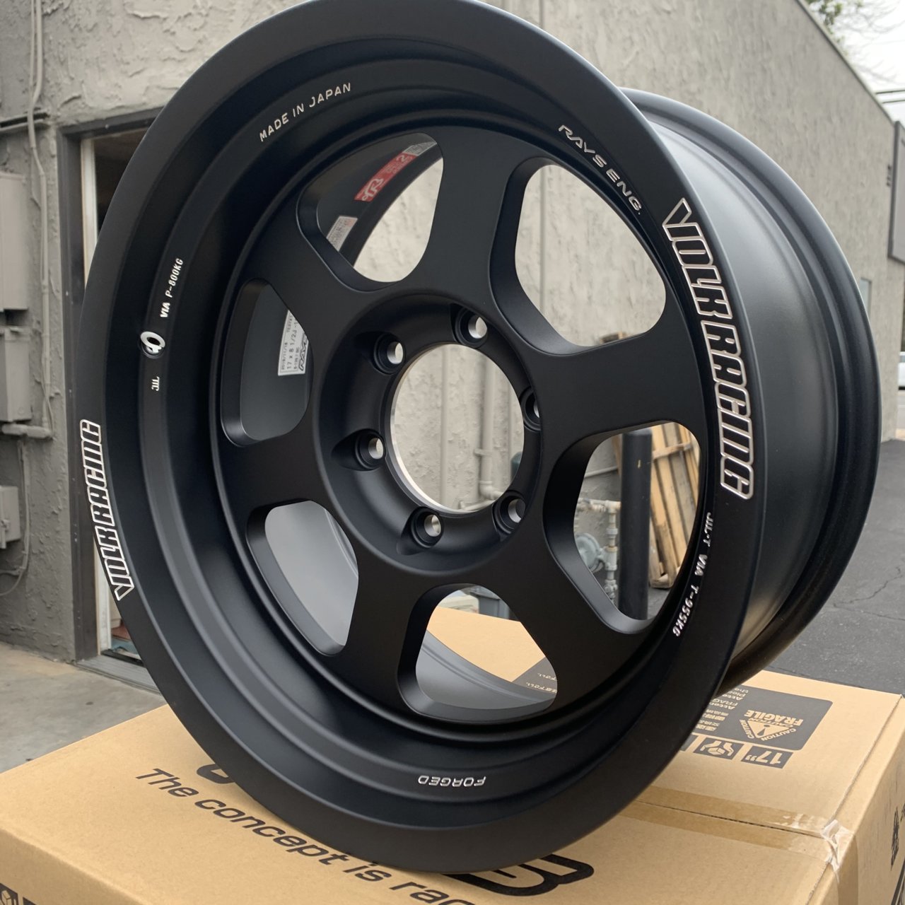

    Buyer wanted my red Rays lugs so I just bought another set. Was gonna go orange but stuck with red. Wheels are blast black (matte black)

    That's awesome! I ordered matte black te37 for mine but they haven't showed up yet. Will you be sticking with 33's or going 35's?

    This pic is from showstoppers. They arrive from Japan on 3/16. Yeah I’m sticking with 285’s. Eventually I’m regearing to 4.30 as well. I got my gears, I’m just waiting for my mechanic to free up

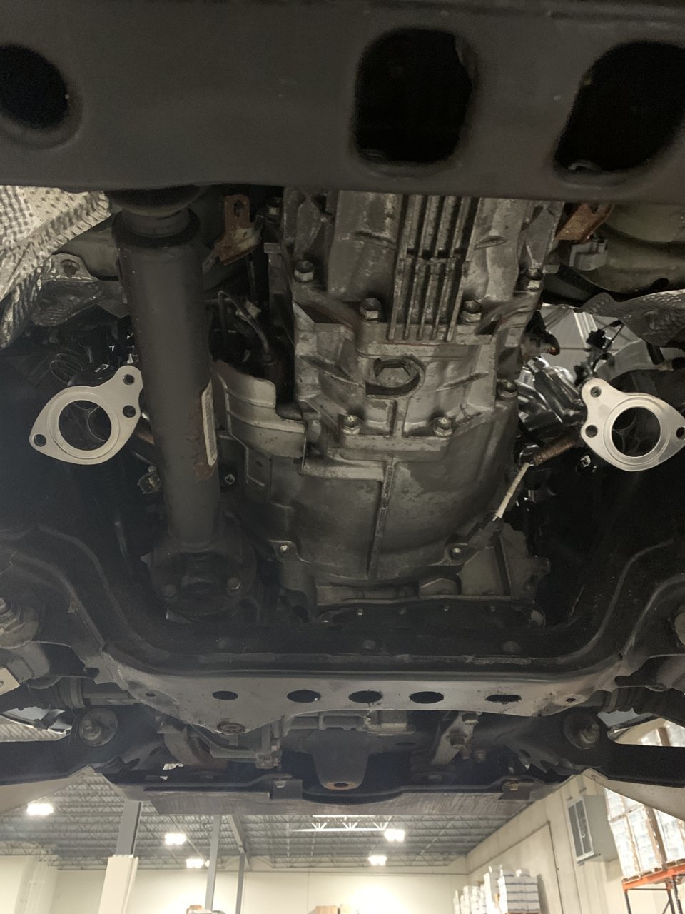

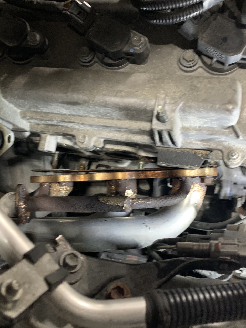

    Out with the old......

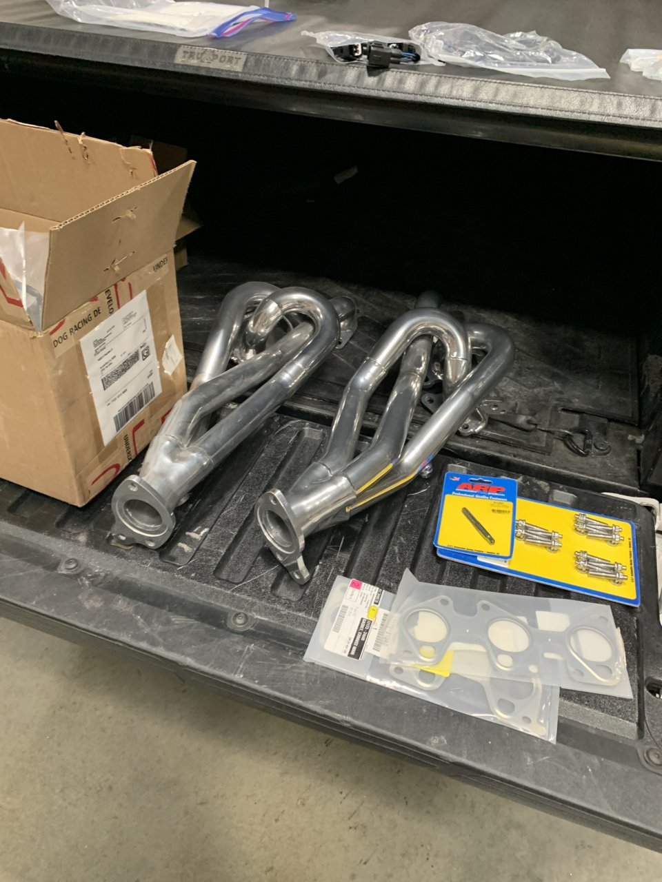

    Headers in , now the intake.

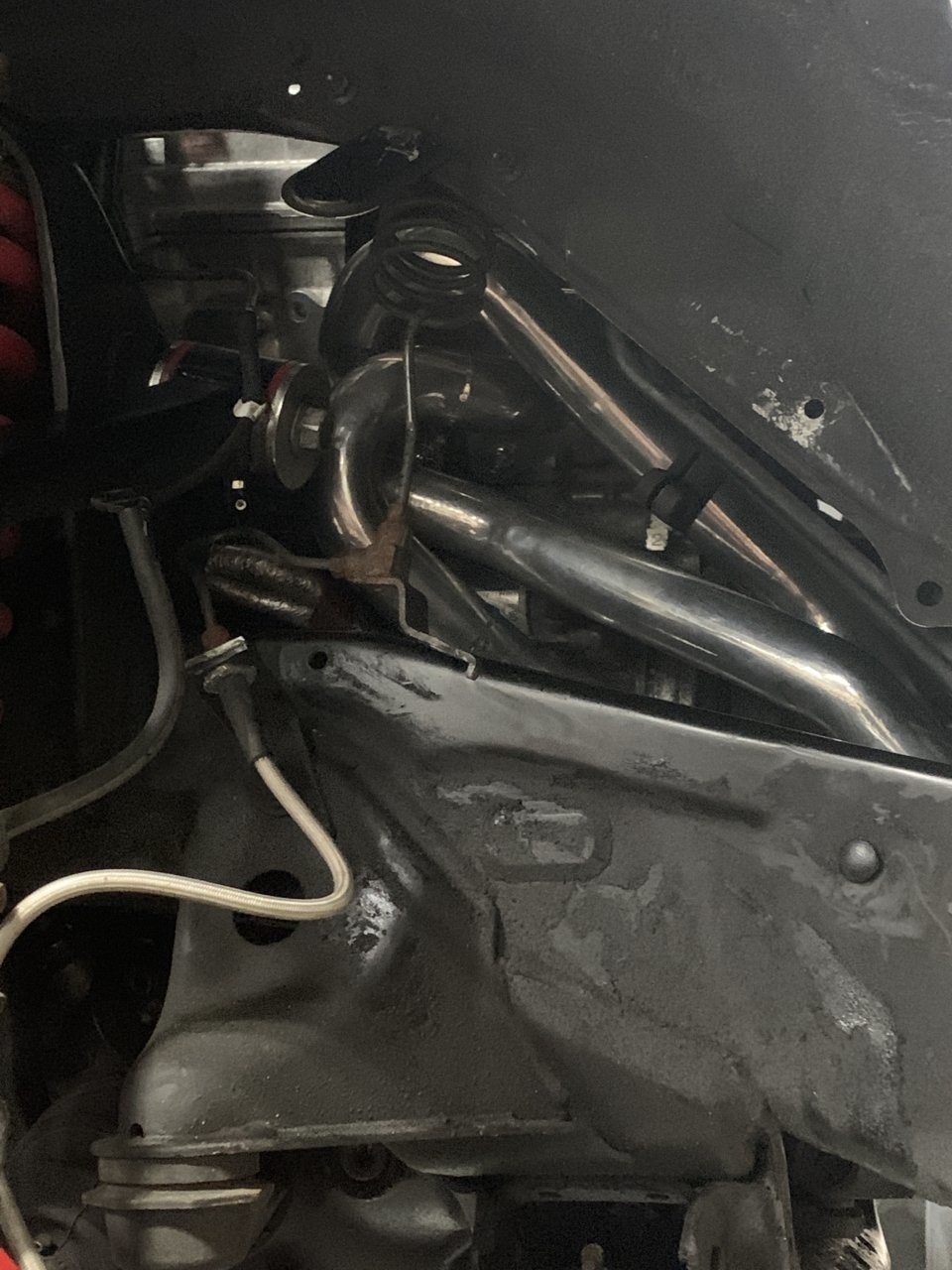

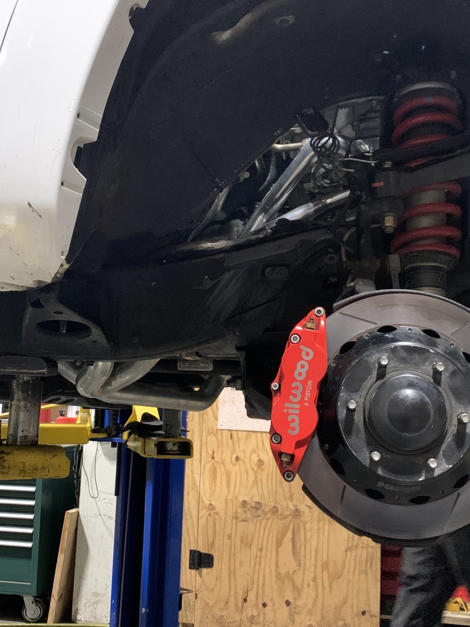

    Well it is all in, the URD headers and URD tcai. The tcai fitment was absolute dogshit!. First off the instructions are out dated, no buggy but the principle. The hole to be cut had to be adjusted to shave more off. The “L” tube coming from the throttle body and turns toward the firewall had to be cut by about 2&1/2” to 3” and lastly, the bracket holding on the other pipe leading to the filter had to be modified with spacers to push it away from the radiator support. I get things may need to be tweaked, but that was a little insane.
