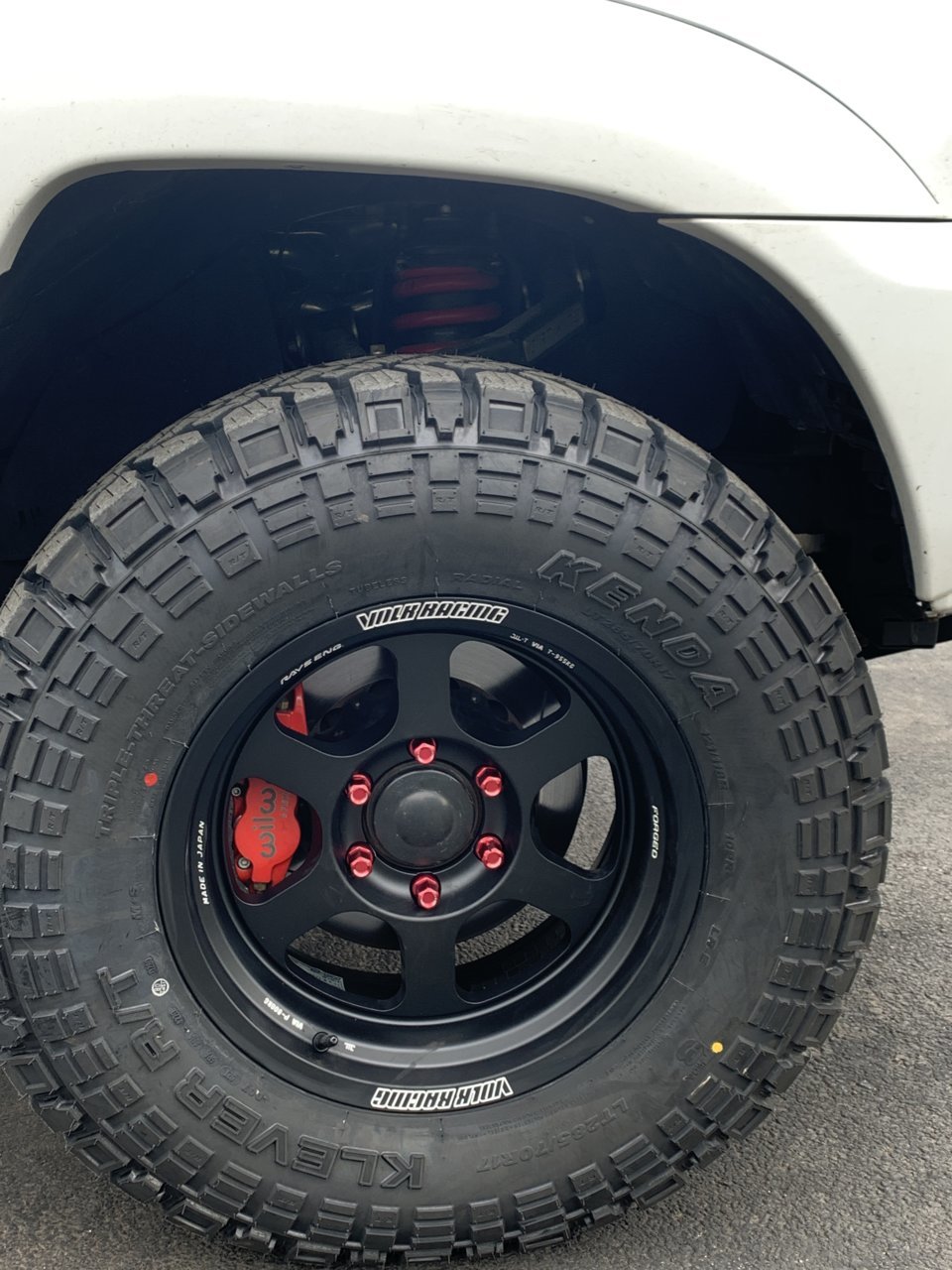

    Today is the day.......new wheel swap. Out with the Advans in with the Volks. Pics to come later

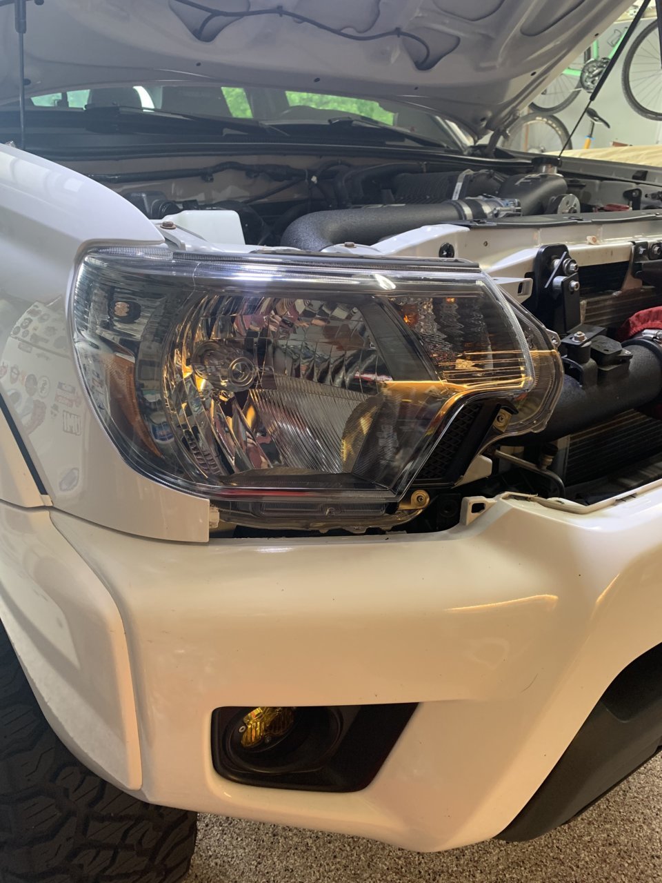

    Just added these yesterday. 2nd gen TRD Pro headlights. Man, whata difference!!!! Awesome upgrade. Pro is on the passenger side for comparison.

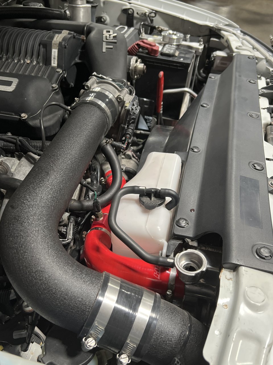

    Finally getting my HPS silicone hoses on today. I’m also switching from a 2.7 to a 2.8 quick change pulley. image.jpg

    That red looks great in there, against the backdrop of black.

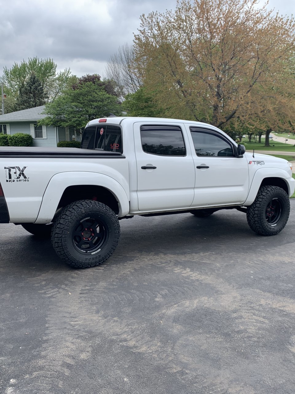

    Thanks for all that info! Yeah I last had an '06 I bought cheap and fixed up a bunch. Then when we went remote for work I was never driving it. So I sold and just drove our 4th gen 4unner. I finally decided to get another Tacoma and found a 2013 TX, Baja, Pro, whatever they call it, with the 4.0 of course and a 6spd. It has a few mods done to it already including 6112/5160 shocks, short shifter, and FN wheels. I'll attach a pic below. I'd like to get some 285's for it and was debating between 16's or 17's for wheels. The wheels it has now sit a little to flush IMO so I've looked into some different 17x8.5" wheels with the -10 offset. I just read that you ended up doing a CMC. Were you rubbing the body mount some or was that just to be sure to have enough clearance?
    Here's a pic of mine. The 6112's are on the 4th clip with 650lb springs. I think its about 2-2.5" of lift with the bumper weight.
