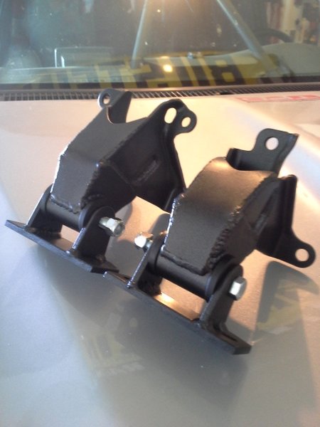

    Bonzen Solid Offroad motor & transmission mounts
    Nov 24, 2014
    #142997
    589
    Lake Havasu City
    The Silver Bullet
    Everything.
    Juan's new solid motor mounts to replace his grenaded stockers!

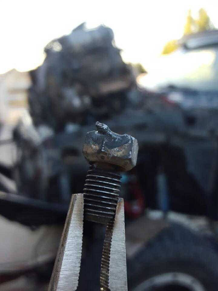

    just kidding but in all seriousness ive been slacking putting in work on her, when i broke my motor mounts i snapped a bolt off in my block and there is absoultly no way to get any sort of aid in there to get it out without pulling the motor. so i get the pleasure of pulling my motor and missing glamis for halloween

    When his old set of mounts broke, they were slapping around and that force of the bracket colliding against the block and then rebounding over and over again caused the upper driver's side bolt to shear clean off inside it's threaded block hole. Just another PITA issue caused by running with stock mounts or a "band aid" fix that some companies offer.
    I suggested trying to get an easy out in there but I'll believe him if he says it's impossible. The space is tight and cramped for sure as is.
    Juan, we have pulled a 3.4 and installed a new on in one day...I do think if you get a competent friend to help and an engine hoist you can do it. The trans can be removed in around 2 hours, I have done it about a dozen times haha. Don't give up hope, I really think you can make it happen!

    we can get that bitch out Juan! :thumbsup:
    you still have my extractors right?

    Well after 2 and a half months finally got the bitch out!
    Now to get it back together and get to glamis next weekend!!!
