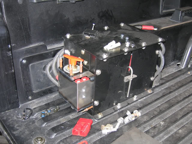

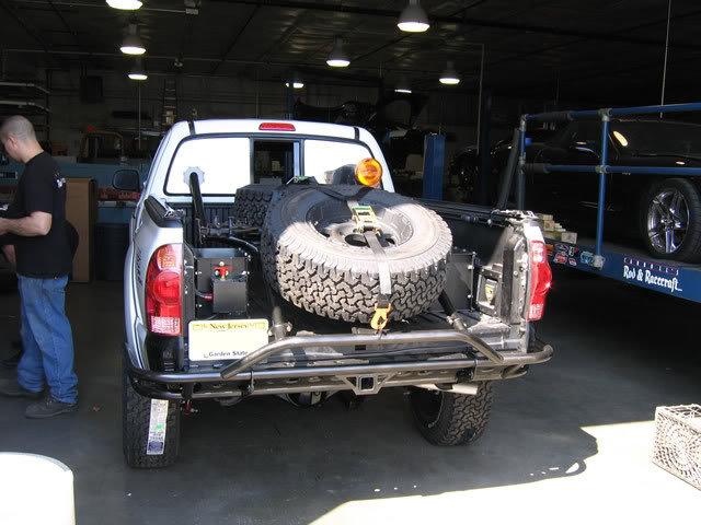

    Scaffolding and a painted grill
    It's a very useful thing to have. I put one on my truck when the batteries were relocated and the kill switch was installed.
    The link to the Warn products above is what you want. Those plugs and wires will have the capacity needed to jump a truck and/or winch through. Last thing you want is wiring that's not up to the task.
    1/0 wire ties the batteries together and to the switch, plug, and electrical system on my truck. Since copper itself is the expensive part, I coughed up the extra little bit and got the coating designed for welders. I figure if it'll hold up to slag falling on it, it'll hold up to my use.

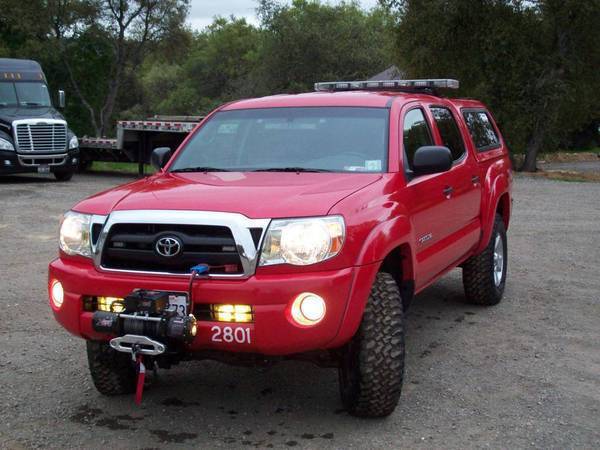

    I have that on my 07 fount & rear. I use it for my winch & jumper cables. I use plugs from Napa Auto parts. https://www.napaonline.com/Catalog/CatalogItemDetail.aspx?R=NW_740235_0293961159 Plug part #740235 & plug cap part #740242 [​IMG] [​IMG]:D

  18. Mar 20, 2011 at 10:26 AM
    #18
    MrFastLayne
    MrFastLayne Mr SGA
    Dec 5, 2010
    #47182
    390
    Layne
    Lincoln Ca,
    07 Tacoma 4x4 SR5 V6 Off Road
    Lift,Winch,Shell,Light Bar,Siren,Radio's
