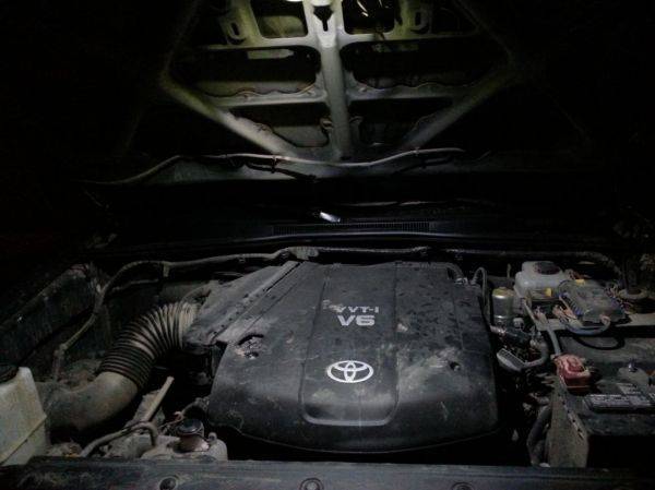

    New light made to go under the hood. Lights up 98% under the hood.
    What does everyone think?

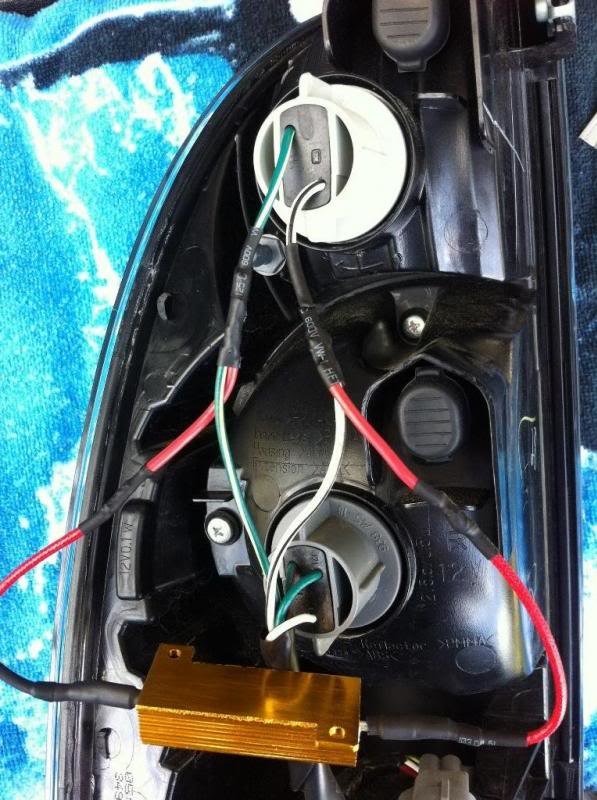

    Ok all, better late than never. Here are a few of what I feel are the more critical pictures from my install to give you an idea of the major wiring changes required on the 2013 DTRL & Rear Turn LED mods plus a few other pics I feel will help with your installation. Everything else I installed was extremely straight forward, plug and play. I will be posting most of the output comparisons in my build thread a little later on for those of you who are wondering what the improvements are like over stock lighting, which I will say is substantial. Worth every penny... Thanks Chris!
    Most importantly, if the LED doesn't work on first try, rotate the bulb 180 degrees as they are polar (one side +, one side -). Best to do this before re-assembly as it is very time consuming otherwise!

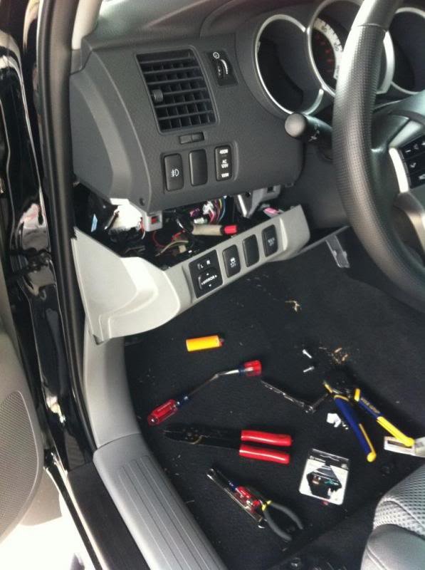

    Under-dash wiring required for DTRL:
    Dash panel that needs to be removed (snaps out easily once two 10mm bolts are removed per instructions, then just disconnect the switches/hood release cable and remove for easiest installation)

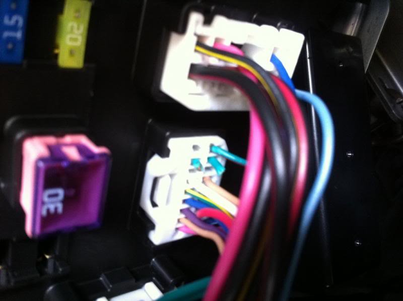

    Add-a-circuit installation for always on with ignition DTRL's (Required)
    Shot of the two green wires that need to be tied together, then crimped to the add a circuit

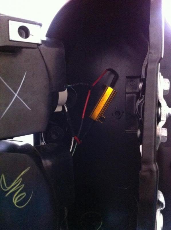

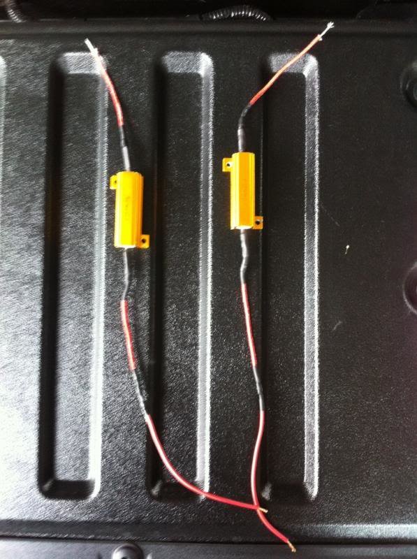

    Wiring for resistor installation:
    I opted to solder and heat shrink all connections, however the T-crimps included in Chris' kit are more than adequate to perform the installation for those without a solder kit. This is a picture of the resistor installed for the LR Turn however installation is the same for both rear turns and front DTRL/Turns.
    Resistor Mount location for Rear Turns:
    If you're planning to solder, I highly recommend extending at least one side of the resistor wiring for ease of installation:

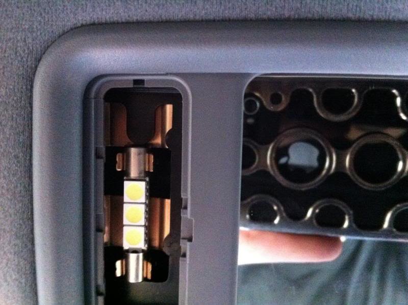

    All other panels/dome light covers/map light cover were easily removed with a small sized flat head screwdriver wrapped in electrical tape as to avoid marring the surrounding plastic. If anyone has any other installation questions or would like me to take a few more pictures of certain things please let me know. Hope everyone likes the writeup and please feel free to contribute or correct where needed!

    Thats the beauty if this led. You can use it on any vehicle. It comes with a positive and negative wire attached, and a hood pin switch so that it turns off when hood is closed. Hook positive to battery and negative to hood switch.
