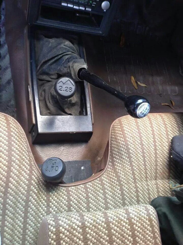

    One stick is for low/high range and the other is to switch between 2wd and 4wd

    Thats for twin stick, right? Front stick is for normal high low and the rear4.7 stick would be the crawl box, right? uba6y3uj_4be04e9416f146a7fea64b0fa79aec43b2813f55.jpg

    Yeah that's for a twin stick and I haven't used one but that's what I would assume

    I'm just guessing, but I'd say the back one works just like a normal t-case. The front one is for when you want to crawl in ultra-low range.

    Is the ratio on the sticks?

    I'd look under the truck. Just cause the sticks are like that doesn't mean that the tcases are in that order

    It'd be a reasonable assumption that the 4WD t-case is in the back. Otherwise, when you shifted the rear case to low range, you'd only be shifting the rear end to low range while the front end stays at a higher ratio. That said, it's not so much a worry with Toy cases that have the shifter going directly into the t-case, but other t-cases with cable or linkage operated shifters (NP205, Atlas--I think--for example) you could end up with the forward shifter actuating the rear case (although I don't know why someone would do it that way).

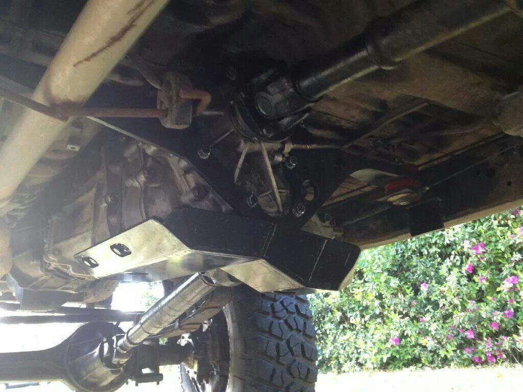

    Hard to see but looks like the crawl box up front and tcase in the rear. The case should be the 2.28 and the box should be 4.70. Being that 2.28 is the normal ratio in the case and people normally buy 4.7 gears to regear there tcase if they dont have a double set up. asysytyp_d056d399cfa49b6108a8785545f343f5d0c73f26.jpg
