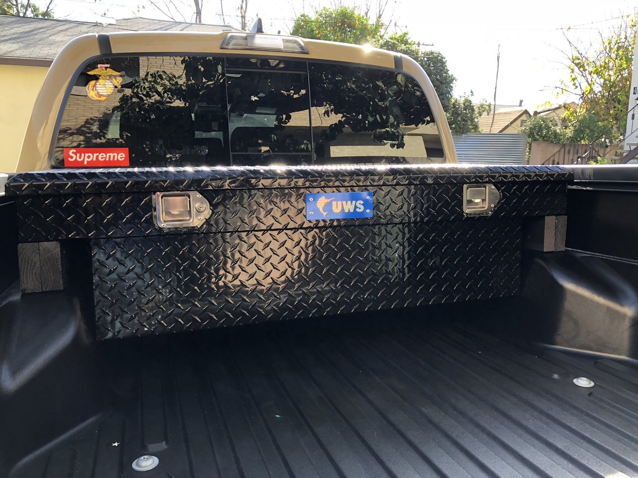

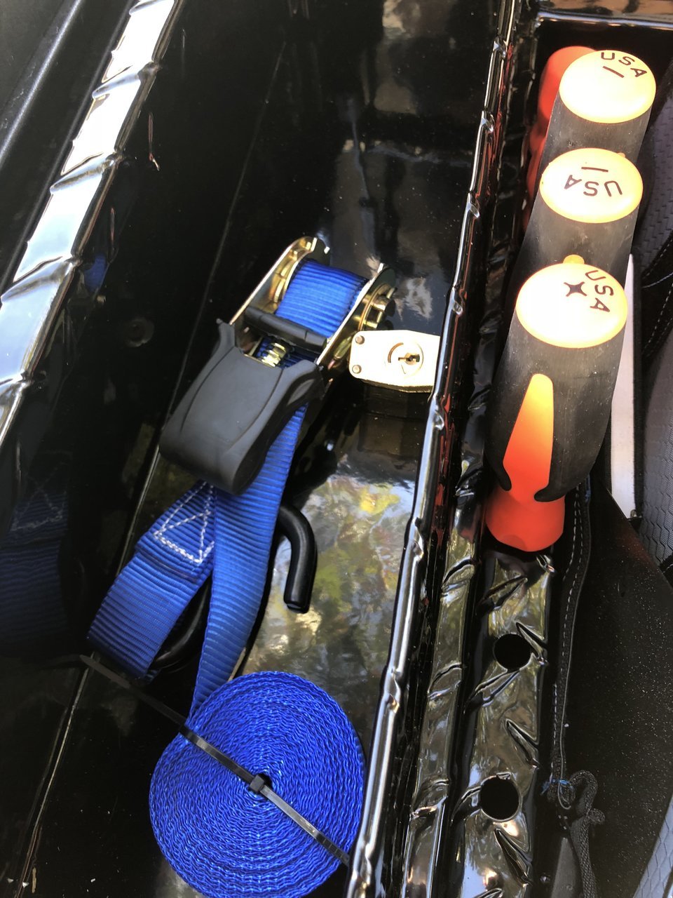

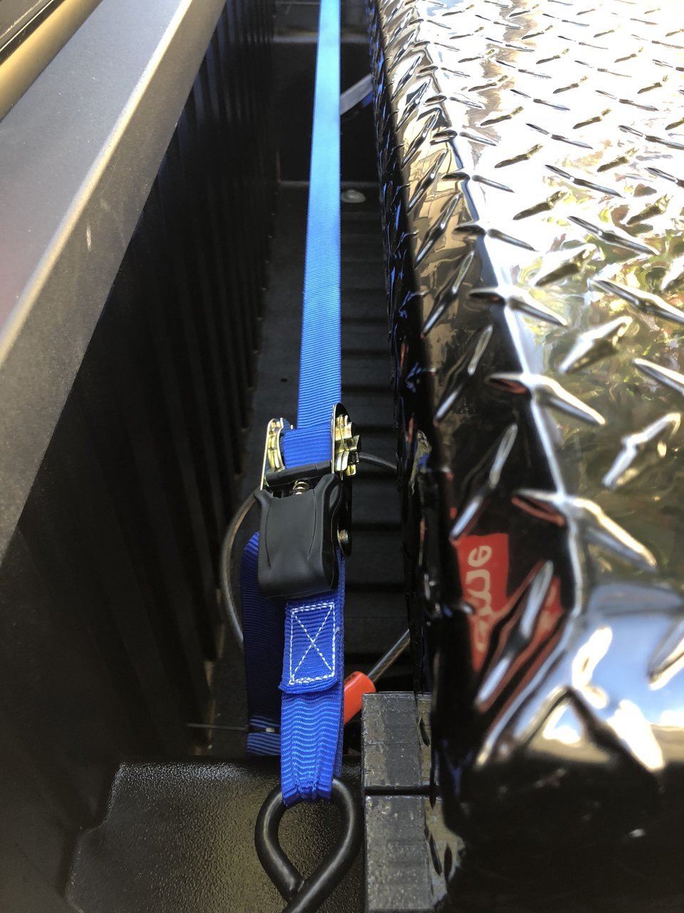

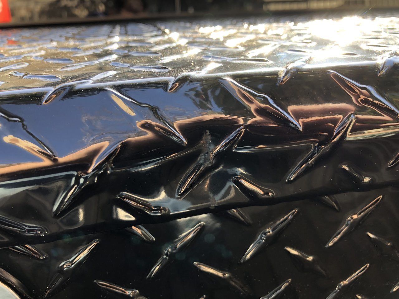

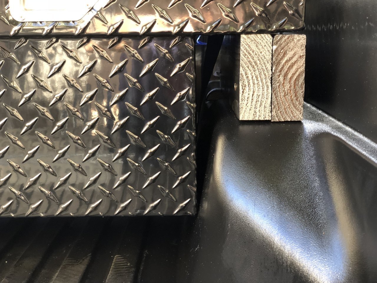

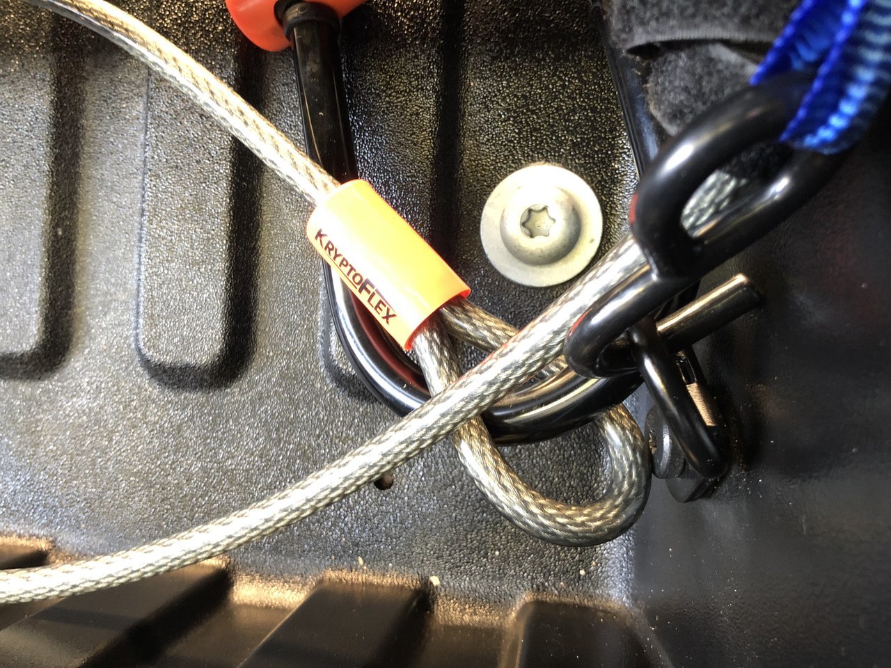

    So I finally got it installed and this tool box does not fit the 3rd gen Tacoma, at least it didn't fit my 2018 OR DCSB. It's about 1.5 at 44 inches and the wheel wells in the DCSB is about 42.5 from what I measured. It ends up sitting about 4.5 inches above the bed floor. I ended up using 4 inch blocks of wood to have it sit on that goes on top of the wheel wells. I would have returned it but I got such a good deal on it off of Amazon warehouse deals because of a dent on the lid which is hardly noticeable that I was determined to make it work since it was so cheap to begin with. To secure it, I ended up using 3 ratchet straps, one in the back (you can see it in the picture, the wood is bolted secured to the box and it rests up against the hooks of the strap) to prevent it from moving forward from braking and then used ratchet straps through the mounting holes on each side of the box from the inside that hooks onto the D-loops attached to the bed to prevent it from moving towards the rear of the truck from accelerating. It's pretty much rock solid with just those ratchet straps. As for the locks, I ended up using a kryptonite bike cable I had laying around, a kryptonite U lock, and a padlock. I'm not too worried about it getting stolen since my neighborhood is pretty nice and there's nothing valuable in there (extra clothes, diapers, a little bit of basic tools, straps, and other small things that I can't store inside the cab). Hope this helps anyone who ended up getting it or can get it for a cheap price.

    Pictured in tacoma_supreme’s post it looks like the box doesn’t quite fit flush in a double cab short bed due to the wheel wells. The angle that the “bed liner” comes in at where the wheel wells are doesn’t allow the box to slide in nice and snug. The box becomes wedged.
    edit: hence the reason for the wood blocks holding the box up
