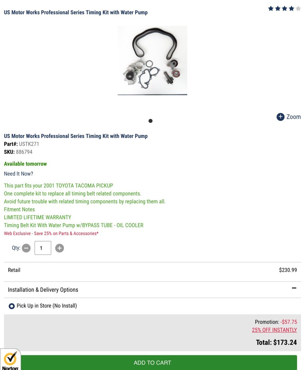

    So we just got this kit today...

    I sure hope you went with Aisin or OEM as folks recommended above.

    2004 Tacoma
    Lots of opinions here..... But just wanted to verify the kit you got shows a new timing belt tensioner, you will not need that belt compressing tool you show a photo in your original post.

    X2, spend the extra money and get Aisin or OEM, ROCKAUTO.COM.
    If you don’t you have a good chance one of the parts will fail
