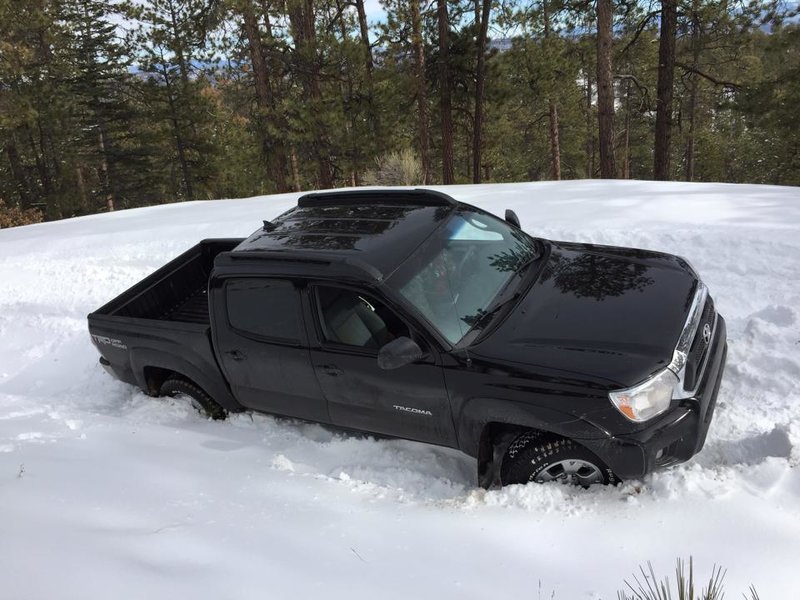

    Hi Everyone,
    While I've had my Tacoma for over a year now, I am new to Tacoma World and have not made any modifications to it. I like to hunt, fish, camp and just be out in the mountains. I bought my Tacoma so that I could lift it and use it for hunting. Of course all my guy friends never let me drive and we always use their vehicles for hunting. (which is a good thing, my truck still looks new!!) This year I want to get it lifted, 3" or so. I just started looking into lift/leveling kits. I also bought bigger wheels, I just need to get tires.
    Sooo.. for a girl who frequently goes to the mountains, hunting maybe twice a year where the terrain might be more rough.. What type of lift should I be looking into?? What kind of tires should I get for my 17" wheels??
    Thanks!
    K

    I hope you had a shovel!

    Welcome! Were you able to drive out of the snow or was your truck stuck?

    In that picture I was only stuck for a few min's. I was able to get out in 4low with the differential lock on.
