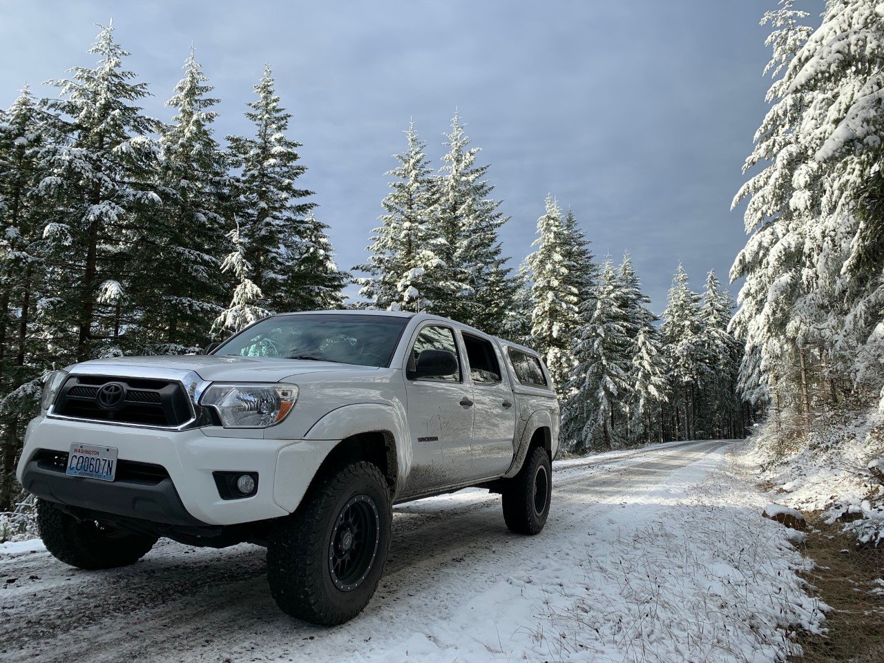

    I was the same way, I have a shell and it sagged so I put in AAL's. Nope, as funny as it sounds with camping gear ect. it still sagged and now my OME Dakar CS047R Leaf packs are awesome,
    Great support on and off road.
    I say leaf packs if you are going to keep your Taco it is worth the investment.Tacocapforest3.jpg
