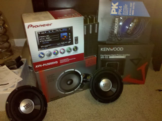

    Pioneer AVH4300 (B Day gift from the wife)
    2 8" JBL GT0804's (Christmas gift from the wife)
    Kenwood XR-5S amp (B Day gift to myself :D)
    Focal 165V30's
    Kicker wiring
    The only things left are the box from Mr.Marv (should be done next week) and sound deadening (still haven't decided which brand).

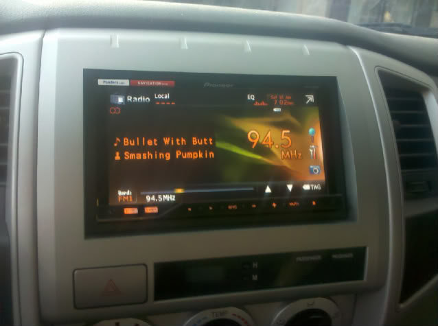

    Phase 1 complete:
    I used the Scosche dash kit, it fits pretty nice.
    The install took a LOT longer than I was anticipating. The clock/hazard button was a PITA to figure out. Here's a tip: There are 2 "posts" with the little yellow clips next to the clock/hazard assembly. Pull outward <- -> on them while pulling the assembly out.
    A tip on the A/C controls: just grab a hold of 2 knobs and pull. It comes right out.
    I blew an "ACC." fuse for some reason. I had it wired up and was playing around with it then it just shut off. It took me awhile to find the blown fuse because I didn't know there were other fuses, besides the ones labeled "radio", that affected the radio.
    Phase 2 will begin once I settle on my sound deadening and receive my box and speaker adapters from Mr. Marv.
    I believe I'm going to remove all of the interior and line the whole thing with sound deadener.
    Final thoughts on the HU swap: It is definitely a LOT louder now than the factory HU.

    Yes, I forgot to plug the hazard switch/clock back in before I took the pic.^

    wow that looks great! might go that 4300 route...and the scosche fits nice. what harness did you use for h/u, and did you hookup steering wheel controls? where did you get scosche kit?

    I got the dash kit and harness from Amazon. It's the Scoshe harness. They're all the same for the 1987+ Toyotas unless you have the JBL system. If you have a JBL system then you have to have an $80+ harness.
    I don't have the steering wheel controlls hooked up, but I think I will in the future. I found myself trying to turn the volume up and down with them yesterday. It really is convenient to have them.

    Amazon has 2 kits for 2nd gens...looks like yours is one for 2009 install nice setup!
