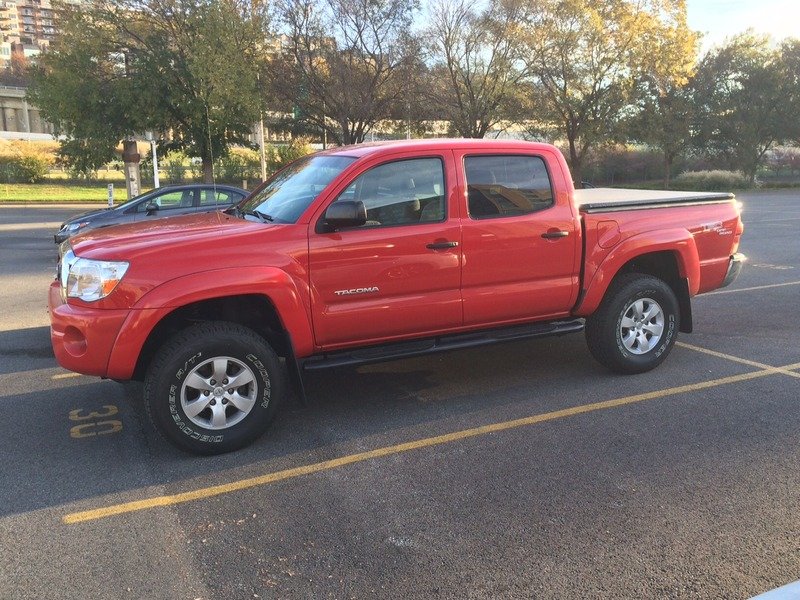

Just added a Rancho Quicklift to my 06 Tacoma - pics posted

    Very nice, how is the aligment? I like the stance.

    I did a straight strut replace and kept the stock control arms. The alignment is all in spec with no issues.

    Looks sharp perfect hight . I like the stance . Did you get any vibration?

    curiosity what size tire you running in that picture?

    No vibration at all. I've only had it up to 70 so far....but nothing.
    Tires are 265/75/16 . I wanted to stay more conservative for gas mileage and better snow/wet traction

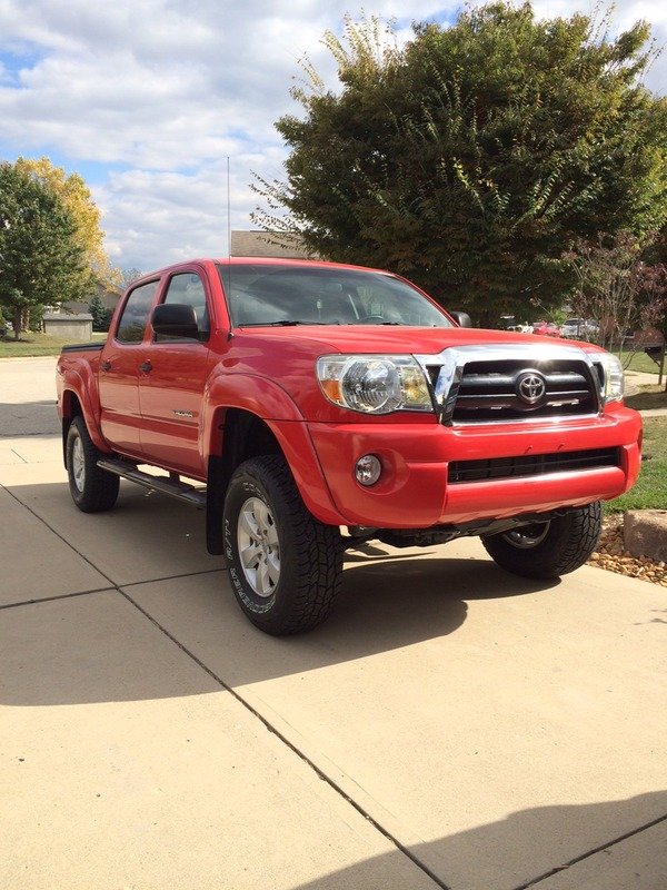

    UPDATE....
    Well my "perfect setup" went south really quick....: (
    With the Rancho Quicklift and 1.5" lift blocks in the rear I was having issues with alignment, vibration and axle wrap. The Quicklift ended up raising the front up 3" and the axle wrap was from not stiffening the rear springs with AALs or a new leaf pack. I think the vibration was coming from the drive shaft angle being all jacked up....
    I removed the Rancho's and lift block and started from scratch......
    I called Dan from Wheelers Offroad and bought a new package and after a lot of consultation we ended up with the below package....
    Front: Bilstein 5100's with OME 883 springs set to the lowest ride height position
    1/4" and 3/8" spacers on the drivers side.... 3/8" spacers on passenger side
    Raised the front 2.5" and sits perfectly level
    Rear: Bilstein 5100 shocks and a 3 leaf Add-a-leaf pack (removed the overload leaf).
    Stiffened up the rear very nice and raised it 1.75"
    The truck sits with about a .5 - 1" rake on it...but visually looks level.
    Ride is immaculate... alignment is perfect.... and most important no axle wrap or vibration!
    Much thanks to the advice from Dan at Wheelers Offroad

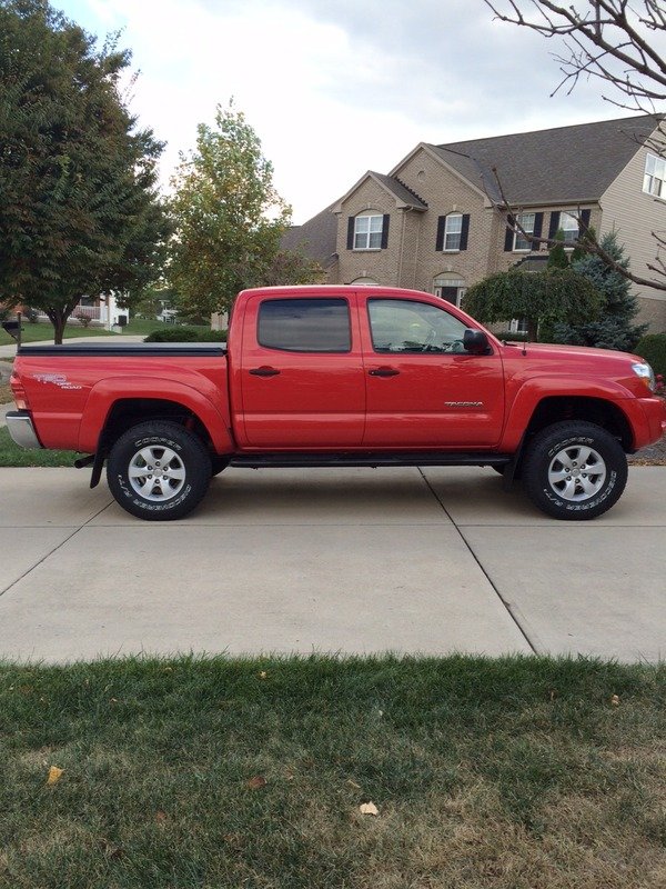

    Most current picture with all the new Bilsteins, OME 883's and AAL on.... for me, it's perfect

    :thumbsup: Looks good . You will like this set up much better. I did the same as you in the front but with out the spacers and left the back stock and I love it .
