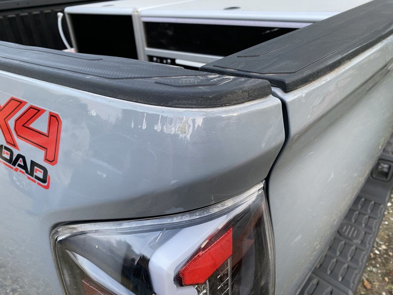

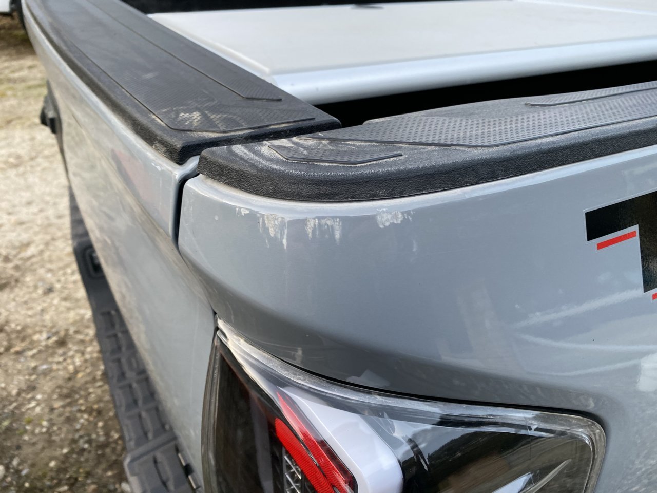

    All canopies/caps will shift around and rub if not periodically torqued down. There should be a gap maintained at all times. Stiffeners or not, if your cap is touching the paint, it is going to rub through, always.

    What am I missing that bed stiffeners would of prevent paint rub? I’m assuming the cap in question had a lip over the rail? If so then I’m also assuming the dealer installed? If so then they used the provided foam tape… which is also junk. It is flat right off the bat then over time compresses further (gets closer to paint) then any side to side movements and this.
    I know that’s a lot of assuming but I did my install with my own foam tape that is not flat. My cap has a lip but the thicker foam actually keeps it raised off the rails giving me more buffer between the paint. Just a thought. Now if you show a picture of a cracked bed then that’s something regarding the stiffeners

    The stiffeners may make a more solid platform so the cap doesn’t shift as readily, or as often. But to answer you question, nothing at all. When the cap shifts, which it will if you don’t check it often enough, it will rub off the paint.
    I have stiffeners and a cap and still need to keep an eye on things.

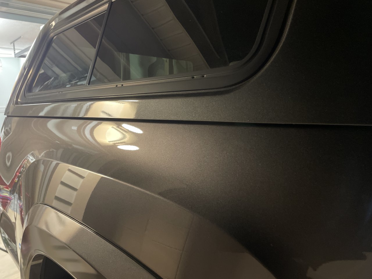

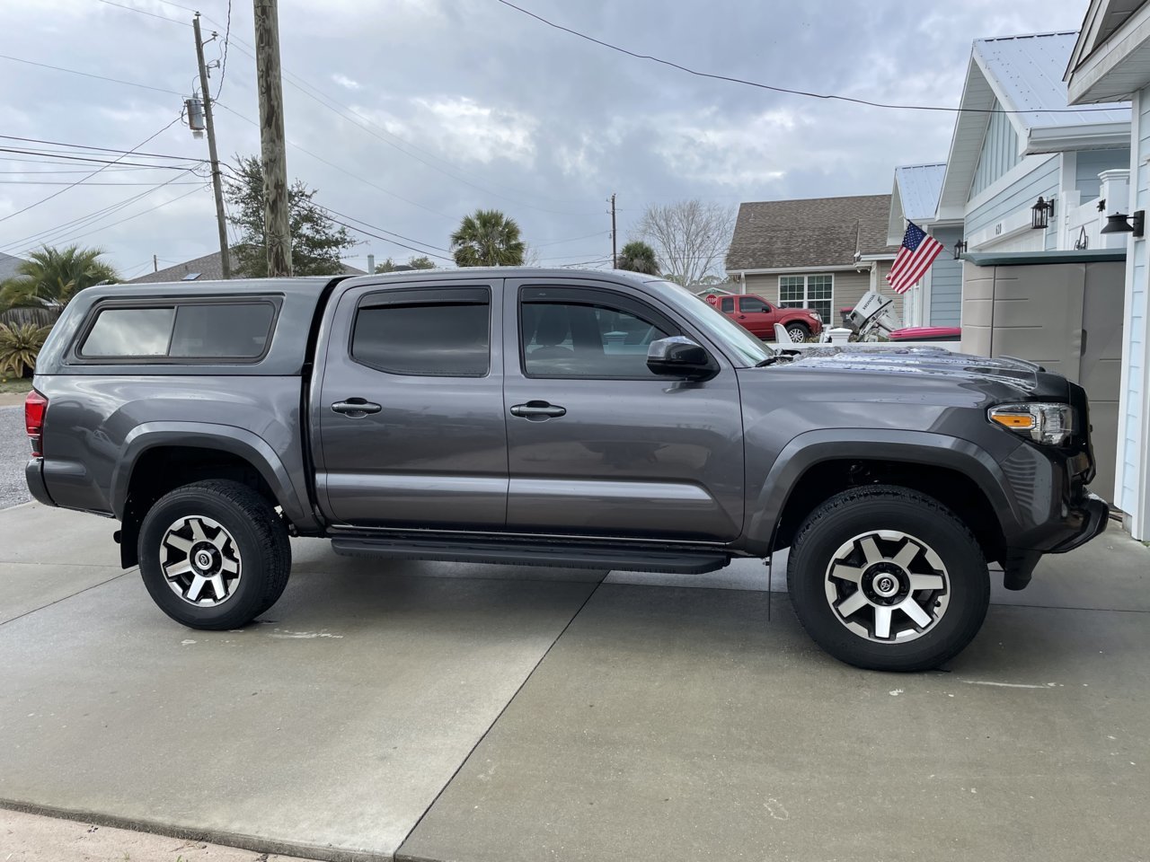

    Hard to see but the cap and lip dont hang over/low like it would if using the supplied flat foam tape.

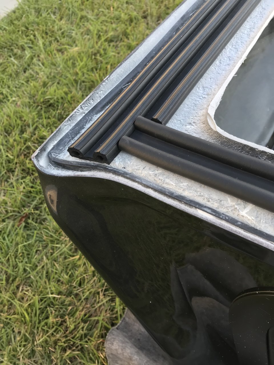

    Exactly. A proper installation should use a bulb gasket (like what you illustrate) rather than a simple foam tape. The foam will become useless in a hurry.
    Another problem is that the typical installation only uses 4 clamps. (Leer, in fact, does not use "clamps" but rather bolts through the lip of the topper.) IMO this is not enough clamping to keep the gasket compressed and the topper from sliding around. On mine, I added 4 more (actual) clamps, 2 in the middle on the sides and 2 on the front rail.

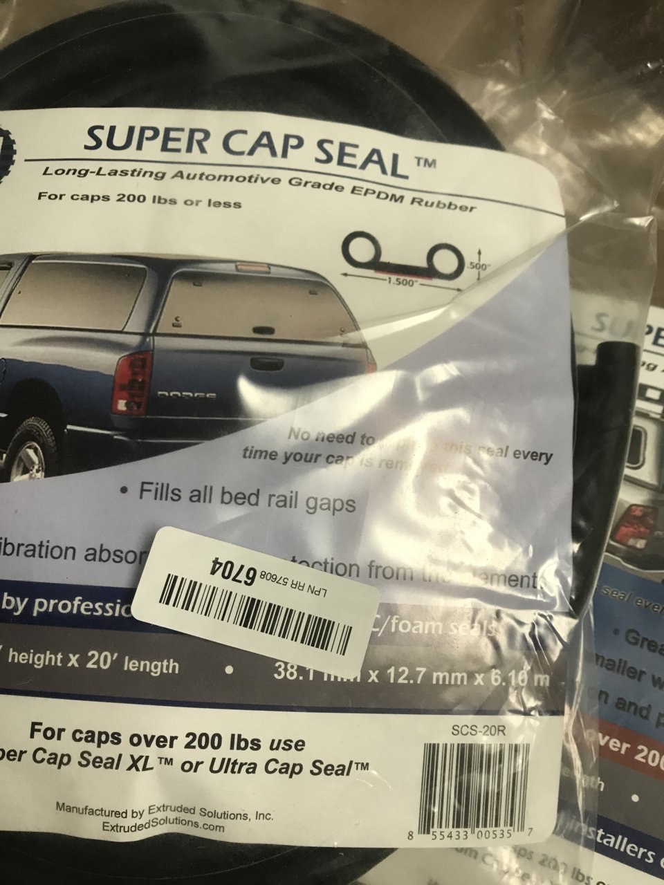

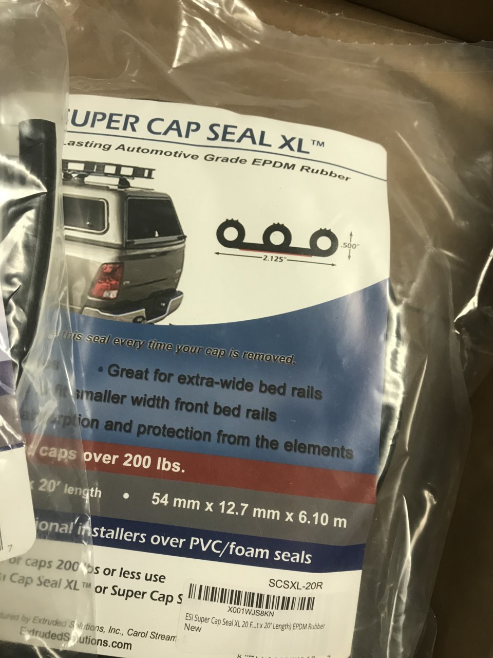

    Yes. Not saying bed stiffeners don’t have there place but more so for different reasons and preventative measures. I didn’t even let the dealer uncrate the cap- we just loaded it up on a flat bed and I was on my way. Spent a good amount of time cleaning the paint (clay/polish/seal) and putting my own gasket material. I’ll take pictures of the product bag so others can find it. I went 3 bulb on the side just for the fact the side rails are so wide and 2 bulb on the header because it was narrow. This material is rated for heavier weight which is why my cap has always been suspended on top of the bed rails rather than hug with the lip below. Some might not like it because it may not look as seamless but I d take that over paint rub any day. I have the foam tape supplied still bagged when I sell this cap and replace with the alucab
    I have the 4 clamps they provided (wouldn’t mind 2 extra for in the middle) but it hasn’t moved once in 2 yrs but I don’t OffRoad either. I also probably tighten them a bit more than they recommend (which always seems loose but maybe because of the thicker gasket).
