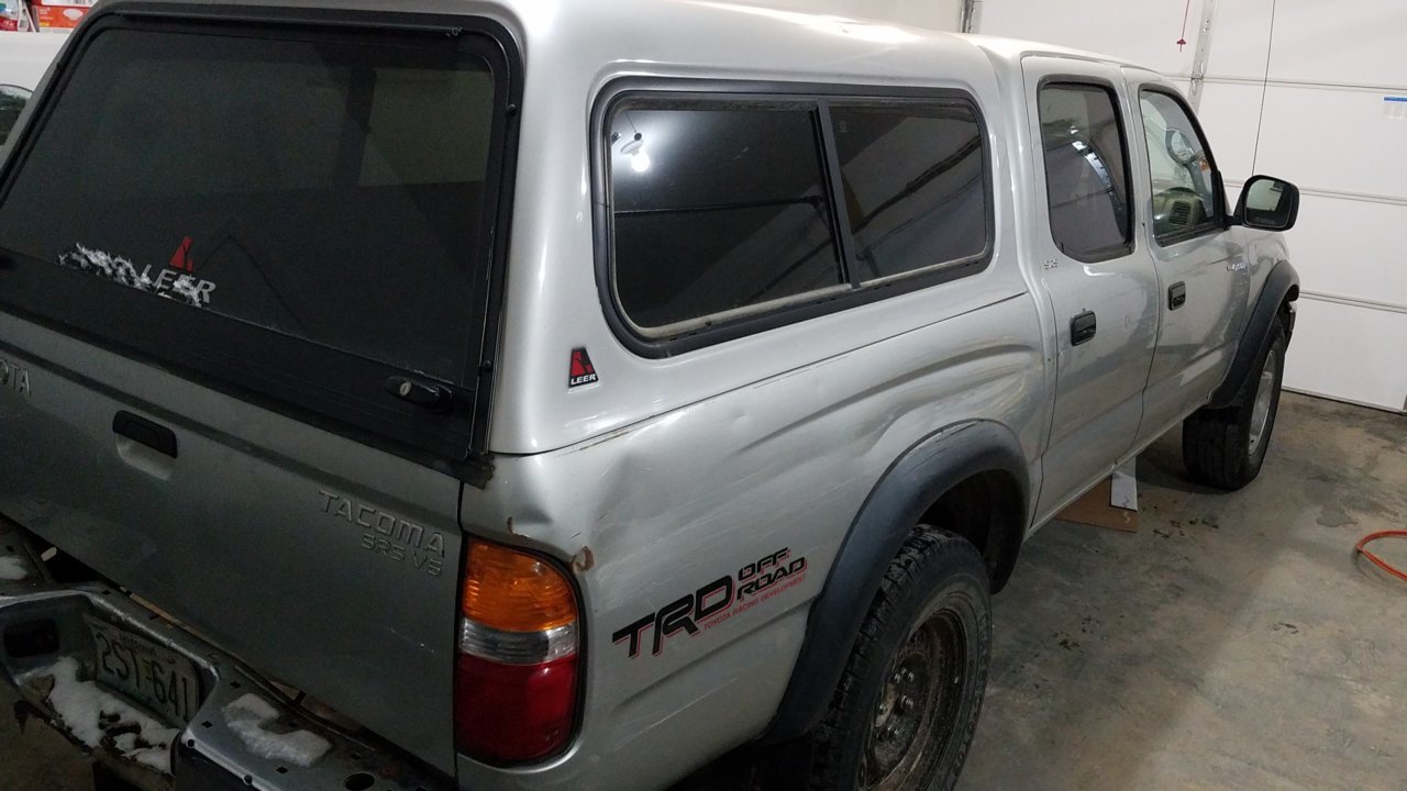

    so i picked up this 03 dc trd sr5, v6 auto from my father-in-law. he is a rural mail carrier and has hit a few mail boxes in his time. so i've been fixing a bunch of little issues that a 300k mile truck has. the speedo wasnt working, turns out a wire was broke at the speed sensor. front marker lights were burnt out, master cylinder leaked bad, tires were shot. wiper squirter wires were broke. the only "bad" is that the rear end started making noises on him and he had a shop work on it. they ended up swapping the whole locking diff axle out for a non-locking diff axle.

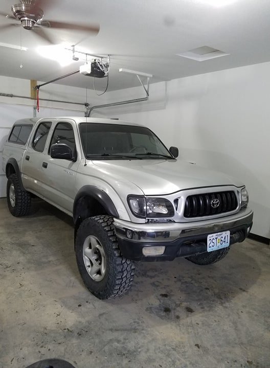

    put thunderer m/t 265/5-16's on for now

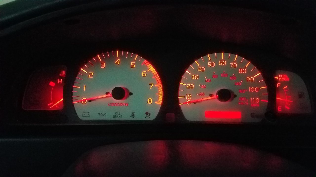

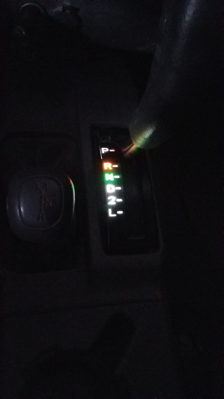

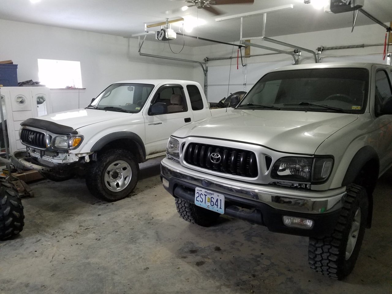

    half the dash lights were out so i bought red led's.

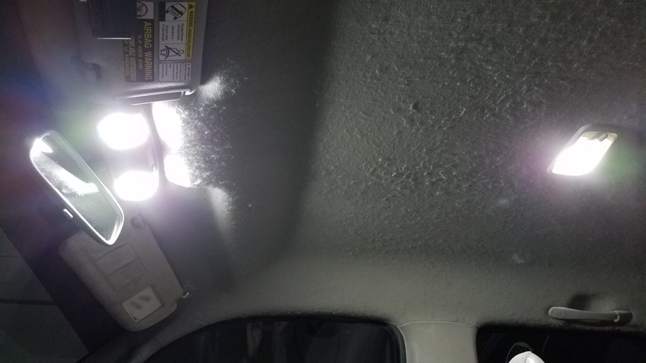

    led overhead lights and shifter
    tinted the windows. here it is lined up with the other rides (not pictured is an audi a8)20190106_165543.jpg

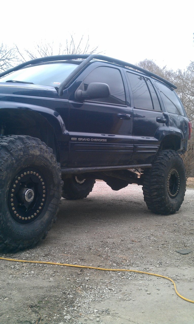

    heres my previous rig. 99 wj, one tons, 38.5 boggers, dual cases, 3link front 4 link rear, sbc 350, hybrid exo cage half inside half out

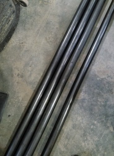

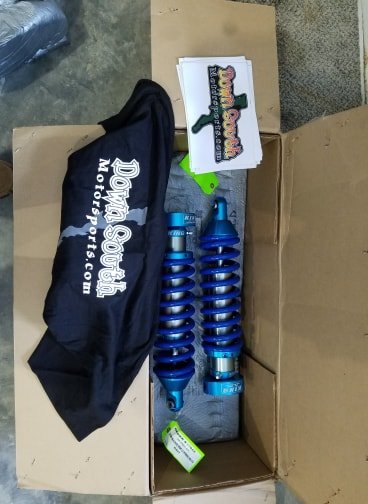

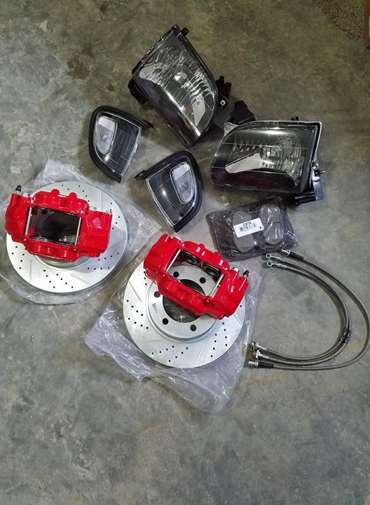

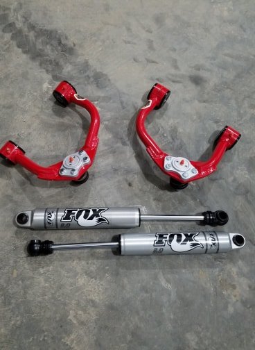

    few parts showed up. tundra brakes and head light set. got 4 sticks of 1.75 hrew for sliders and bumpers
    51926013_298854510812161_1378444735466700800_n.jpg 51782166_345427239390915_2449572878593556480_n.jpg

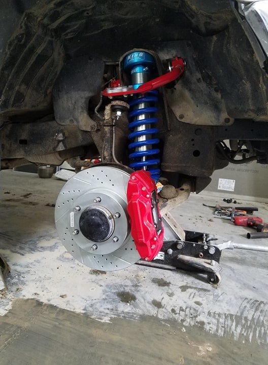

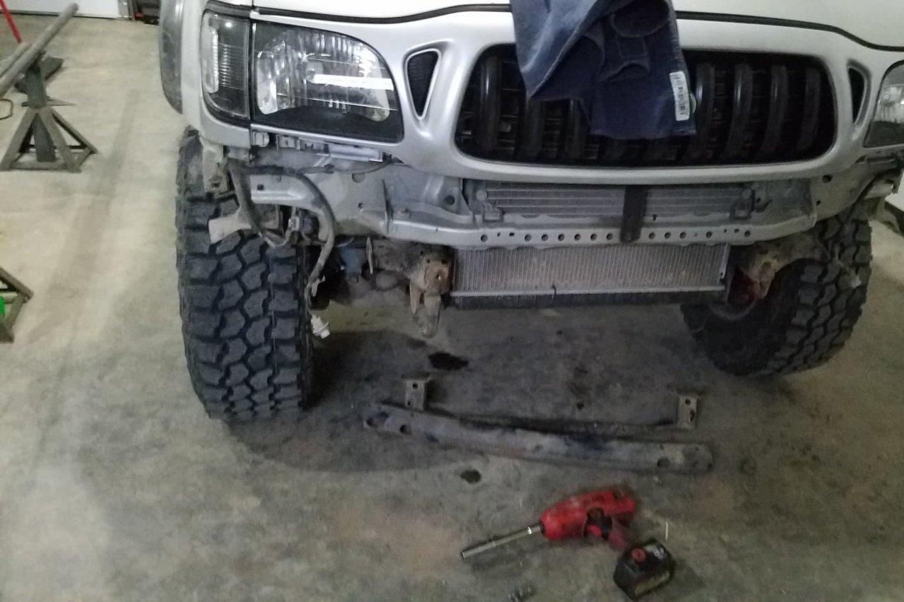

    got the front done, both sides. everything went easy. now onto the rear.

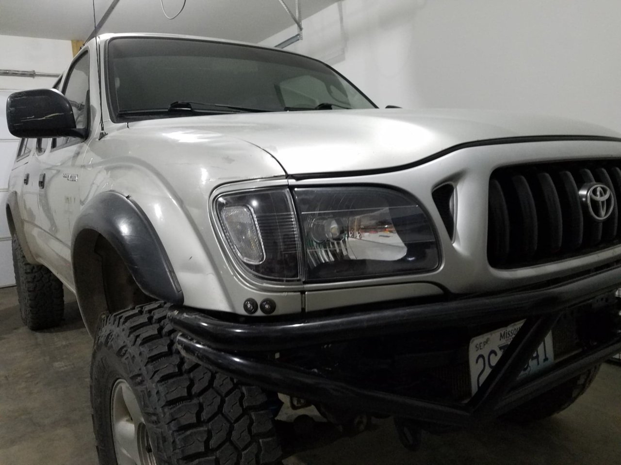

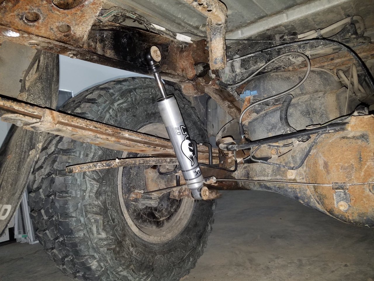

    26

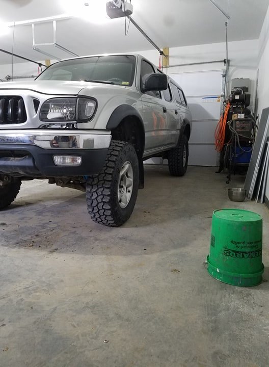

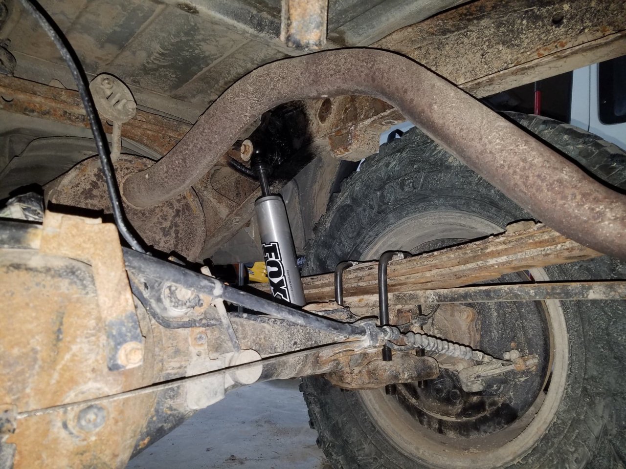

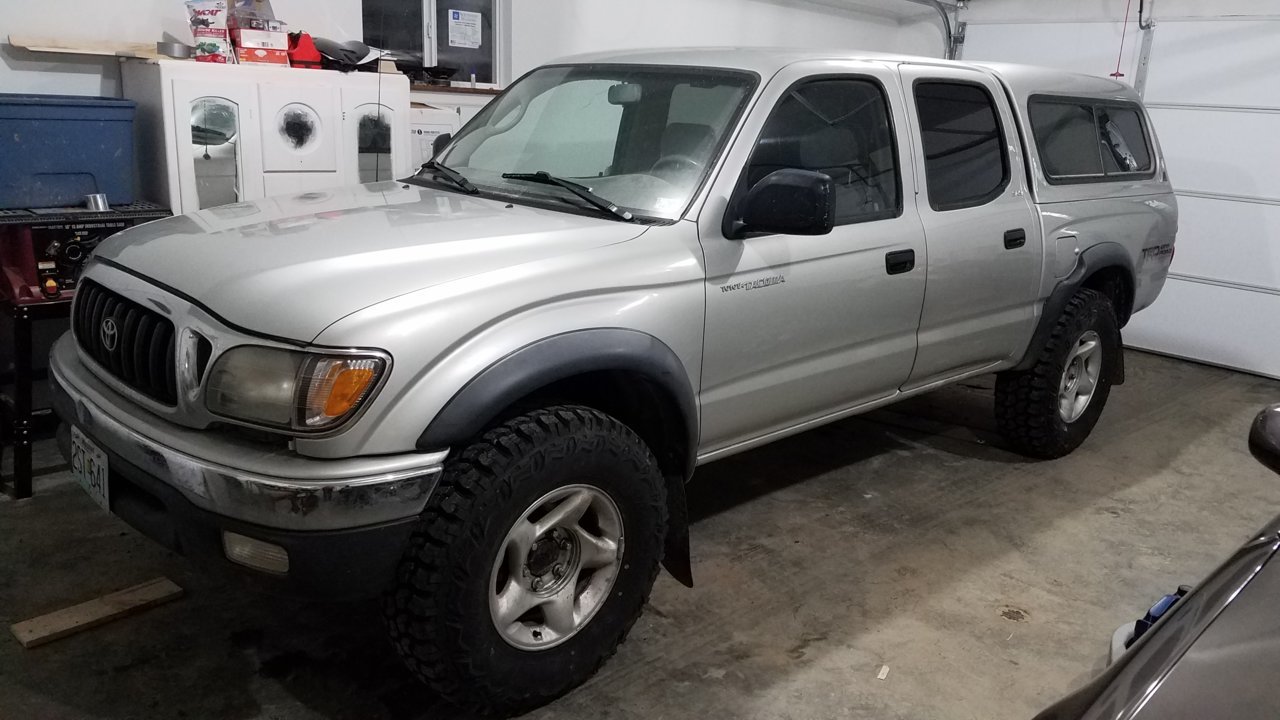

    got the rear done today. ended up with 3+ inches of lift. the shocks are for 1.5". so i ended up cutting off the top shock mount and moving it down. i used 3 leafs on each side from a cherokee. i measure 24 1/4" to the gap between the door and rocker front and rear. new u-bolts and the crown extended brake line. in the future i'll do the u-bolt flip kit
    53390451_293450277998701_2177881072879009792_n.jpg 52989959_331462530831485_6869997543699251200_n.jpg

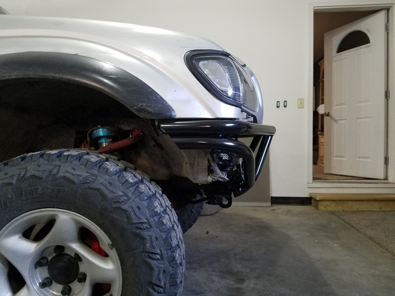

    also got my silver grille and new headlight/corner light setup on. i need to get the fillers painted, thats why they are off. will get an alignment this coming week.
    53317829_292882504689315_3919892702598004736_n.jpg 53551234_451509728925475_4296363967825051648_n.jpg

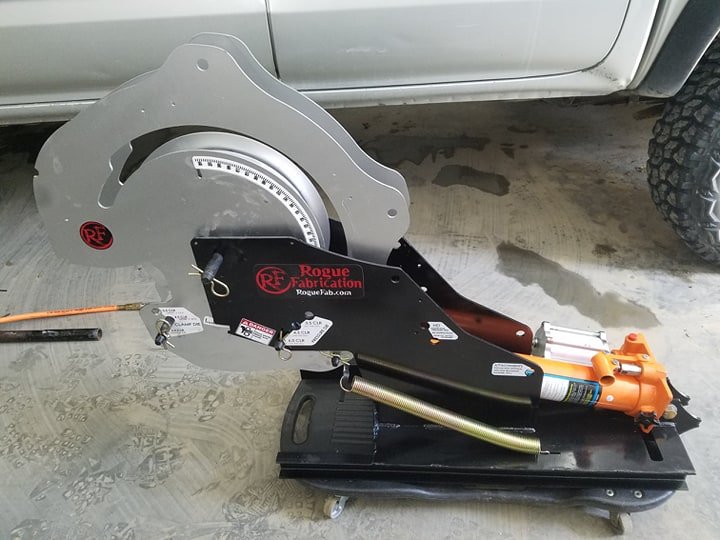

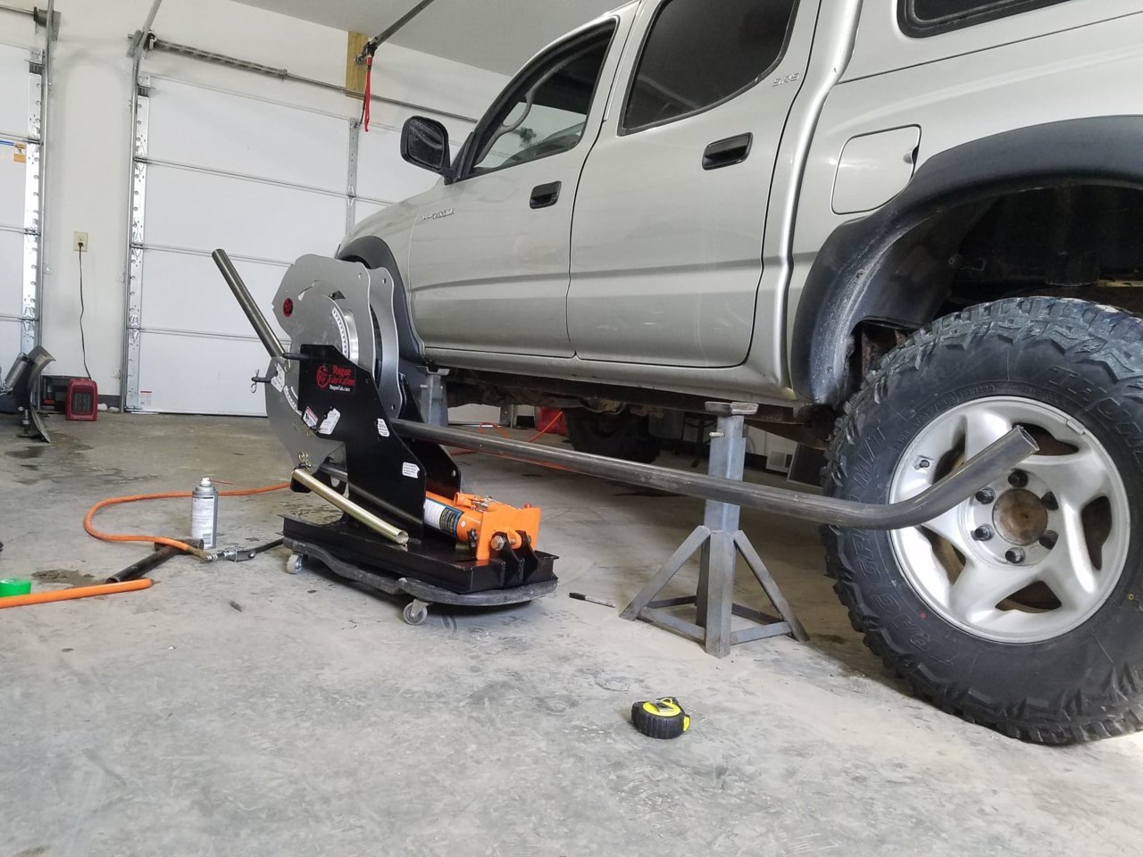

    Rogue Fab bender. getting a start on the sliders.

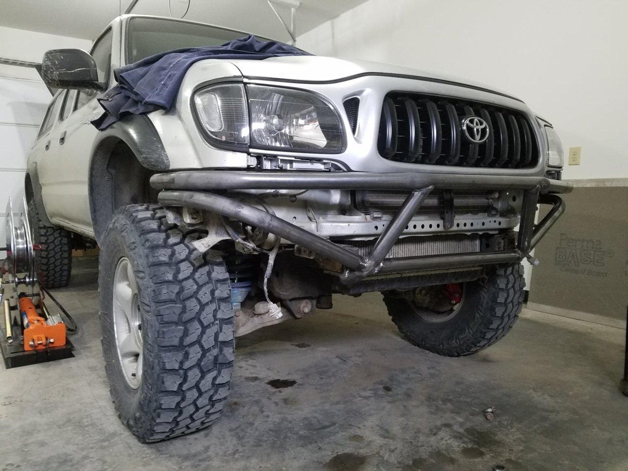

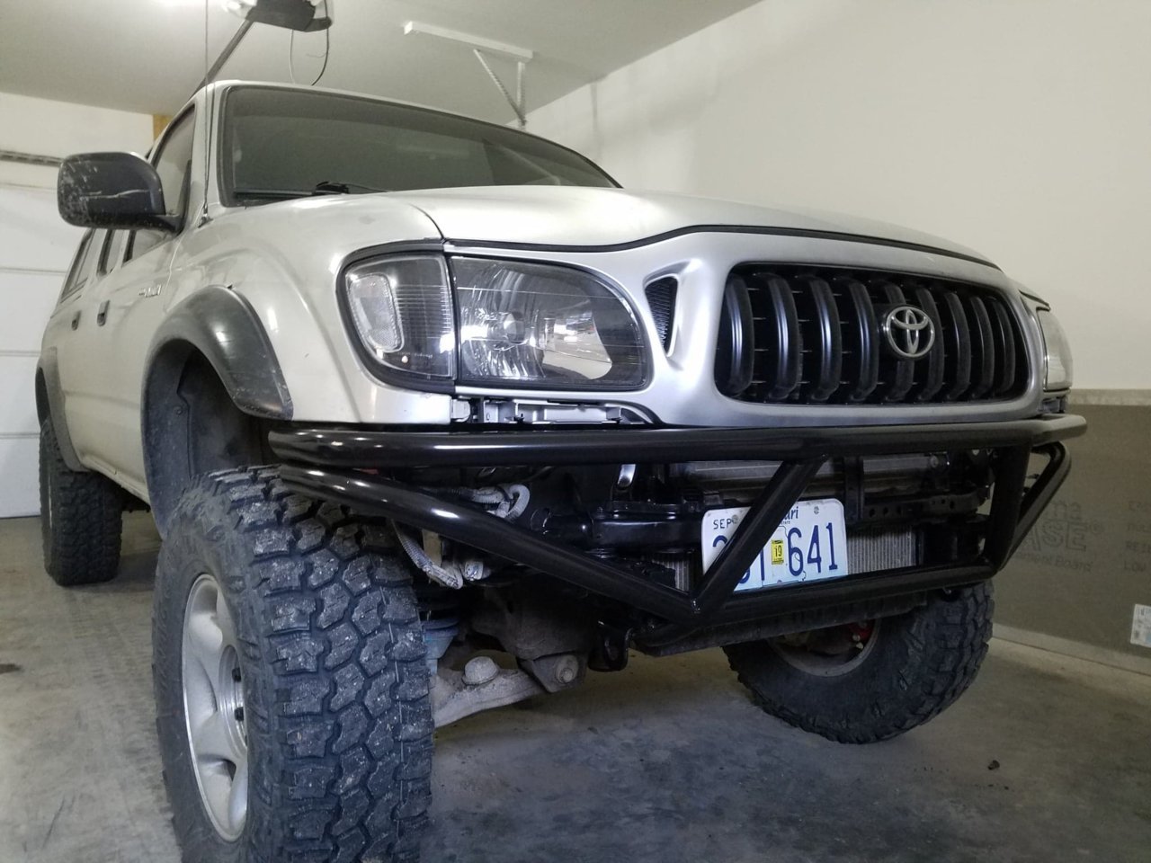

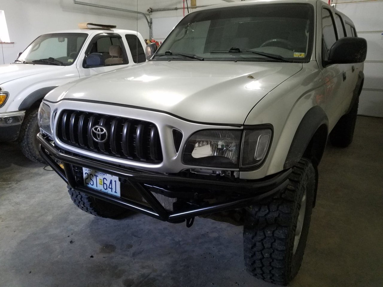

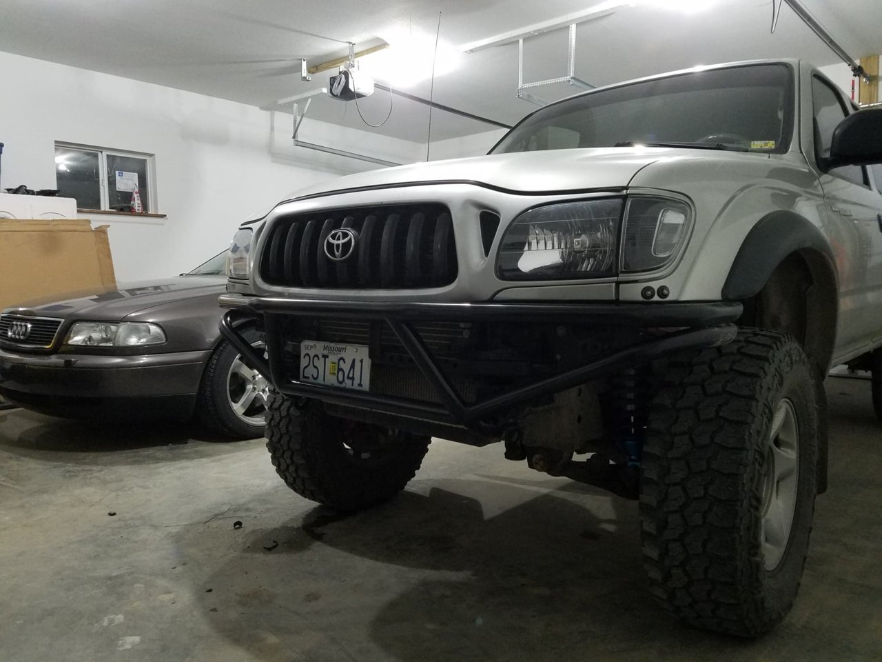

    got my tube bumper built. i saw one like this on a red truck but i cant remember who it was, but i copied it
    bumper off
    my homemade tube notcher
    top bar
    all done but the paint
    Reh5108 and CodyDaltonNV like this.

    color matched spray paint for the corners and fillers. also 3/4" amber led's for turn signals. i know they aren't everyones choice but i works for me
