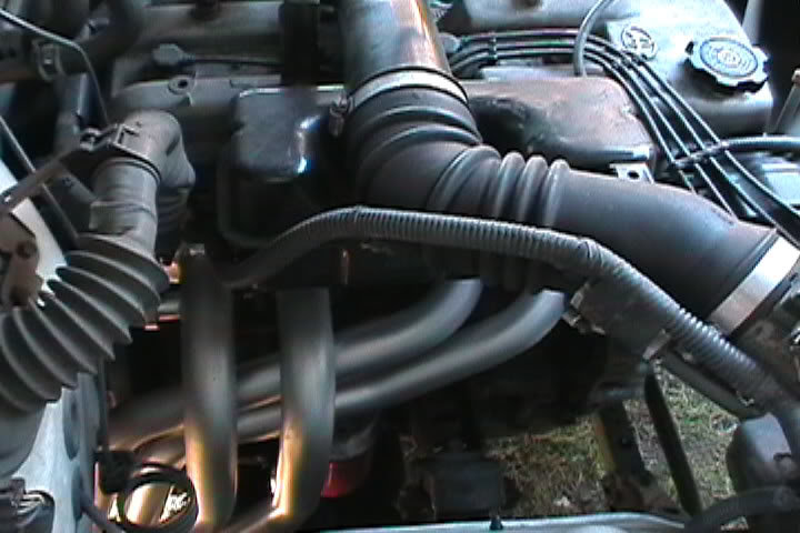

  15. Apr 17, 2013 at 8:51 PM
    #35
    oldblue1968chevy
    oldblue1968chevy [OP] Well-Known Member
    Nov 26, 2012
    #91916
    1,525
    John
    Spokane WA/Viola TN
    2000 Toyota Tacoma V6 TRD
    Stock
    Idk the best sequence for removal/installation but I just left the studs in the head (aluminum) and removed the rest PITA to get put back in
    note to others-the dipstick will rub the header (Transmission) i havent tried trimming it but will try and update the thread..
