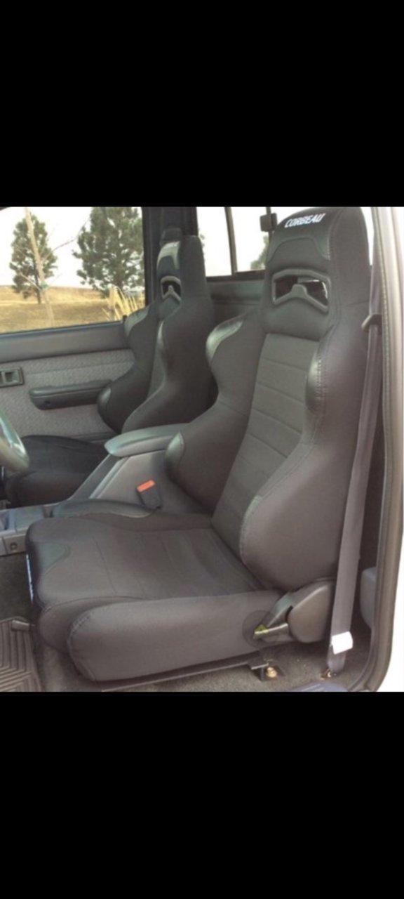

    Anyone ever do corbeau/other + seat jackers?

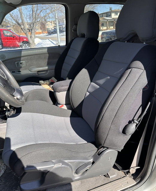

    As requested by @c0climber here is a pic.
    Note I do not have a console in yet and the squeeze bulbs or for pneumatic lumbar bladders.

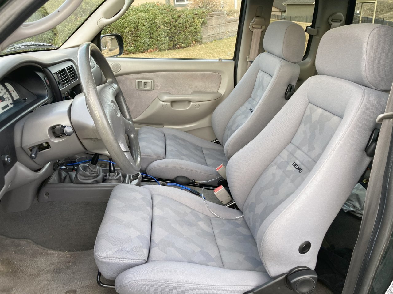

    what did you do for mounting brackets?

    @Madjik_Man Brackets are by Planted out of Seattle. They were a 95% fit. Drill a hole here, machine a shim there and done.
    I wanted black cloth for the seats but could only get the grey cloth. Colorwise it is close enough to the ubiquitous Tacoma grey. Too much sun here for vinyl or leather.

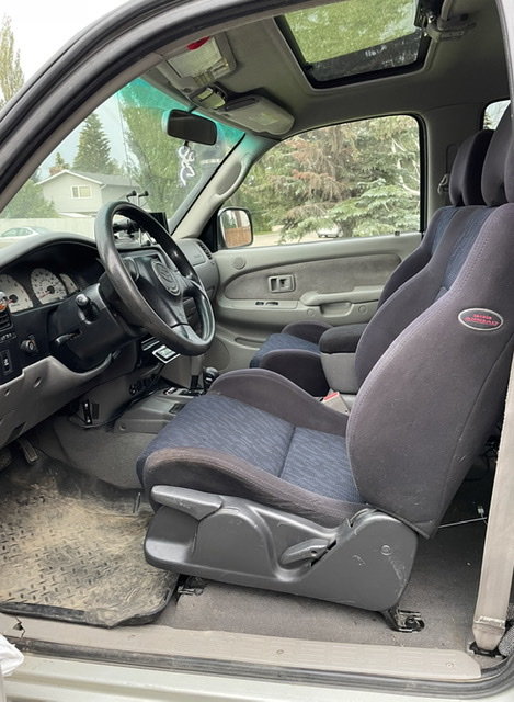

    01 Dbl Cab
    Those recaro’s look amazing!!!
    I went WRX seats, and I’m never going back. Best addition to the truck that I’ve done
  19. Mar 17, 2023 at 3:06 PM

    What year did those come out of/what years will work? What did you have to do to make it fit?
  20. Mar 17, 2023 at 3:34 PM
    #40
    Rhodes
    Rhodes Well-Known Member
    Jan 16, 2021
    #353000
    380
    Edmonton
    01 Dbl Cab
    Mine came from an 02. I was told a 00-04 would fit the best width wise.
    I cut the ‘feet’ off of my oem seats, bolted them in place. Then cut the feet off the WRX seats. Placed the seat on top, lined it up and tacked it. Removed seats, finished welding and touching up with paint. Then bolted them back in.. it was a bit of a process but like I said, I friggin love them. I’d do this over my supercharger all over again if I had to.
