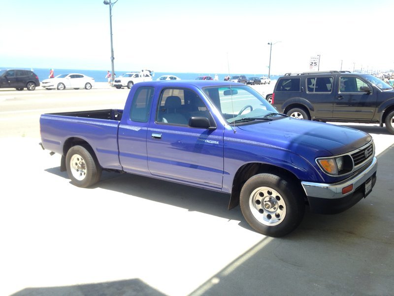

    Hi I just got a 1996 Tacoma extra cab. I love it. I want to make some modifications to better suit my needs, and I need some help/suggestions. I currently have 5 lug wheels with P215/70R14 tires. The truck pretty low to the ground. I want to add larger wheels lo make the truck higher. I was thinking 16" wheels? I will be taking it off road occasionally but mostly on the road. Should I just get bigger wheels/tires or would a lift be a good idea too ? I have also heard that lifting the truck can cause issues with speedometer and odometer. Any and all suggestions would be greatly appreciated. Thanks!

    Options for our 5 lugs aren't as great, but there are some things that can make it more capable.
    It's not lift that affects speedo/odo, it's tire/wheel diameter. You change the effective gearing with that. And if you get over zealous, you can turn the truck into a slug.
    The good idea about moving to 15 or 16" is tire availability. There is a tire calculator here that will let you compare before and after choices.
    Last tip. Build the truck for how you will use it 80% of the time. If you build it for that last 20%, the other 80% won't be nearly as enjoyable. Read a lot, learn a lot, before spending your hard earned sheckles!

    Thanks for help/advice. This is my first tacoma and I'm learning a lot already. The first thing I've noticed is what you said, Clearwater Bill, not a ton of options for 5lugs.
    The truck is going to be mainly for driving to work everyday, but I will also be taking it camping and on surf missions down baja. I won't be doing any serious off roading or anything like that but I would like it to be able to handle dirt roads without any trouble. My plan is to fit it with a camper shell and make a camping rig in the bed.
    I am thinking of putting on 235/75R15 tires on it. Will those tires fit without a lift? I will have to get new wheels because mine are 14".
    Im going to keep reading and researching and I'll give the 5lug thread a shot.
    Any other suggestions of options would be great. Thanks everyone
