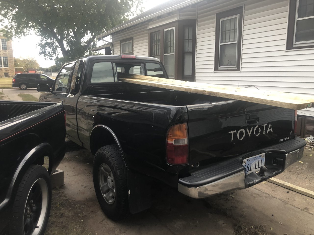

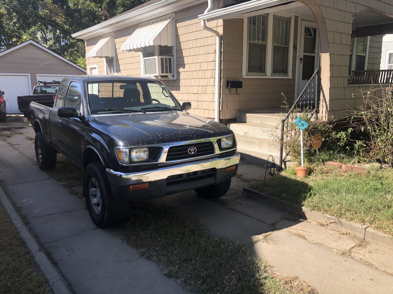

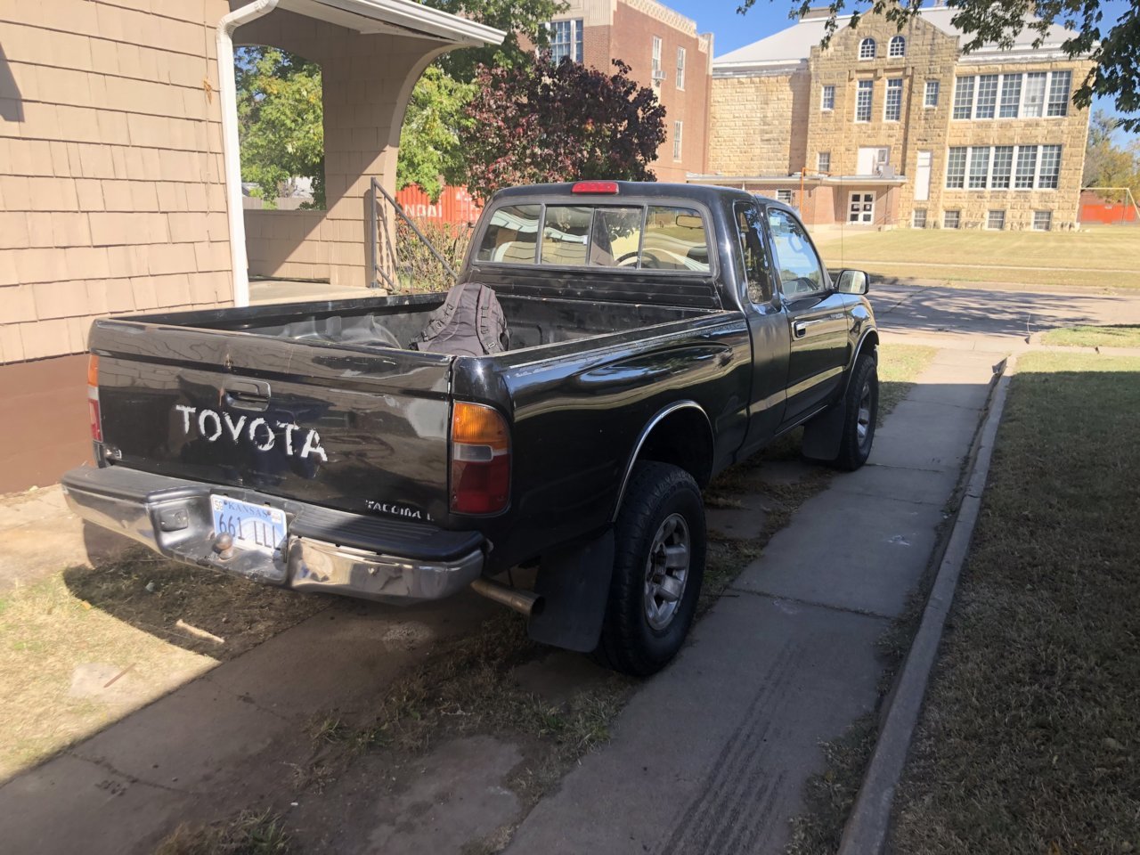

    The leaf springs have a bit of arch to them, and he shocks look like they were replaced at some point but are likely no better than the stock ones. I don't know about the front either, other than the struts have "Made in China" stamped on them. I think is has a small lift as it's sitting on 31's currently with a bit more rooms for larger tires.
    I'll try to get some pictures tomorrow. It's been a busy week.

    Here’s a couple pictures. We’re starting with the repairs and then will tackle the slight bits rust and body work later this winter
