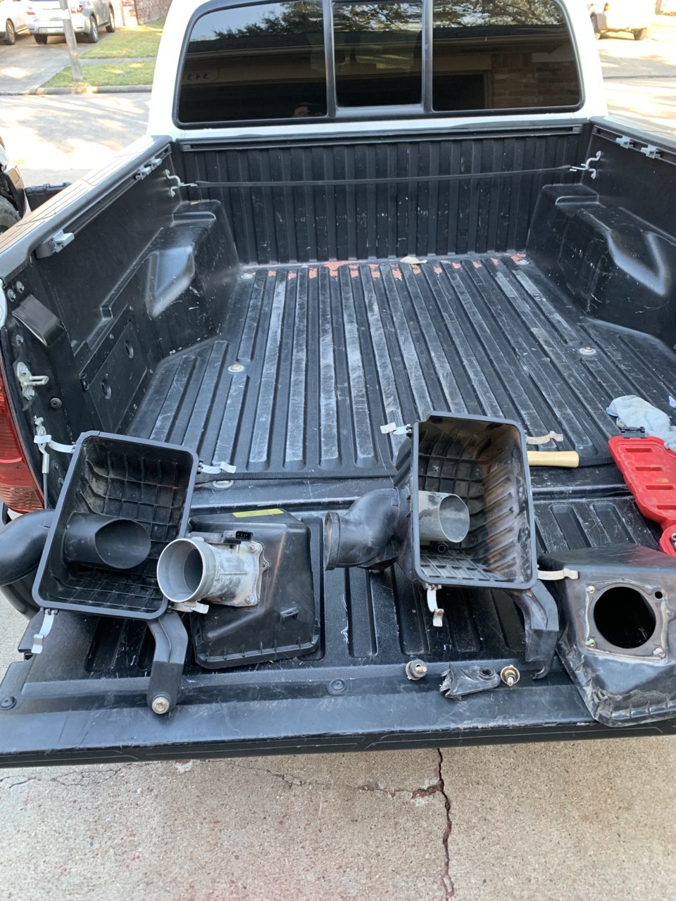

    (what exactly does that big box do? is there supposed to be a filter in there?)[yes, i did run search on 1999 2.7 intake, no i didnt find anything]

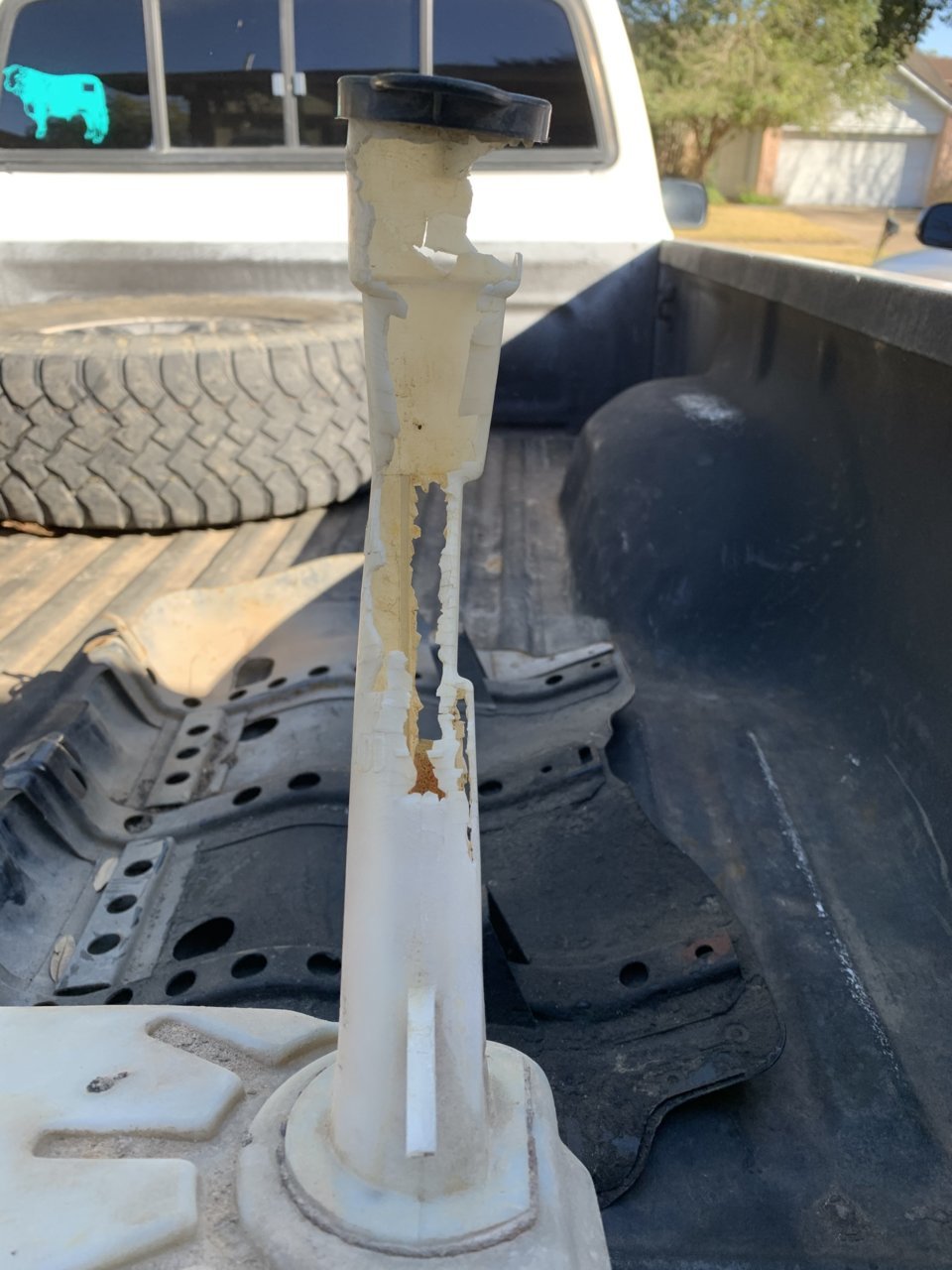

    so i ran into an issue:
    when i was securing the battery, i smelled gas. smell is coming from radiator coolant bottle. I removed radiator cap...it smells like gas too.
    any mechanical idea as to why that might be?
    the guy i bought it from, he bought from auction, he fixed and got it running.
    i'm noticing he took a few shortcuts in fixing some things. so, could gas smell be from using gas lines from another car?
    i guess what i'm asking is, is there any way that the fuel system can leak into the cooling system? or vis-a-versa?

    Gas in coolant may be head gasket.
    Remove radiator cap, start engine, look for bubbles at radiator fill.
    cool_hand_pete[OP] likes this.
  12. Dec 30, 2020 at 6:53 PM
    Black DOG Lila
    Black DOG Lila Well-Known Member

    That is a resonance chamber to dampen and smooth air impulses and 1. quiet intake noises 2. increase midrange torque. It's a super neat engineering thing kinda like expansion chamber tuning on 2 strokes. But on a 4 stroke. And intake side.
    Edit: on a spec miata we used to run we did back to back dyno runs with 2 versions of the miata box/pipe. One had cheaty plates glued in to 'remove' the chamber and create a straight smooth shot for the air, the other was stock. We lost 3 HP from 3,000-5,000 with the cheaty pipe...
    Oh, and put a good quality air filter back in and change it at the stated intervals. There is no gain in going to a K&N and lots of loss. Their 'filtration' is rubbish.

    That's a good list. I would first check out if your head gasket is OK. If it's leaking, and on its way out, it could strand you and do a lot of harm to the engine.
    BTW- I have never bought a vehicle with a salvage title. My concern would be licensing and insurance. Can you get the title changed to a regular one if you get it inspected by HP or DMV?

    Oil evident in the top of the radiator, and/or the overflow tank. Referred to as the "pink milkshake" since Toyota brand coolant is pink.
    Water in the oil. Drain and check since oil floats on water, the water will be on the bottom. Watch for it when you first pull the drain plug.
    Loosing coolant but no leak is evident.
    White smoke from the exhaust.
    Compression check.

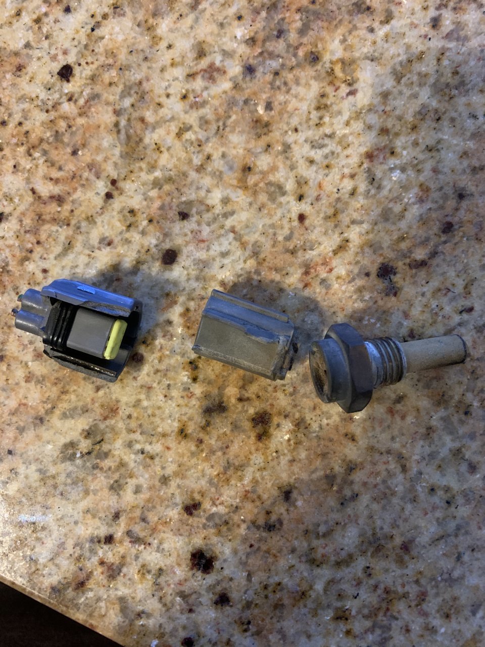

    replaced coolant temp sensor: (passed inspection after this. YAY!! we are legal now!!)
    replaced washer reservoir:
    and air filter box for one slightly less broken:
