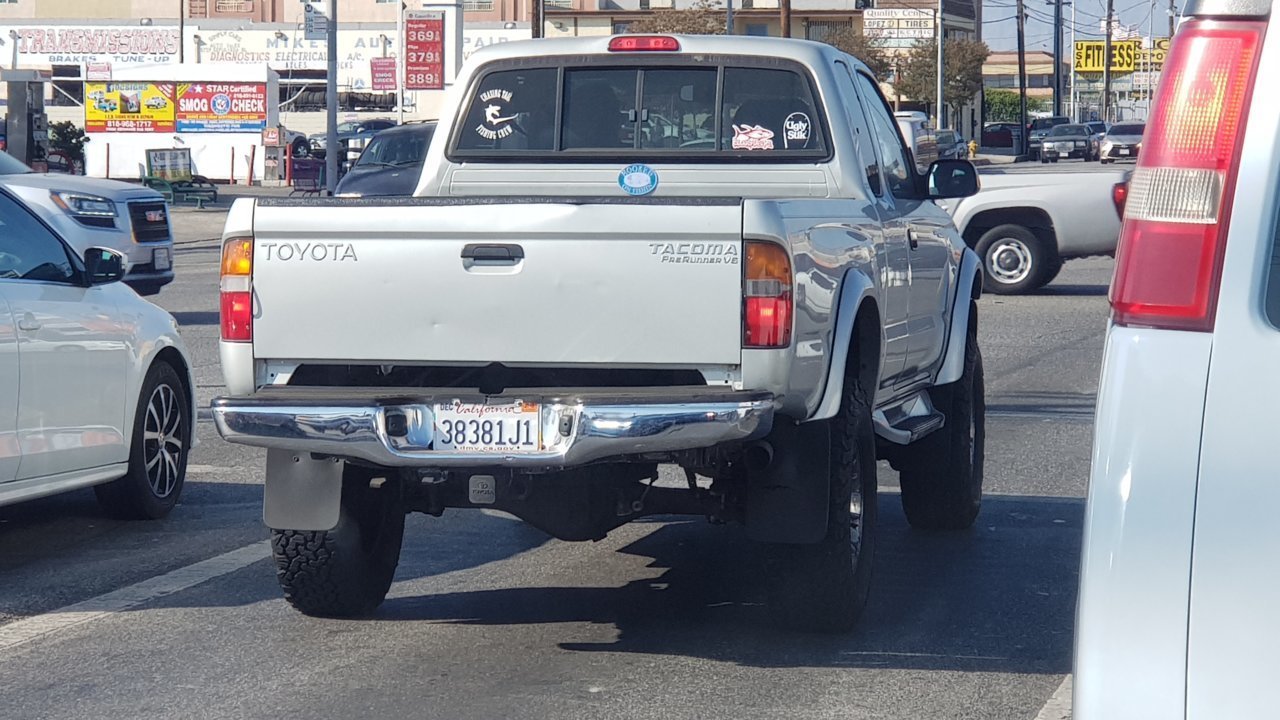

    Aside from a drop bracket, you can also go with a body lift & have ass crack like this. :rofl:

    somebody forgot to flip/swap the brackets.

    lmao the bumper isn't even on straight
