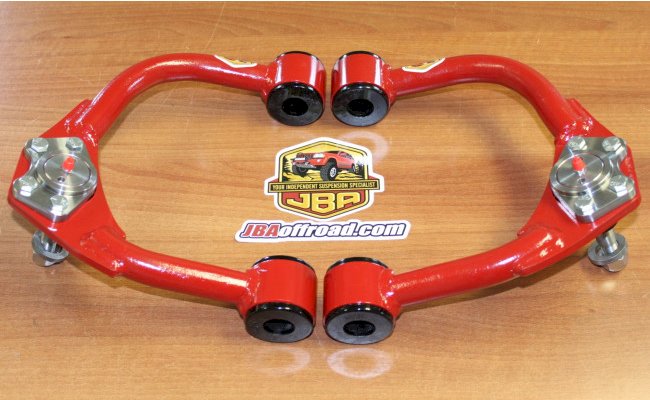

    Mine came to almost 3" of lift.
    I did the following with a buddy in his home garage with just minor tools.
    The ride, handling and performance even if you do not off-road makes this an ideal system.
    Shackles and spacers are a poor man's solution, but you pay dearly for their cost savings
    ON THE FRONT:
    upload_2018-12-30_13-22-14.jpg (2) Bilstein 5100 Height Adjustable Front Strut Set D558 $175
    upload_2018-12-30_13-22-40.jpg Old Man Emu 2881 Front Coil Set $160
    You can leave your stock Upper Control Arm as I did for awhile, but that will be problematic. I installed these JBAs costing $485 some years later.
    I wish I would have installed them from the beginning.
    The improvement in handling and wheel alignment is so radically better with these it makes them worth it.
    ON THE REAR:
    upload_2018-12-30_13-33-40.jpg Deaver Racing Leaf Springs at $700 (current price).
    You can get a few inches of lift from any aftermarket spring or even adding a leaf or two to your stock springs. While cheaper that way I wanted the ride that these racing springs give (if you don't haul heavy things).

    I agree with 2Beers, you cannot go over 3" without a lot of cash.
    However you can get up to 3" front and back for ~$400 and have a good looking and a reasonably functioning suspension system.
    Use the new Bilstein adjustable 5100s ($175) with your stock springs and adjust them at the highest setting to get the 3" in front.
    For the rear you can get 2" with an "Add-A-Leaf" kit ($65) and get the last 1" with an Amazon shackle kit ($50). Of course you will need to get new shocks in the back to adjust for the height, maybe Bilstein 4600s ($110).
