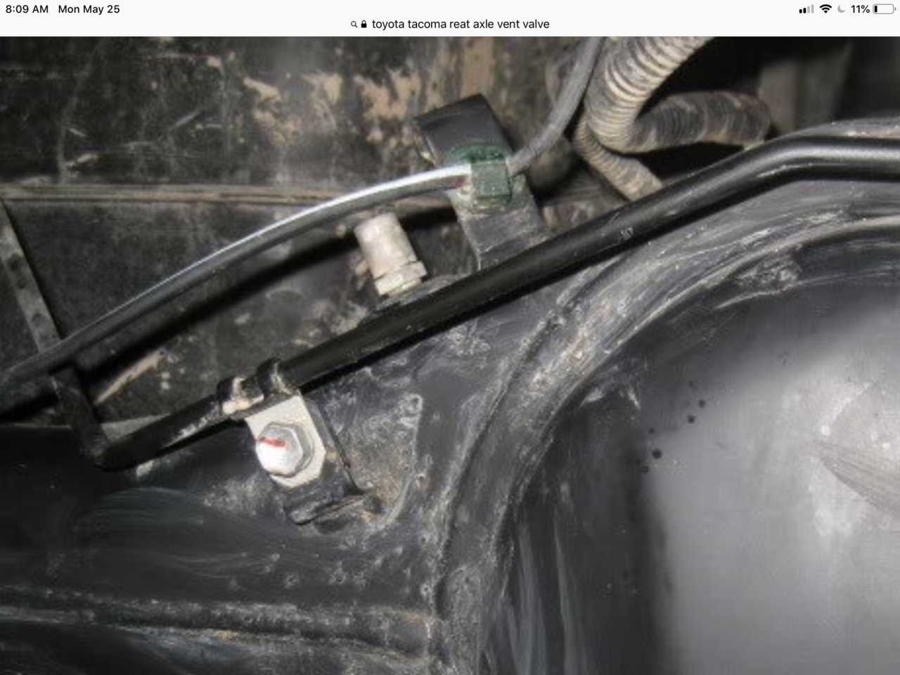

    Also make sure your rear diff axle vent valve is clean and working,
    If it’s plugged or stuck closed you will blow out your axle seals, 1000.00 repair.
    Axle relief Valve is a 10.00 part,
    https://www.tacomaworld.com/threads/my-differential-breather-mod-photos.111954/
