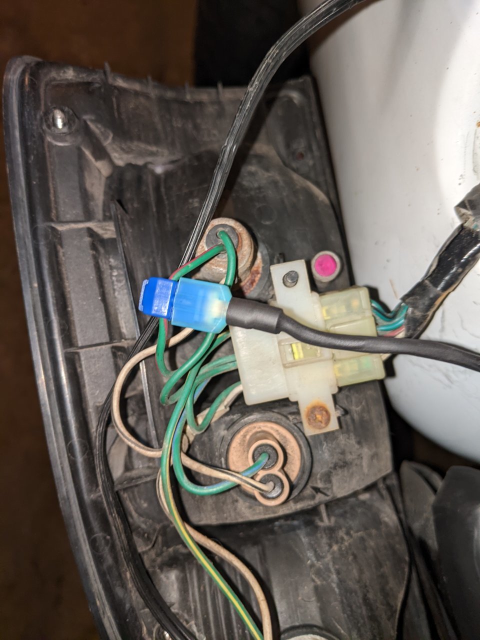

    There should be a set of wires exposed along the inside of the shell. You can connect those to your rear light by putting the wire through the bed. This is a pic of what i did for mine, used a T-tap connector to tap into the wire for the brake light. I did the same for the ground, not shown in the pic. You should also test that the light to make sure it actually works before connecting it all up. Just connect those wires to negative and positive terminals on a battery.

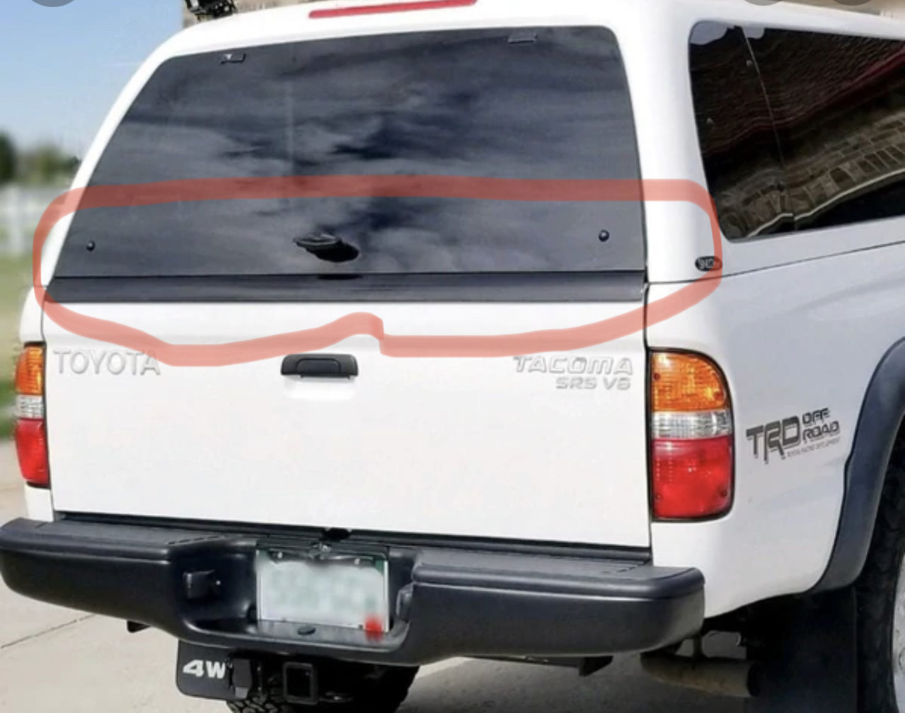

    I think I worded that wrong, I meant the flap/ seal? :notsure:
    I think the previous pulled on it to hard that is falling apart, whenever I get home I can get a pic of my topper.

    You should be able to replace that but might be a bit of a bitch to slide it out. I also need to replace mine.

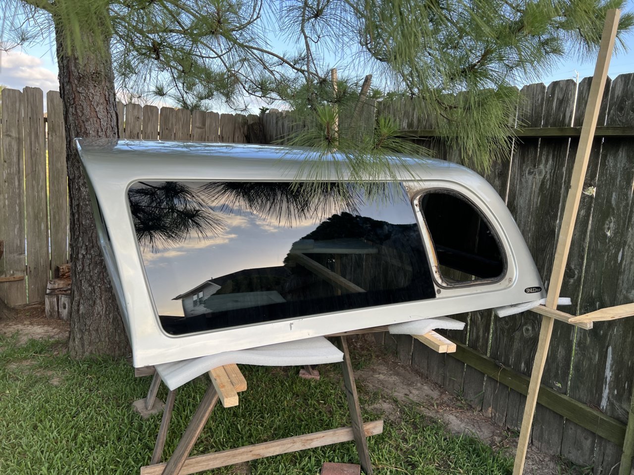

    Here it is!!
    I have the rear window btw :D
    also I have been looking for some places to paint it but no luck.. does anyone know of a place here in Houston?
    I would also be happy to trade it for a red one, it’s going to be a bit of a hassle trying to paint it. Thanks!

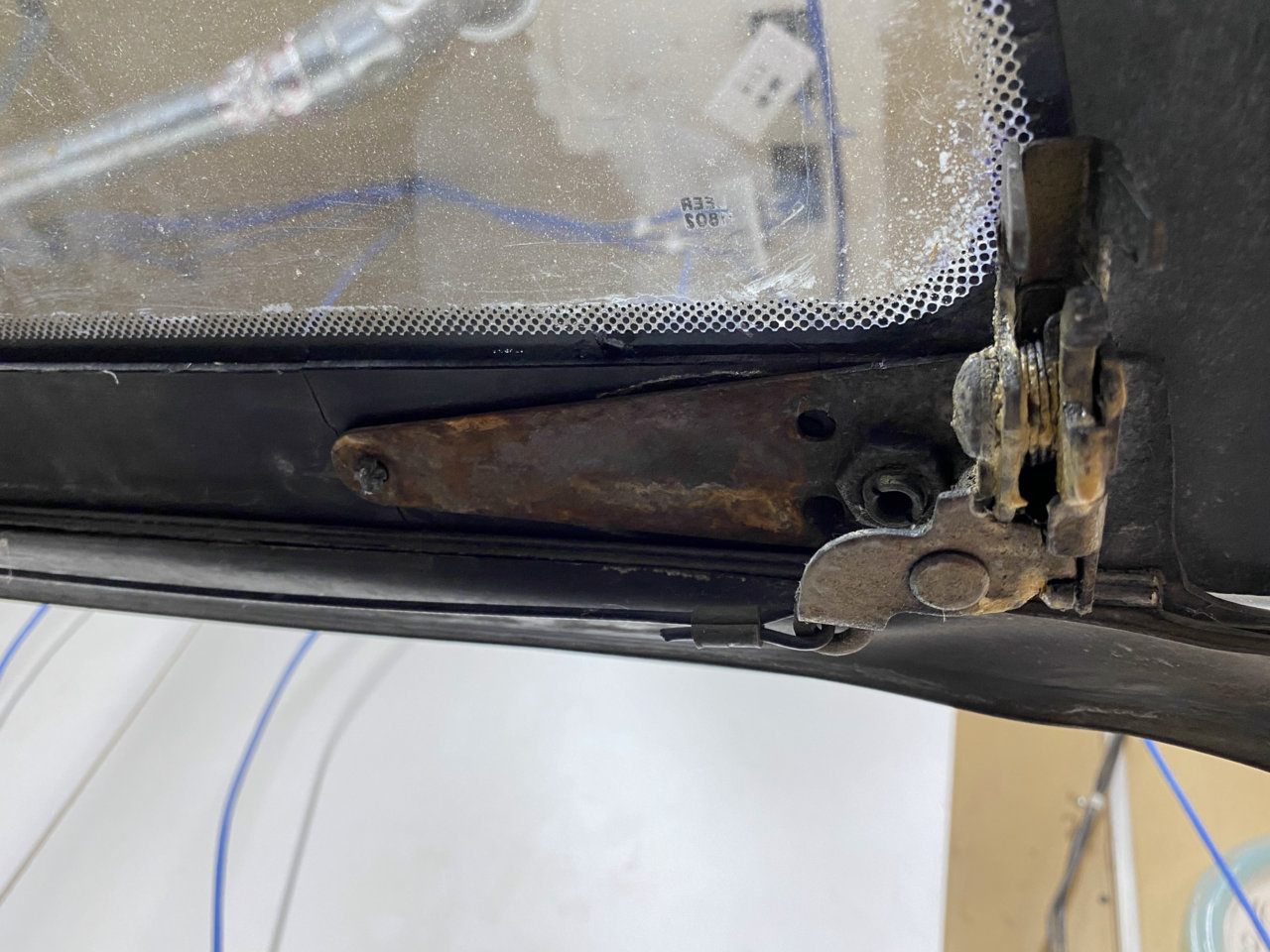

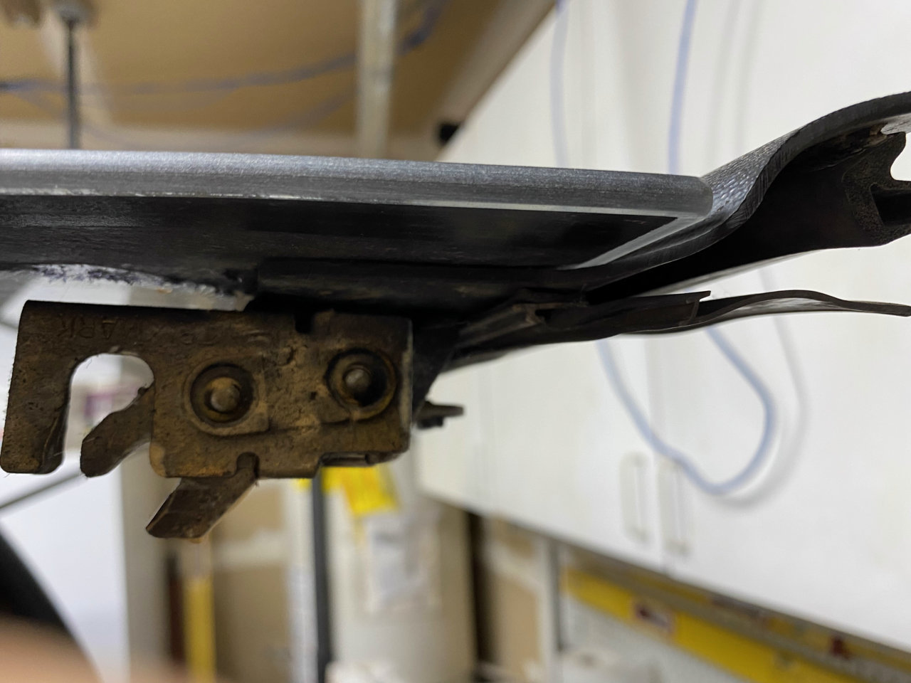

    I looked closer at mine, not sure if OP's is identical as mine is Leer...I'm somewhat doubtful that this part is still available and in any case its very fragile. On mine the latch is held by a bolt through the glass but also with a plastic "nub". The exterior plastic protector is cracked in multiple places, its so thin.
    I would have 1/8" aluminum flat stock bent into a S shape if you can find a guy with a brake and glue/bolt this onto the glass with the rubber bulb. Then the second latch mount point could be a counter sinked screw. Of course round the ends of the exterior metal corner because that could hurt.

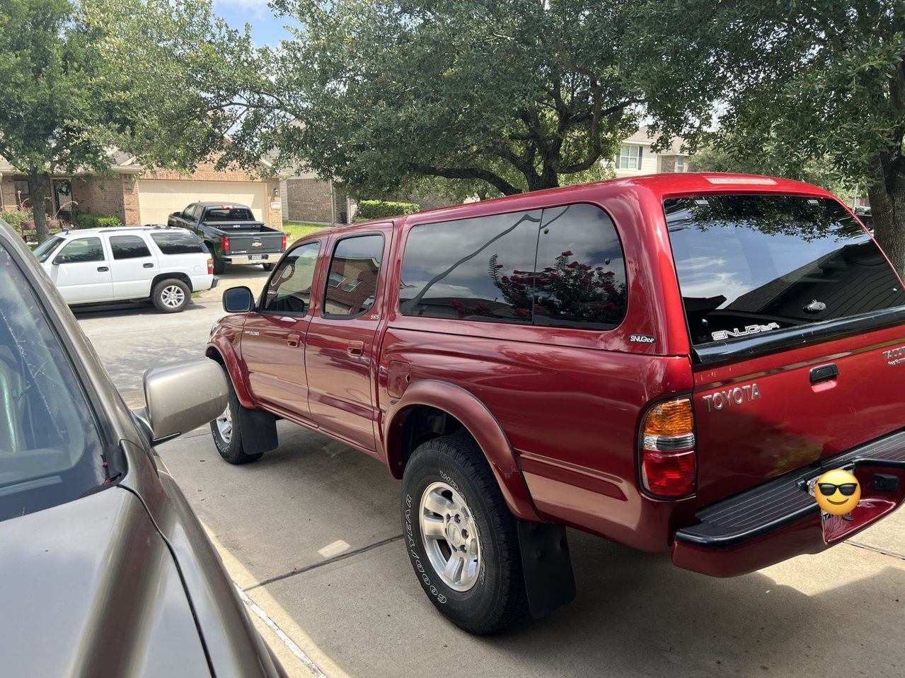

    Update…
    Yesterday I found a place to get it painted, guy asked 400. Final price for topper 775

    And booom :bananadance::bananadance::bananadance:
