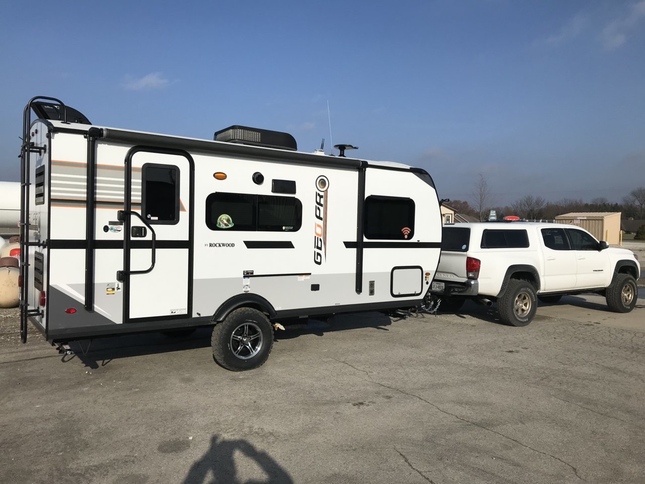

    I can give you some real world advice and what to expect.
    Here'e my rig on day of purchase:
    GeoPro 19FBS
    3800 GVW. (fully loaded it's around 4300)
    380 tongue weight
    The Tacoma is NOT a good tow vehicle over 2000 lbs. It can do it, yes, but it is not a fun drive.
    Low speeds around town will not be an issue.
    Highway travel will be very, very laborious on anything other than flats and downhills.
    Hills and headwinds will significantly drop your speed and MPG.
    At best, I'm around 11mpg.
    At worst, about 7mpg.
    I'm sure you have a brake controller already. I hope so.
    And a WDH is an absolute necessity. Don't even try without. Please.
    ScanGauge2 helps monitor tranny temps - I've never had any issue with overheating even in Texas summer.
    Lower your expectations.
    Get an air bag suspension or some Dakar leafs.
    If you can swing the $$ after the trailer, go 4.88 or 5.29 gears and an OVTune - these help.
    If an AT, treat S mode almost like stick. Long downhills, put it in 6th, as the hill levels out raise to 5th, then to 4th on the flats and up hills. Spend most of your time in 4th, and on long uphills sometimes 3rd.
    (edit - if you have a nice tailwind, 5th gear on flats is where you'll find some better fuel mileage. IF you have a solid tailwind)
    ALL SAID, if you don't expect your Taco to tow like a diesel or a V8, and drive it at a slow and steady pace, you'll be fine.
    Sounds like a lot of bad news, but if you're realistic, you'll enjoy that trailer - which is killer! Rockwoods are the shit.
