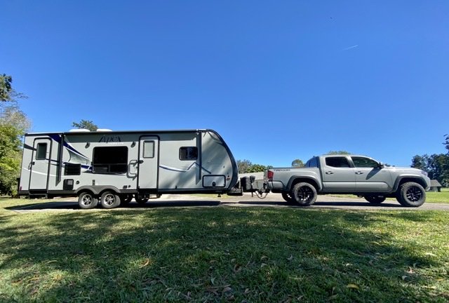

    As mentioned WD hitch and BC are musts, definitely sway controller as well. Take it slow, stay in 4th. Look into ways to read trans temps for long hauls, they are cheap.
    Have fun, be safe!
    APEX 249RBS, about 4800 empty wt. Only towing short (<1.5hrs) distances in FL;

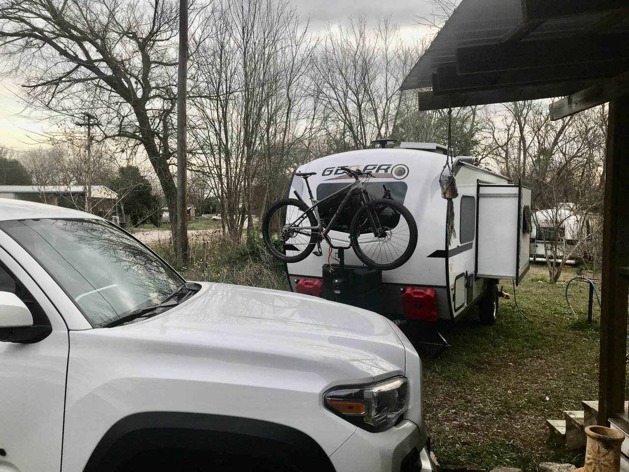

    That is kinda weird. Did the trailer come 'stock' with more than 2 batteries or propane tanks all sitting on or near the front?
    I originally opted for 30lb propane tanks instead of 20lb and it increased my tongue weight by 50lbs. With my bike and spare gas cans my tongue weight was too high so I had to trade them back for 20's.
    I added two rotopax tanks to my trailer for those long west Texas drives with no fuel (while I'm getting 8mpg in a headwind). Those full weigh 26lbs each. IMG_8666 2.jpg
