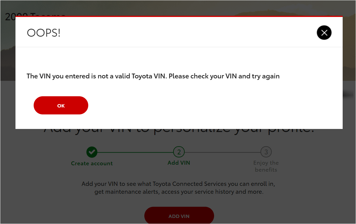

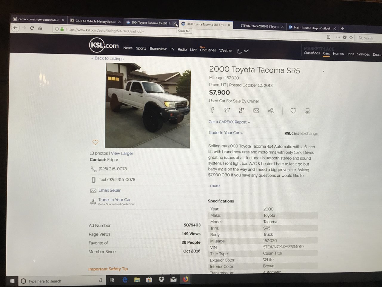

    Area51Runner
    Area51Runner Well-Known Member
    Jun 26, 2014
    #132748
    11,979
    Northern California, Bay Area
    02 3.4 DC TRD PreRunner 4WD SWAP
    So the photo you posted previously of the listing for the truck you purchased - I just plugged the VIN in on the Toyota Owners site to see what it was originally configured with from the factory (I was thinking it was shipped with 4WD and NOT a conversion), well Toyota says its not a toyota vin. Now maybe the picture you posted had part of the VIN cutoff for privacy but...
