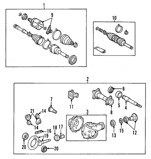

    I've come to the conclusion that it is the bearing right behind the flange that the driveshaft connects too, if it was the ring and pinion they would be making noise constantly right? Does anyone have a diagram for this?

    I believe I found the correct diagram and part (if it is the issue)
    It appears to be #13 which is 90366-30078-77
