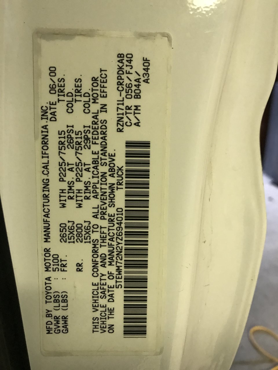

    So the code on my door jamb indicates that that I have 4.56’s , although everything I’ve read says they are rare. Just making sure that’s what I have...
  12. Oct 22, 2018 at 12:50 PM
    #112
    04doublecab
    04doublecab Well-Known Member
    Dec 13, 2016
    #204738
    423
    Jeff
    2004 Tacoma
    Yes that is correct. If the PO didn’t change them.

    ^^ And that you will never know unless you check the rear diff. That truck was modified and f-cked up pretty good, so don't believe what paper say. Just check yourself. The last thing you want is to run a different gear on front and back.

    jack back of truck up. mark on rear axle, and on both rear tires at 6 o'clock. tape end of piece of string to rear axle. turn both tires together (with a helper) counting full turns, until there's 10 turns of that string around the rear axle and the axle mark is at 6 o'clock again. estimate what % of a turn the rear wheels are at when the wheel marks are lined up and the axle mark is at 6 o'clock, add that fraction to the wheel turn count. 10 / number of turns of rear wheel == final drive ratio. :evil:

    Or easier jack only one side (leave the other wheel on the ground). Then spin the tire till shaft turns 5 times. Then do the math above (like for 10 turns when both wheels are up).
    Of course you have the truck on neutral.
