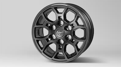

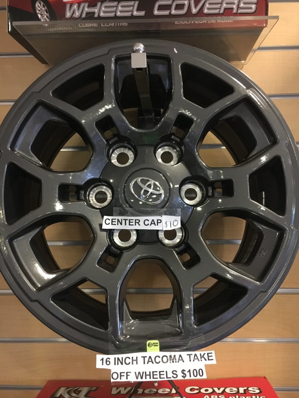

Just bought oem ‘take-offs’ from dealer, lug nut question

    why didnt you get the lugs there, from them?
    you will need OEM lugs anyway, the lugs with the captured washer.
    Your truck came with acorn style lug nuts on the steel wheels. You are correct, you cannot use those on those OEM aluminum wheels.
    here is a link to the exact part, you will need 24 of them: https://toyotaparts.mcgeorgetoyota.com/oem-parts/toyota-wheel-nut-9008494002/?c=Zz1mcm9udC1zdXNwZW5zaW9uJnM9d2hlZWxzJmk9ODUxNTM1MDUmcj1sYXllcl82JmE9dG95b3RhJm89dGFjb21hJnk9MjAxNiZ0PXNyJmU9Mi03bC1sNC1nYXM=
