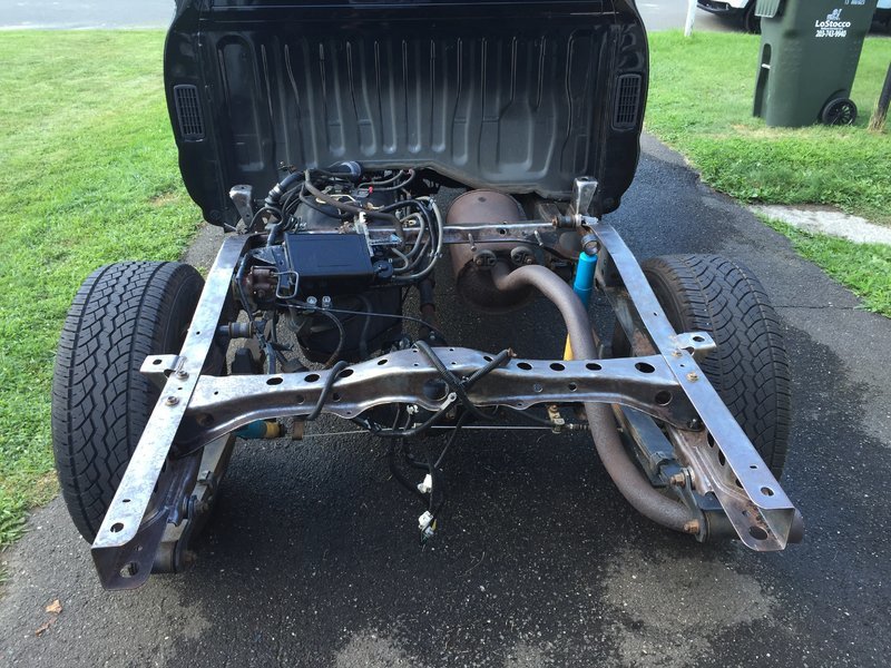

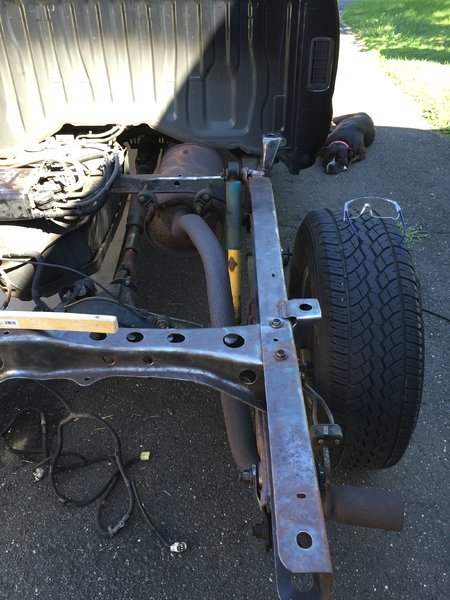

    Eastwood makes great products but with any rust treatment it might be best to at least grind down the flaky/heavier rust to bare metal, then sand it down with 50-100 grint before putting the first coat. Do that first before you degrease everything.
    After sanding/grinding and before degreaser:image.jpg
    After sanding/grinding & degreaser:
