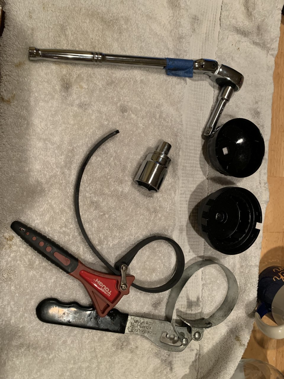

    I was just changing the oil and filter in my 2007 reg. cab 2.7 liter 4 cyl tacoma. I'm not using my floor jack. I have 3 different oil filter wrenches and none of them work! I was able to muscle the filter off and I put on the new one hand tight. What do you guys use if the filter is on too tight and you have to use a filter wrench?

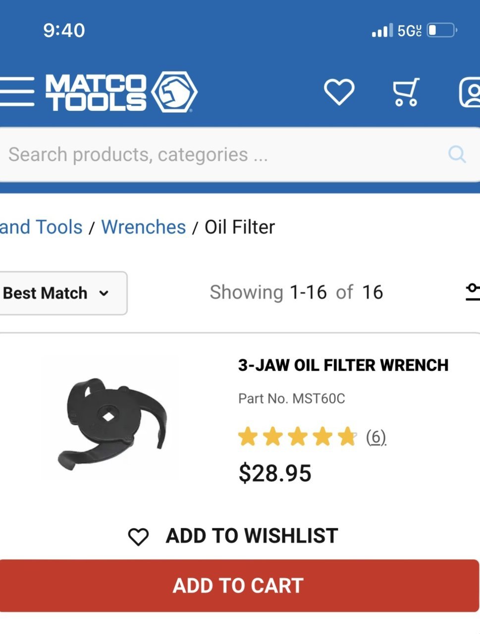

    $yoda$

    ^This. Works great and universal.:thumbsup:

    Stuck on oil filters absolutely hate ‘em.
    I have a 3 jaw version like the matco one above. They work great if there’s access to the end. https://www.amazon.com/gp/product/B004QP8BNS?ie=UTF8
    The band or strap type do work but again need access to the end enough to be able to get it on. I can get almost all off with the pliers type. https://www.amazon.com/gp/product/B0009WG5T4?ie=UTF8
    https://www.amazon.com/gp/product/B0052XR0FS?ie=UTF8
    I just bought a vice grip type but haven’t used it yet.
    https://www.amazon.com/gp/product/B000MD3EO4?ie=UTF8

    The correct metal size one sometimes slips simply put some tape or a rag on it and filter on the ridge area off it comes.
    Rubber strap wrenches stretch too much - want one that really works - Replace that rubber strap with an old fan belt for no stretch and better grip works great and no busted knuckles.
