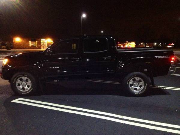

    NOV12: Front windows tinted to matched to rear windows 12NOV12: Fog light anytime mod DEC12: OME 885 w/ 25912 top plate spacers for full 3" lift OME Trim packer Dakar Rear 5 Leaf Packs Total Chaos Uniball Upper Control Arms 2.5° Degree Rear Axle Shims 18JAN13: 17x9 Fuel Kranks 17x9 4.5 BS -12mm Offset 285-70-17 Goodyear Duratracs 23JAN13: OME Carrier Bearing Drop Kit 05FEB13 TRD Aluminum Skid Plate 05FEB13 TRD Stainless Steel Cat Back Exhaust (2012 modified to fit 2013) Auto Mate 5304A (Viper 5704 Equivalent) 2-Way Alarm/Remote Start with Smart Start for iPhone De-Badged All Emblems 30JUL13 Go Rhino Stainless Steel Dominator II Side Steps *not yet installed: Stainless Steel Extended Rear Brake Lines
    i installed the rear dakars today, OME nitro-charger shocks, center pin spacers and 2.5 degree axle shims.
    2 hours 15 mins total install time, not bad for doing it alone, plus it was my first time working with leaf springs. i didnt have time to take pictures or measurements because i didnt have a tape measure at the time, and i was on a time constraint. i had to be out of the hobby shop by 530.
    i didnt install my extended brake lines either, i left the brake line bracket off the axle to give it some extra slack, it looked pretty tight and i would definitely recommend them if you are going with the dakars in the rear. brake lines will be done at a later date when i have someone to pump the brakes for me.
    i can tell you the truck looks sooo stupid right now with no front lift, i will do the front tomorrow. shouldn't take more than an hour for the front as the coils are already pre assembled.
    im really sorry i couldnt get measurements and pictures of the install for you guys. i will take pictures of the truck tomorrow with the ridiculous rake and you can make fun of it to make up for my lack of pictures and measurements
    if you are somewhat mechanically inclined its pretty damn easy. i referenced off PSU Taco's install/write up and that was really helpful.
    i have a small shudder/vibration when i accelerate from a dead stop at about 7-8mph then it goes away, but it also did this when it was stock as well, ill throw on a CB drop kit and see if that helps at a later date as well.
    any questions, comments feel free to ask. if i did it again, i could probably do it in 1.5 hours now that I've been through the motions, so if anyone needs help and lives close enough, buy me a 6 pack, lunch and ill turn some wrenches with you
    ill try to get you some pictures and measurements of the front tomorrow.

    I was more worried about the rear than the fronts, and the rear was pretty damn easy, fronts should be a cake as I've worked with many IFS before.

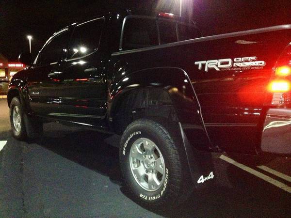

    face down ass up... thats the way we like our truck :ohsnap: not the best pics, but you get the idea, will get some during day light hours tomorrow. driving with the headlights on with this rake, they are pointed straight down, like if it were just fog lights on only.

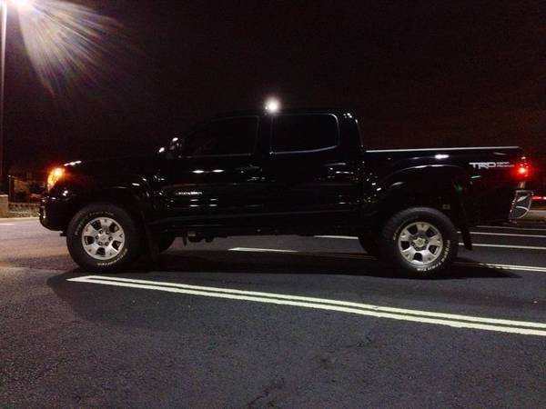

    Did you get the OME AAL as well ?

    negative... just the CS047R i think there are 4 leafs and 2 overload. no more leafs. 1 of these dakar leaf packs was as heavy as both my stock leafs (3 leaf)
    jumping up and down in the bed the rear moved quite a bit, with the dakar's it barely moves... rides smooth, but firm, i cant explain it... maybe "planted" is a better way to describe the rear.

    Yeah , I have Dakars
    Yours just looks really high but that could be because the front is so low currently

    yeah, its pretty damn high, the brake lines were stretched pretty good, ill have to get the extended lines on there asap, i dont like the idea of the bracket just dangling there.

    I have a couple inches of slack under flex with my stock brake lines
    Yours are probably tight because the front isn't done yet
