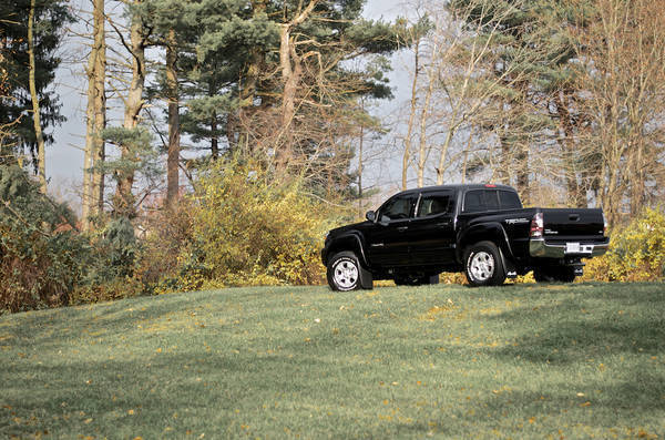

    looking at the front tires from the front i can see i have some really positive camber truck looks like \-----/ so im glad i got them, because tires... are not cheap

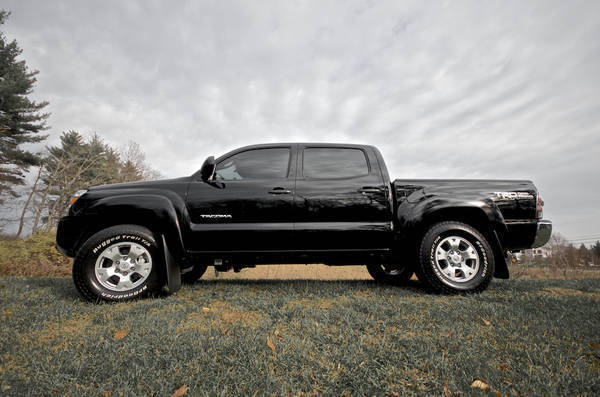

    bone stock a few days after i bought it, not a bad looking truck, but it definitely needs to stand out from the rest of the taco's i see
