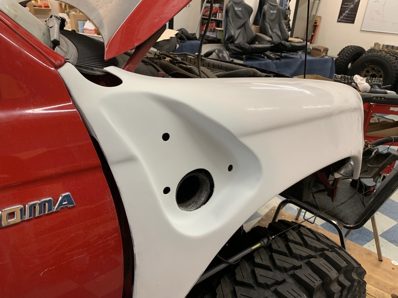

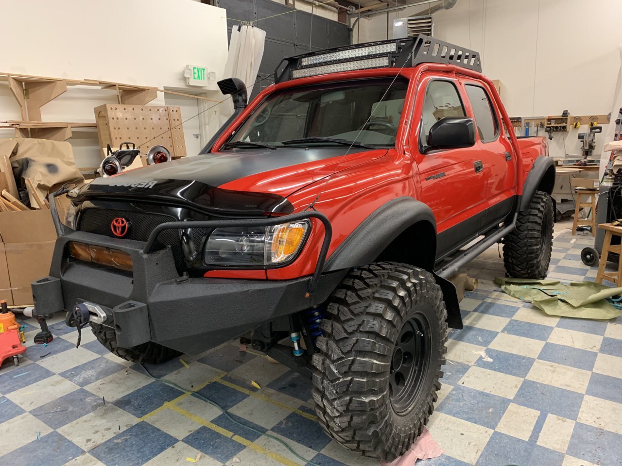

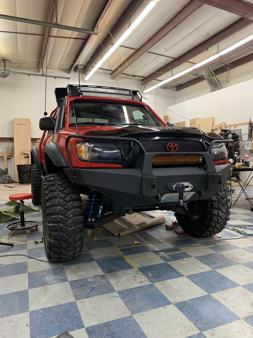

    No. Those a flexifares that I shaped and Raptor coated. They are on fiberglass 6 in flare quarter panels That I customized.

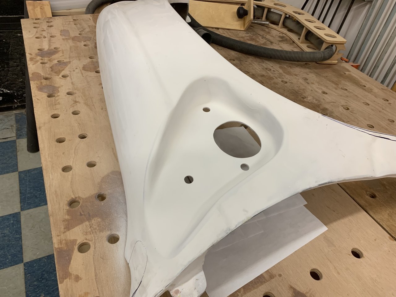

    I took a while. I made a negative mold with fiberglass, and laid it into the flare quarter panel. There was quite a bit of shaping and smoothing, but that’s the beauty of polyester resin; if you don’t like how it looks, just add more and redo it. I did have to bend the snorkel with a heat gun to get it back to the windshield, as its new position was still about three inches out from stock.BDF03A28-B6DF-49E5-B008-A5DD89164BA9.jpg

    I also had to fit it past the eco cage, which was a bit tight

    I get it. I bought the truck in 2004, and finally got the opportunity to spend time on it. Everything seems to take ten times longer than I think. I am also 60 years old, and have been collecting tools and teaching myself how to fab for almost 40 years. I kinda started this project in 1978 with an old Scout, a few used hand tools and a gravel driveway. Life, marriage, kids, job, all got in the way of my 4x4. It has taken all this time to get to a point where I have the time and tools to really move projects forward.
    Don’t get discouraged with your skid plates. Do what you can, when you can. if you are in Western Washington, we could work on your plates together. My two sons have become pretty good fabricators in their own right, and they can help as well!

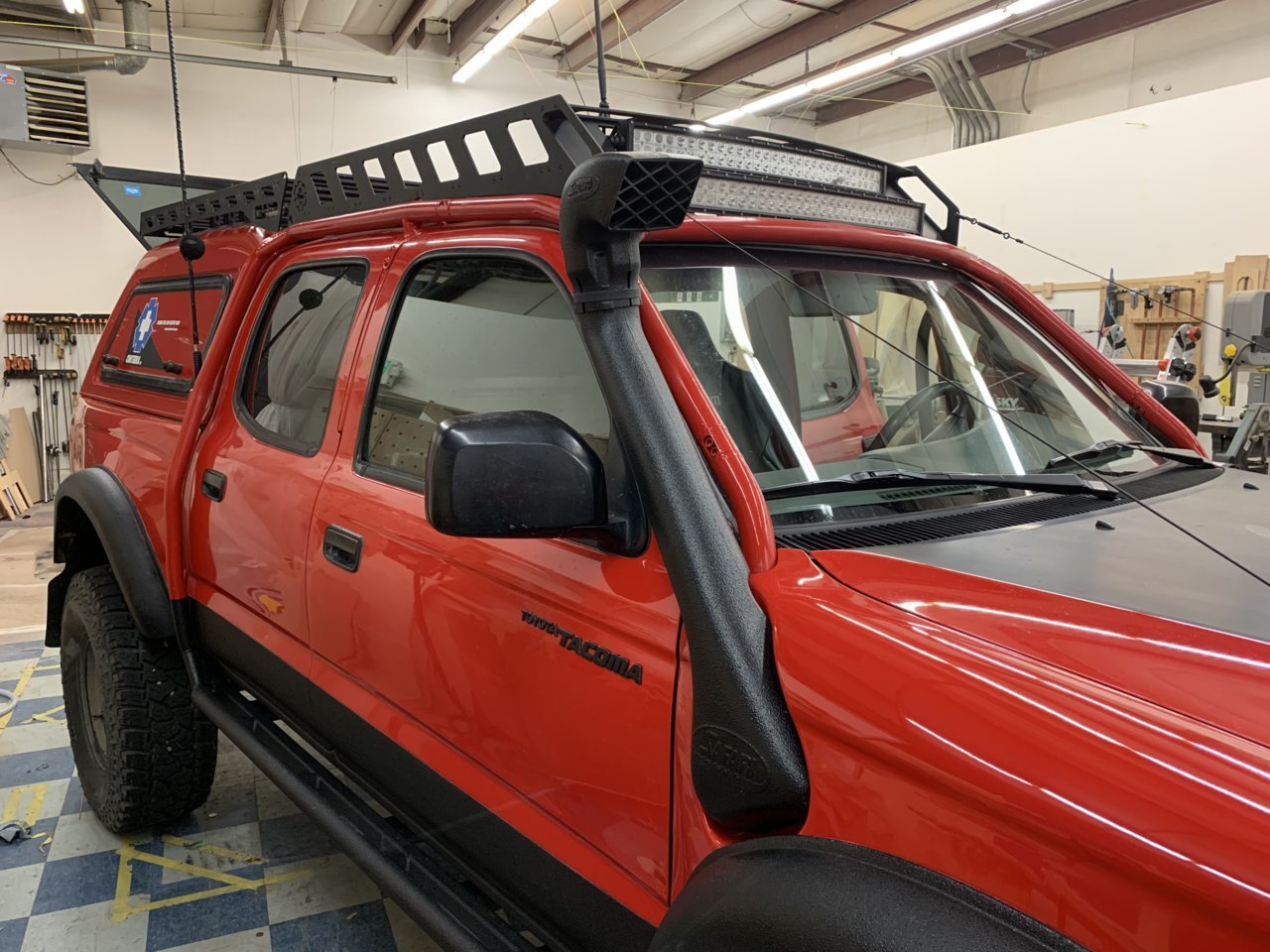

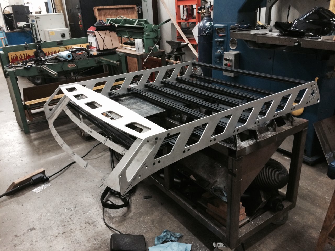

    Hey Rick, got any more pictures of your roof rack? I've got a ARE MX topper and I have been planning on building a rack very similar to your front one for the cab so it will line up with the topper rack. I don't think I'll do dual light bars, but the overall design is pretty similar to what I had in mind.

    That front bumper tho :muscleflexing:

    You not runnering oem lower control arms from what I see right? If you are running aftermarket lower control arms where did you get them?
