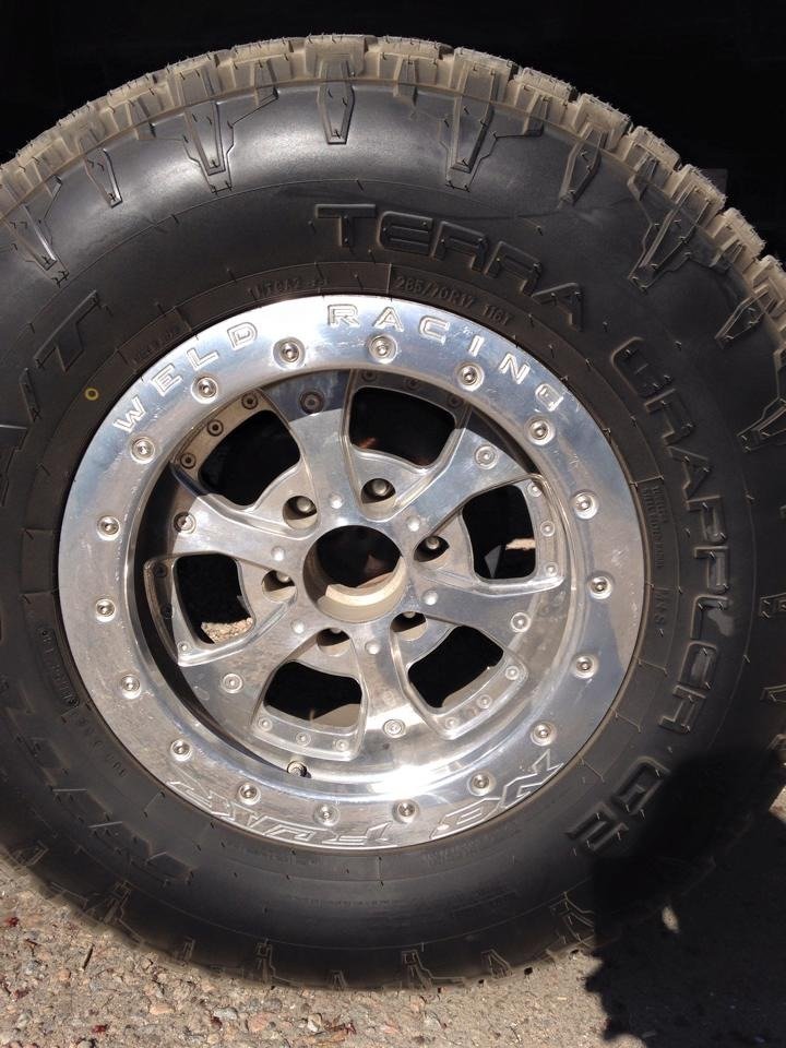

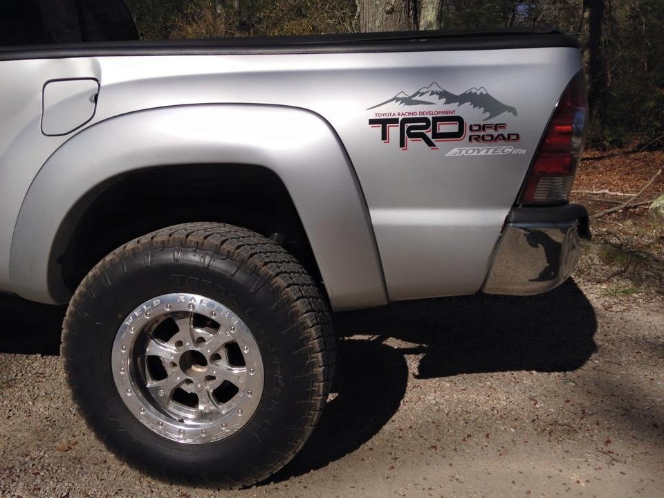

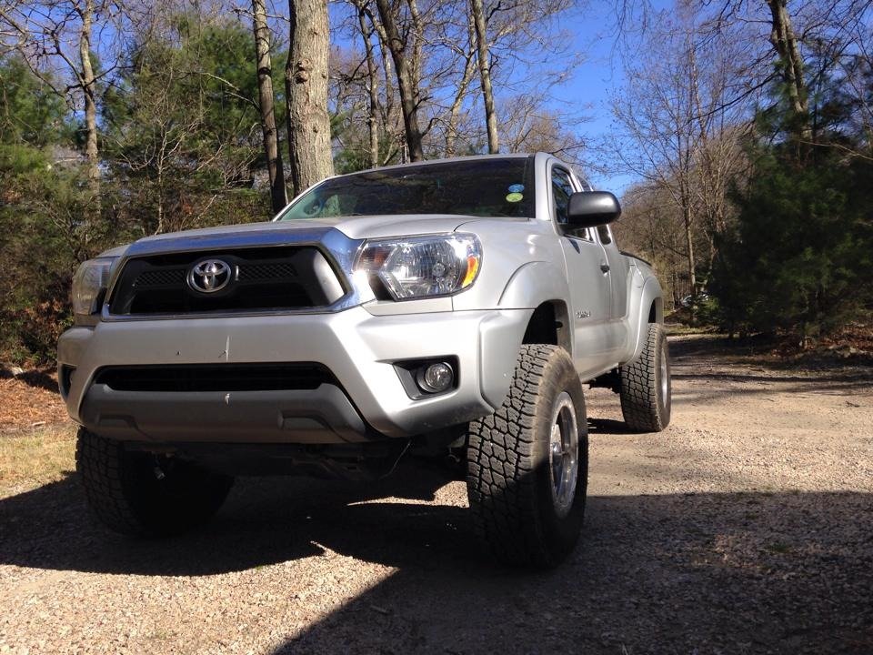

    I decided to go with a Toyec 3 inch supension lift with new bilstein coilovers and add a leaf in the rear. Also a diff drop kit. Took about a day to instal everything, included new wheels and tires. Tires are Nitto Terra Grapplers...... 295x70r17 Wheels are off the No Fear edition Tundra, I bought them off a friend for a few bills. I'm really happy with it, thanks for the good tutorials and suggestions guys.

    Looks nice get rid of the Diff Drop. Not needed on the Second Gens. They can do more harm than good, research them

    I've come to the same conclusion through my reading, hardly any improvement to your angles either. Nice work on the lift.

    Nice work!Looks good and those wheels are unique!
