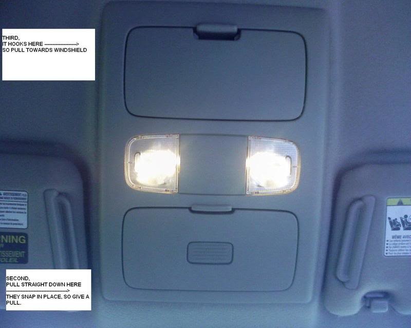

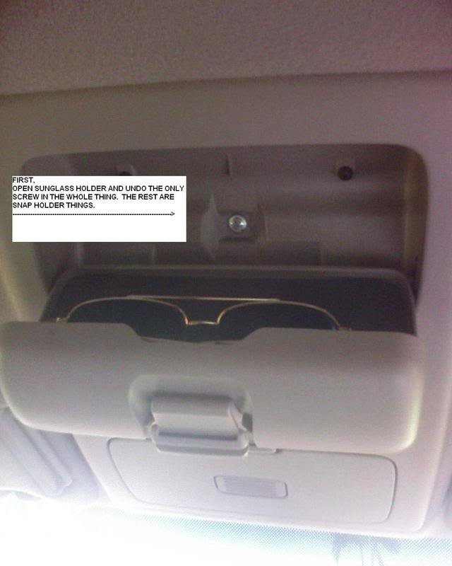

    okay thanks for the replys! Here's my shitty writeup how to take the map light thing down.
    First, open the sunglass holder. There's one black Phillips head screw in there (i lost it.. so i replaced it with whatever i had around.) This is your only screw in the whole thing.
    Second, towards your compass (or garage door opener thing) you will have to grab the whole unit at both corners and pull straight down from the headliner. Its held on with those press fasteners.. i know there's a better word for it, but they snap in place without screws or anything. ease it from one side, then the other.. it'll come loose without tools.
    Third, when the front is loose, the back has a L shaped hooks keeping it in place. You'll be able to just pull the whole unit towards the windshield and it will hang by the two plugs. Unsnap the plugs and the whole unit will be in your hands. You can take it inside and do your soldering at that point.. Then follow the instructions in the free mods section and you're set! If i can do it, anyone can do it!

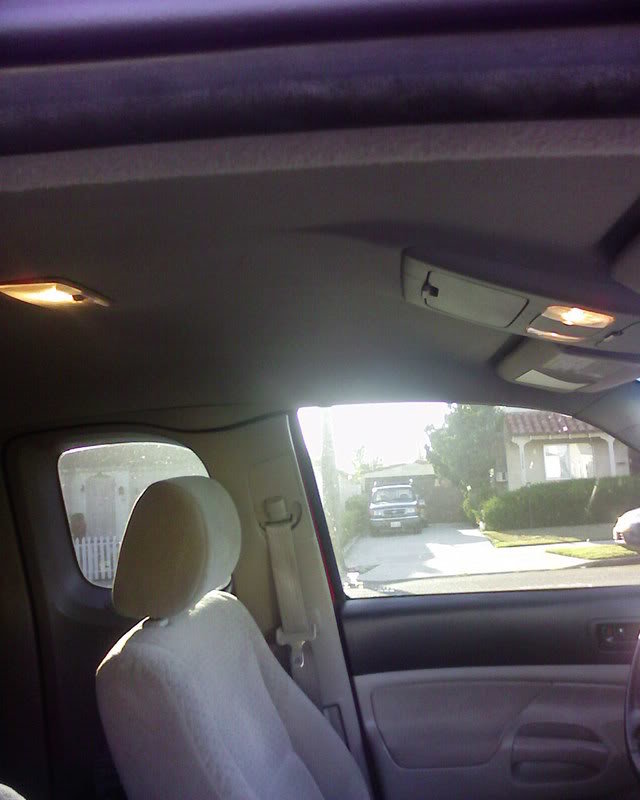

    Now, about the dome light, it comes off very easily. Three snap connector things. Just get your fingers in there and pull evenly on all 4 corners. It'll make sense really fast.
    Anyway, picture time!!
    Heres with the door open! It really does dim just like the dome light. I love it:

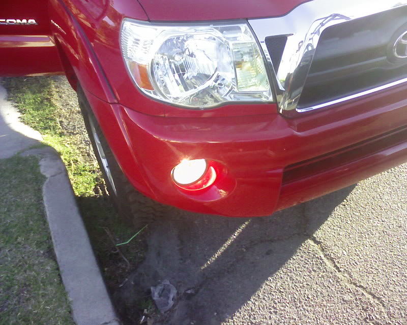

    And my mod with the fogs on anytime!!
    They turn off with the key.. so i'll use them as day time running lamps. Awesome. =)
