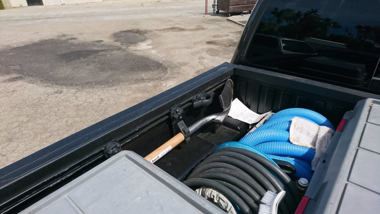

    Ok so I did some more shopping for my recovery gear. Picked up some Quick Fist holders for my shovel that will go on the driver side of the bed. Ordered a replacement bulb for my vintage GE automotive spot light. Can't believe I found it on ebay.

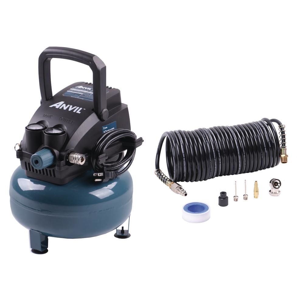

    Bought an Anvil 120v compressor and glow in the dark locking tire gauge inflator. US Cargo 3" 30' recovery strap along with a Curt D-Ring trailer hitch. I know it's made in China but Amazon sells these for 27.00 with the D-Ring and the hitch is made from solid steel I'll give it a try. Just like my shovel from Home Depot made in China now if the shovel fails which it shouldn't I will avoid PRC indefinitely if possible...

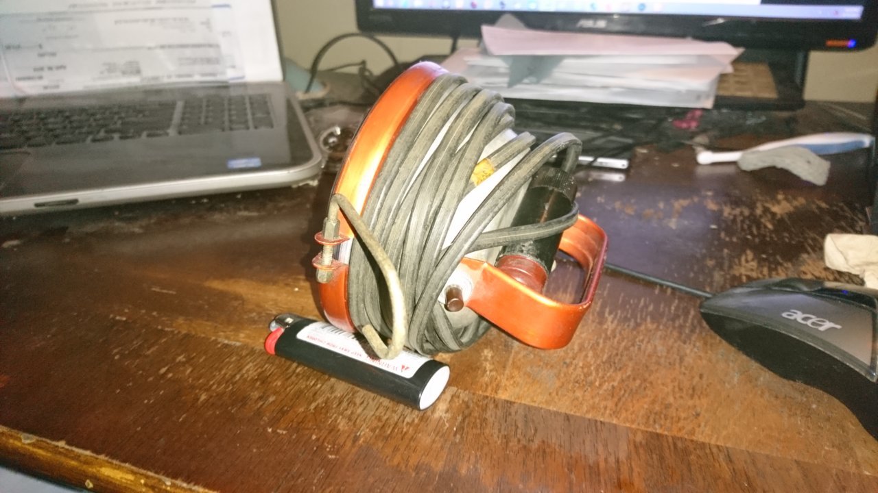

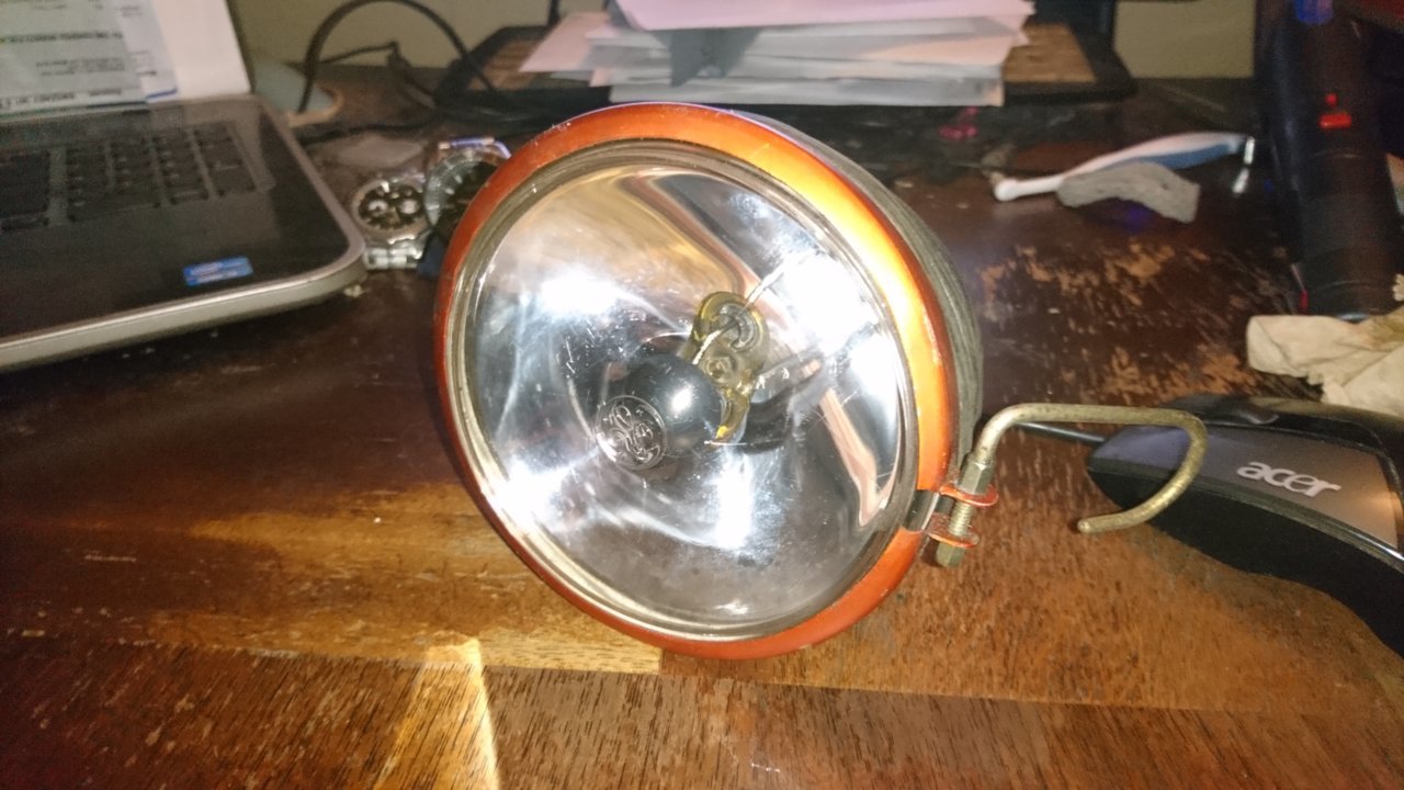

    6 volt 30 watt automotive lamp, this thing is bright enough to spot.
    Compressor pulls 2 amps that should be 250 watts so the stock inverter should have no probs.

    I would put money on the compressor not working. In the specs is only pulls 2 amps, but on start up they can pull 3 amps or more.
    It’s easy to keep it spinning, it take a lot more effort to get them to start spinning.
    Therefore you wound be better of with a 12v compressor that can clip to the battery. While most don’t have an air tank, it’s not needed.

    Well... if the fuse blows then I'll know LoL!

    You really should just get a 12v compressor. You waste a lot of energy converting form 12v (truck source) to 120v. Way smaller, lighter, and more efficient. That tank won't be any use for inflating tires (you might get a few psi in a motorcycle tire out of it). What is that, like a gallon tank? I have a 5 gallon tank and it will barely inflate ONE of my 32" tires from 18 to 30psi.
    Get one that connects direct to the battery, too. Then you don't have to worry about overloading a circuit.

    Sounds like sound advice. I will return this thing, and go with your rec of the 88P.

    Soo... went to the Depot and grabbed some flat bar and went to town on my shovel mount. Since I had a shit load of the OEM cleats I used the OEM T- Bolt spring with knob. It seems pretty solid but until I hit the dirt rocky road time will be the true test.
