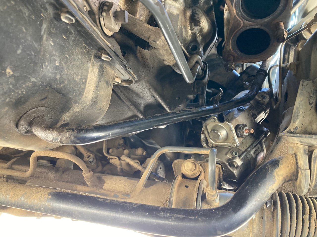

    Getting the starter out. It's been clicking (not engaging), so I bought the little kit and happily tore into the project this morning thinking I'd easily back on the road by afternoon. Uh, no.
    This is a '98 SR5 4X4 with the 3.4 V6 and automatic trans. I perused several YouTube tutorials over coffee and then, tools in hand, headed out. Piece of cake.
    By about 2 p.m., covered in grease and blood, I took a break. The starter was free of the block, but I could not for the life of me figure out how to get that sucker out. Removing the little bracket didn't do it. Removing the downpipe didn't do it. (Although those things did give me much better access to it in the first place.) WTF?
    I cleaned up, watched a couple of the vids again and realized - with a fair amount of horror - that they all dealt with trucks with manual transmissions. While I would have loved a manual, I got a deal on this auto truck. And guess what? The auto tranny dipstick tube is a solid, nonremovable tube that comes out of the tranny pan at an angle and routes up through the gap between the engine and frame. It is right, dead in the way of that starter coming out. It is non-bendable, and, as noted, you can't remove it from the pan.
    So tomorrow I drain the tranny, remove the pan, get that %*& starter out, fix it - and as they say 'reverse the process' to put it back together. Maybe I should make a video of THAT.

    I recently just did this job, I have a 2004 4x4 auto and was convinced I’d have to rebuild the contacts with the starter floating inside the engine bay. Nope! If you have one, try removing your anti sway bar, the starter in theory can come down and out from “behind and below” past the steering rack. Small rotations and tilting the aft end downwards until it’s almost vertical on it’s way passing through. It required much finagling, but I didn’t have to remove anything else or bend or push anything aside to get the sucker fully out.

    Getting to the top bolt, without stripping it was the real concern.
    Everything else is cake. Removing the dipstick tube on the transmission pan is easy too.

    Never considered this trick. I'm going to go try it right now. HEre's a pic to illustrate the issue underneath. The black tube is for the tranny dipstick. It is the main thing in the way. If I can get it out up top per O'Silver_Taco (and I think a couple others) I will owe you guys a six pack each! LOL

    I have a 4 banner 2wd auto, and my tube comes apart at half way point.....o-ring in there....
    when I replaced PS hoses I had to remove top and swing lower a little bit....

    Going back to the other post, I'm realizing the OP is wanting to remove it from the bottom. Most everyone removes it via the wheel well.
    Only way for that to work is by dropping the transmission pan.
    Why is he fishing it out the bottom again?
