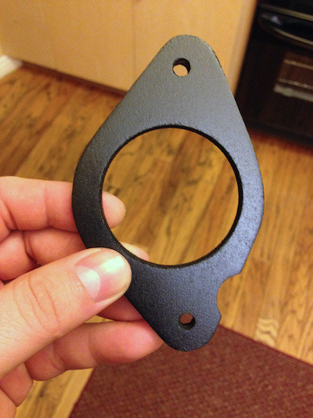

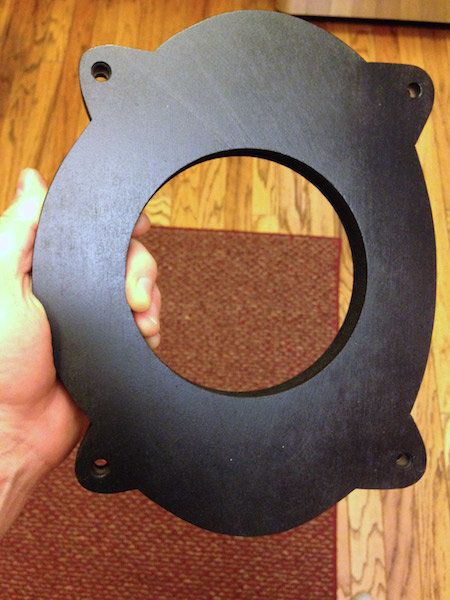

  12. Jul 9, 2014 at 5:08 PM
    #32
    packrobottom
    packrobottom [OP] Well-Known Member
    Mar 11, 2010
    #33040
    257
    Pack
    Sky Silver SR5 DC v6 with sport mods
    ok just made my speakers adapters getting ready to put em in. I have the wire adaptersx2 the speakers (polk dxi6501) the bolts I got from home depot.
    used 3/4 MDF and sealed it with krylon multiple coats. For the tweeter I used 1/4 MDF and sanded it down a bit below 1/4 so I could just use the factory bolts.
    any thoughts on where I should mount the cross overs.
