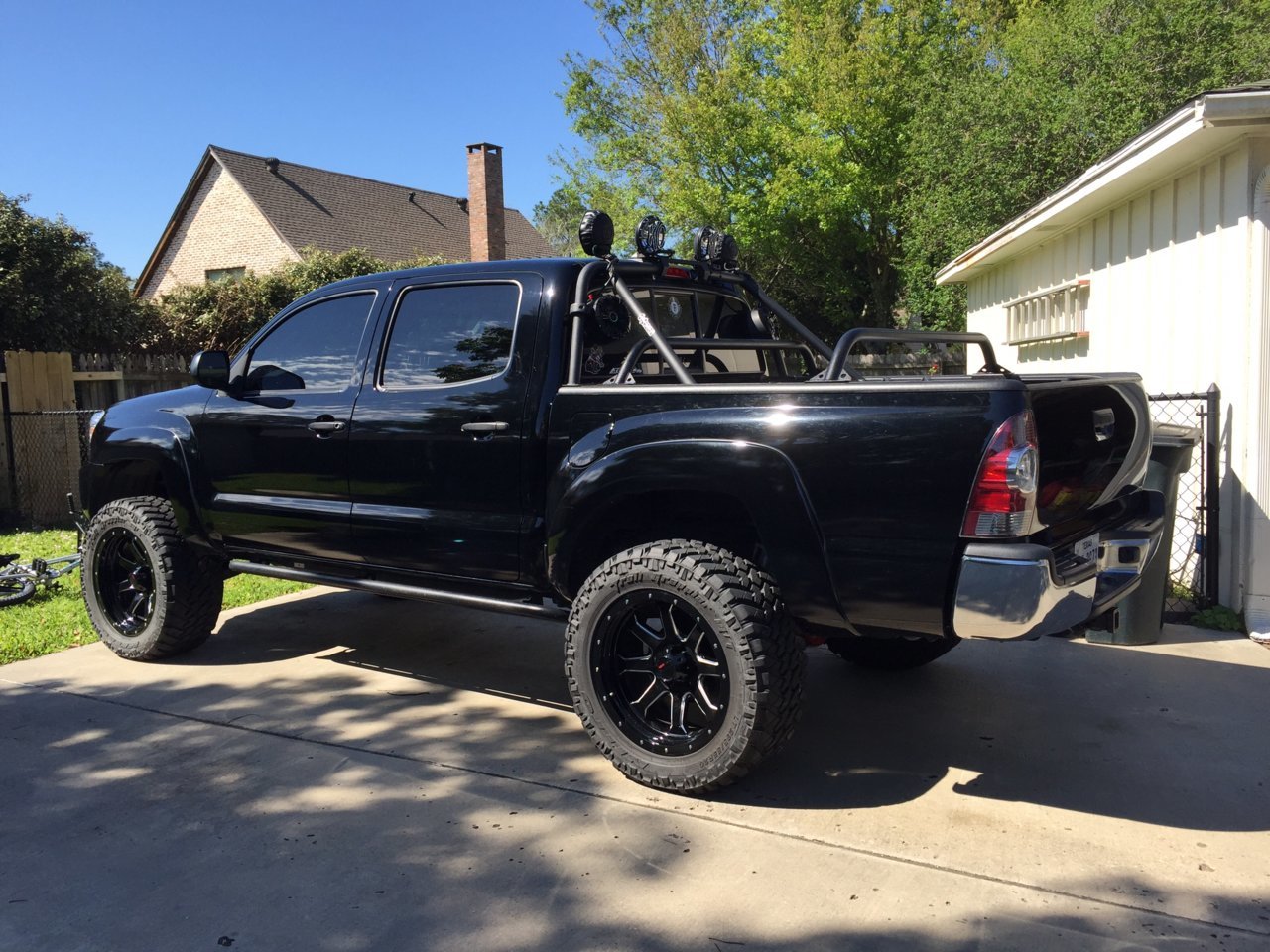

    Deep ass dish 20’s with mud terrain tires look like shit.
    piratepegleg and Thatbassguy like this.
  11. Nov 2, 2020 at 10:47 PM
    #31
    Texas T
    Texas T Well-Known Member
    Feb 20, 2015
    #149178
    2,842
    TX
    '14 T Force
    37EE906F-40D4-43D3-A62F-7A4BABC6CA1C.jpg I’m over it

    Mine aren’t even deep but 20’s with 33’s look like shit to me now. That’s what I have so I can say it.

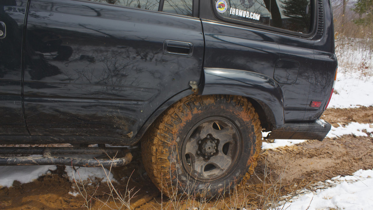

    Coming from the Land Cruiser rock crawler world we really don't do offset wheels and stick with the stock rims so we can stuff the wheels even with 35's. Which is pushing it. If you do some light wheeling with minimal wheel travel you should be okay but longer travel with the need to stuff the tires in the wheel wells any offset beyond stock is a waste of money. Will you be rock crawling or have a need for long travel suspension?
    These are 33's stock rim/offset. Any more offset and i'd be rubbing or land on the top of the tire.
