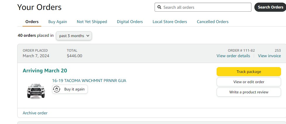

Just got a FAB FOURS TT16-N3652-1 Bumper for $446 on Amazon!

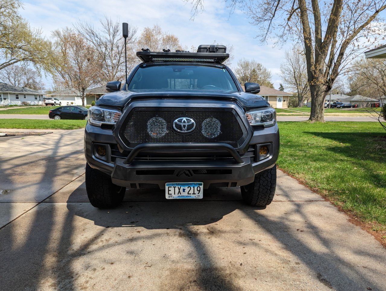

    I've had that bumper for almost a year now.
    If you aren't mounting a winch you can install it super easy with very minimal cutting.
    I didn't have to remove the grill or any body panels. Just pull off the crash bar, cut a bit of plastic on the underside, and bolt the bumper on.

    All of the cuts are hidden by the bumper, you only need to cut some unpainted plastic on the bottom.
    It has a ton of space to fit any 30" light.
    I plan on making a custom bracelet to hold 4 Diode Dynamics ss6 lights, 2 fog and 2 driving.
    Here is a picture of where the winch would mount

    I plan on getting a piece of aluminum L angle, cutting 4 rectangle holes in it for the lights to shine through, then bolting the aluminum to the bumper. I have an auxbeam switch controller so I will have the lights wired to that.
    I have it mounted on a ditch light bracket.
    It's a WeBoost cell phone booster. Gives your cell phone better reception but doesn't increase cell phone coverage, so like if I have 1 bar of service the antenna can increase it to almost full bars.
    When my wife and I go on road trips she works while I drive and needs strong cell reception for work.
    For radio communication in my truck have 2 handheld GMRS radios, that way if I need a spotter or am recovering someone I have a radio to let them use.

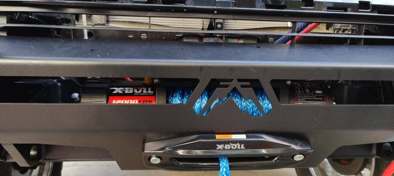

    Joseph
    Hub City
    2023 TRD Sport

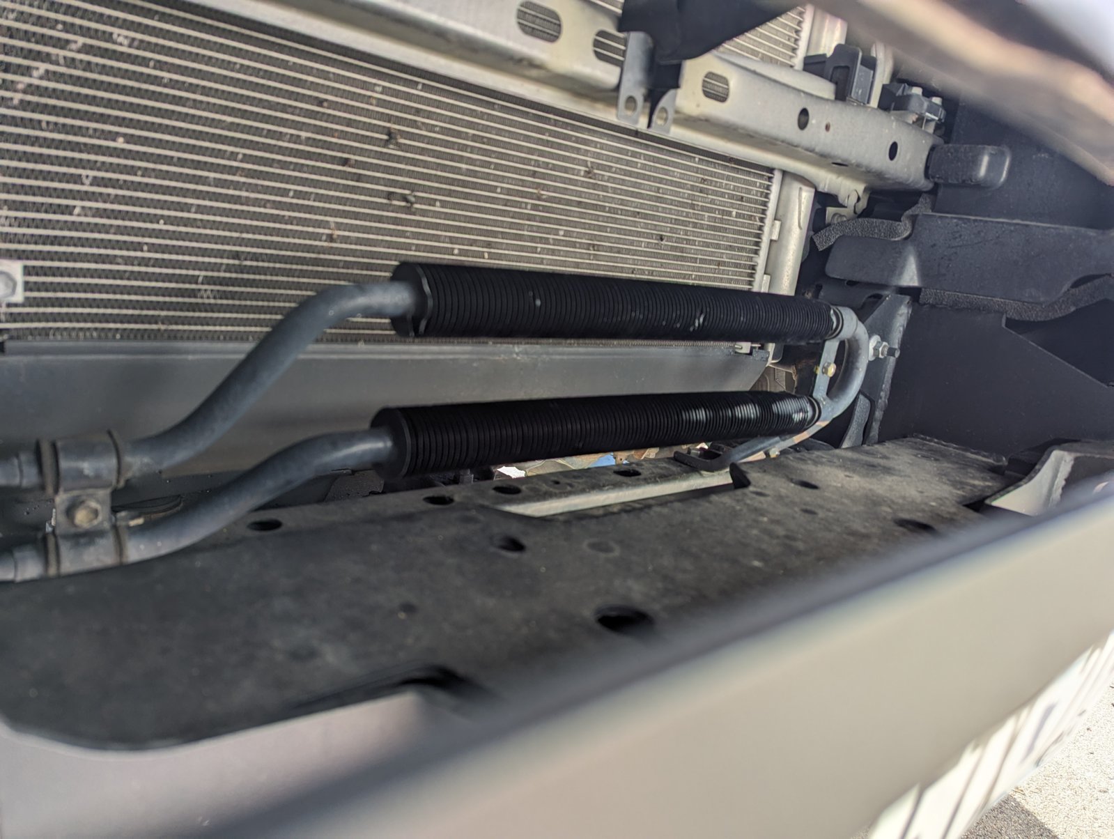

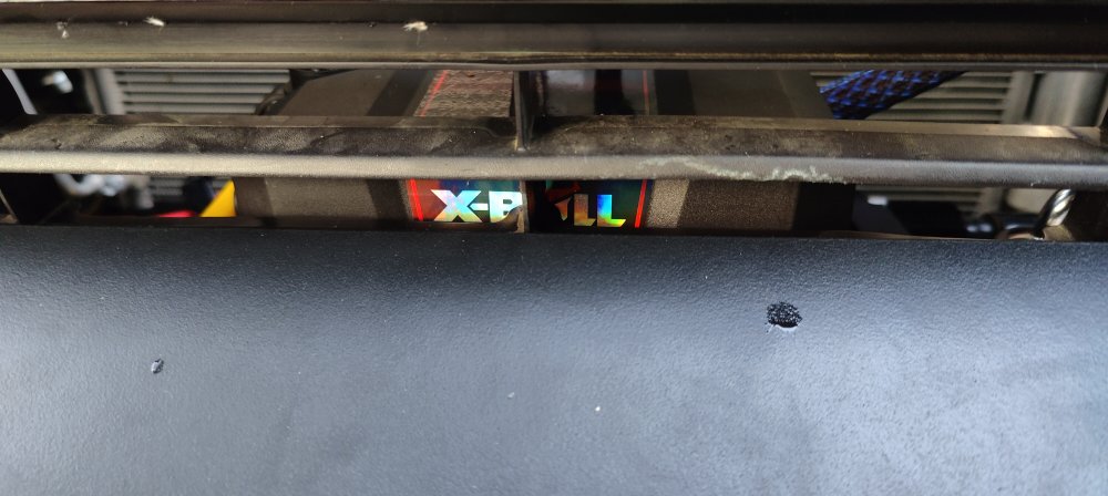

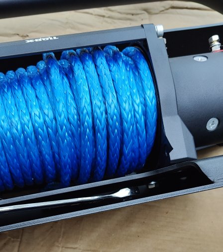

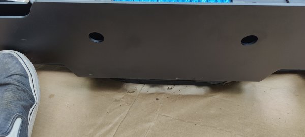

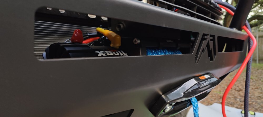

    Bumper and Winch came in this weekend! Over all build quality and powder coating is top notch!
    Now there is ONE DESIGN FLAW! The only way to tighten the front winch bolts if through a tiny slot using an open ended wrench, turning the bolt like a quarter turn at a time. Drove me nuts!
    Why they did not include access holes to the front bolts like they did on the rear bolts is beyond me. I'd like to buy the a winch for Christmas and drink a case of beer while THEY try to install it.
    Only other small issue was craming a 12,000lb winch in there was tight. Total weight of the winch and bumper was about 150-175lbs (just estimating). I kept having flashbacks of an old Married with Children episode when Al and Dexter where trying to shoehorn a shoe on a lady. Took my and my neighbor with some interior panel tools to wedge thr control box in, but we got it.
    All in All very well built unit, very strong and the one thing i really love is that it covers the portion of the OEM bumper cover that you have to cut out. You do not have to hide the cut with rubber trim like you do with other winch mounts.

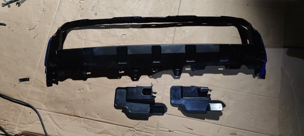

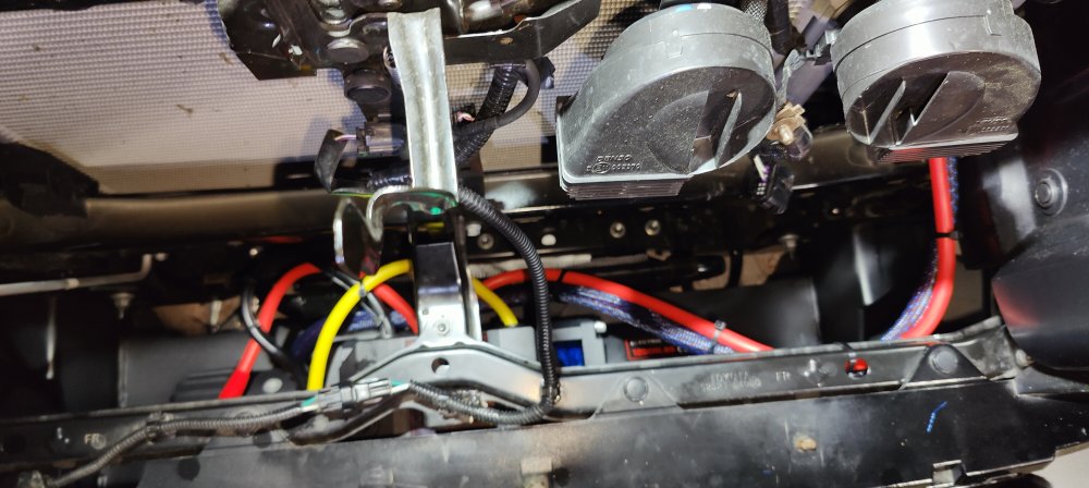

    Here are the parts you have to cut out, a part of the bumper cover and a part of the radiator cowl.
