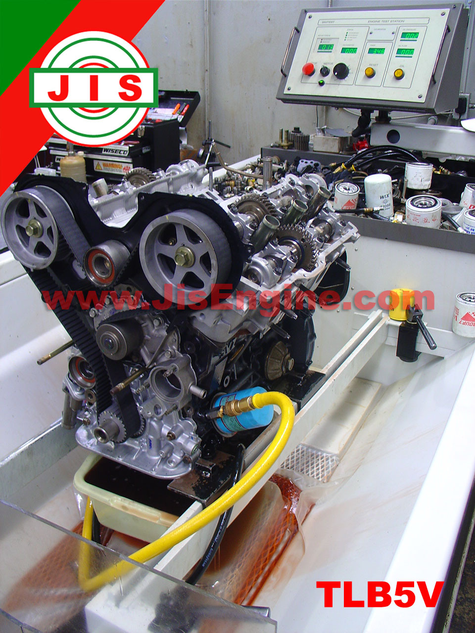

    That is an awesome deal! I definitely would have considered this route if I had known this was available, everywhere I looked said they didn't reman the 2001 3rz. And that warranty is almost better than Toyota's current warranty!
