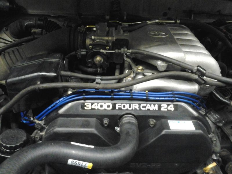

    Well it looks like I should probably just get another motor. Took down the plate in the oil pan and found some not pretties. I was also wrong about the shavings before, they are metal and seem to be from the cylinder wall. Odd part is that it seems to be from a different cylinder(was on the middle of the crank) than the one the spark plugs shot out of (passenger back).
    If you look towards the back you can kinda a shaving being the connecting rod. Rod kinda looks cracked in the picture, don't remember seeing that.

    Ouch. Yup, looks like motor time. Did you get your title yet?

    Time for a new block...I suggest getting the JIS engine, but that is my opinion.

    There is no freeing this one and having her run again. Too much metal in the oil pan so my guess is that the piston made itself a groove into the cylinder wall and is stuck on the lip.
