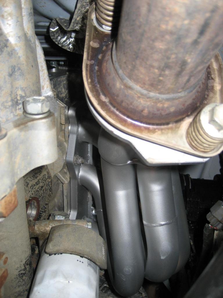

    quick question, does the LCE header bolt right up to the stock exhaust? Or does it require some modifications to make it fit?
    Main reason I ask, I don't have a welder and would like to eventually get one of these and really hate getting shops to do installs for me. I have had some bad experiences with shops.. namely installing headers on vehicles

    No welding. The header fits like a glove. :)
    The stock down pipe remains exactly where it was with the original manifold.

    Yep. Direct fit. No change in sound as far as I can tell. Definitely worth doing.
