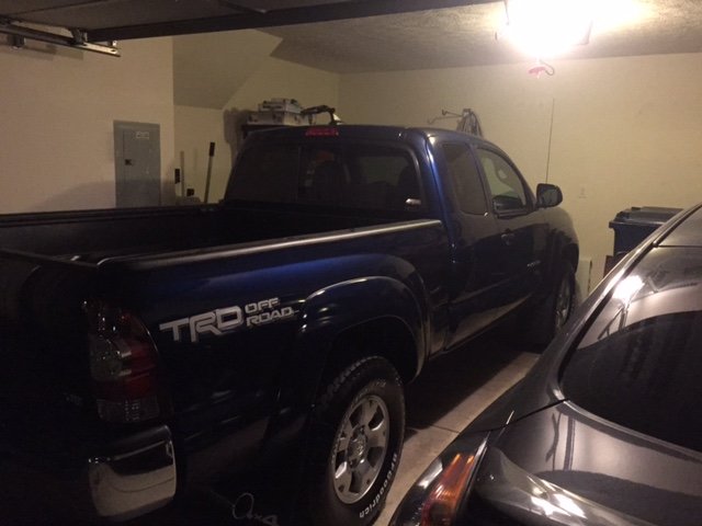

    Hello!
    Long time lurker, first time poster. I just picked up the truck I ordered in October. I've had a handful of Toyota's before, including a few 4Runners, but this is my first Tacoma (also first brand new truck.)
    I got a blue Access Cab 4x4 TRD Off Road V6 with a 6-speed manual and the Premium Etune. I had a few questions I figured some of you would be able to answer.
    First, the front doors seem hard to close. They only want to latch half way, or however you say it. I feel like I almost have to slam it to get it shut. I'm thinking two things are possible. 1. They are new and just need to get broken in, or, 2. they are very tightly sealed to reduce noise since there is no frame for them to mesh up to (i.e. they are butting up against another door since it's an Access Cab.) Anybody else noticed this?
    I got the manual transmission, and I have a switch for something called a Clutch Start Cancel. The owner's manual states "The switch allows the vehicle to be driven out of difficult situations by cranking the engine with the clutch engaged." I've had some 4Runners in some pretty hairy situations off road, but I can't imagine any where cranking the engine with the clutch engaged and the transmission in neutral would have helped. Surely they're not suggesting cranking the engine with it in gear and the clutch engaged?!?! Very confused why I would ever use this...
    I'd eventually like to pull a boat with it. I got the V6 towing package. What are some suggestions for a brake controller? Any other must haves before I tow that aren't stock?

    P.S. Sorry the picture sucks. It's 2 degrees here with 30 mph winds. I really didn't feel like going outside for anything...
