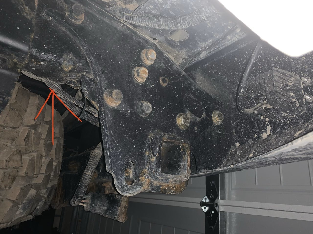

    what would you do
    if this was you...
    I wonder how to find a good body shop that would provide an accurate estimate and damage assessment,
    and if they would even remove the bumper to see if any other parts are damaged
    because supposedly body shops suck. At least that's what my friends who worked in them say. Not to mention the numerous cars I've seen "repaired" by body shops, with the workmanship of a 2nd grader

    Sorry to hear it man.
    I’d first crawl around under it to assess the damage myself.
    That way, I’d have a good basis to go off when the Bodyshop called to tell me their findings.
    If they found the same or more damage, Good.
    If they found less, Not so good.
    Personally I’d want to be sure the Frame and Towing Receiver are Good.
    As those are really important to me.

    judging by where it looks like the brunt of the impact was your probably just going to need a bumper. but pulling the bumper to check the frame is a must.

    yeah, not sure if I should pull the bumper myself (probably pretty easy) or hope a body should would even go that far, versus their usual theme of just snapping some pictures, writing up a cheap quote, and then sending that to insurance.
    Hopefully nobody gets mad if I remove the bumper myself (such as the insurance company or body shop)
    but then again, if I screw it back into place (re-install with bolts) after done inspecting myself, they might never know.
    Either way, the bumper will probably need replacing.
    Am just not sure currently if there's further damage beyond/worse than that, such as a bent frame (expensive and potentially totals the truck)
    I hear one way to check that is to have a body shop put the truck on a frame alignment jig to measure it, a service that normally (if paying out of pocket) I think is like $100-300.
    It seems to feel a bit weirder now driving straight (the truck itself, and the steering wheel); maybe it wouldn't even look straight on a basic laser alignment rack...

    Typically body shops will put it on the frame rack and check. You can peak under the truck and see if you have any kinks in the frame. About how fast was the guy who hit you going?

    Your probably bumper only

    I do agree with the others comments though. I don’t think there is much if any frame damage but of course a frame alignment rack will answer that. I can tell you from experience that the hitch (of which the bumper is attached to) is stronger than the frame and the frame will buckle first:
    (Crumple zones and all that)
    I’d be willing to bet it was mostly cosmetic damage to the paper thin steel that is the rear bumper.

    It's just the bumper. If the frame had any damage it would be obvious when looking at the gap on the side of the truck between the bumper and the body and that trucks gaps are perfect.
    The bumper is easily replaced.

    Your truck is most certainly not totaled. I highly doubt you have any frame damage. Most reputable collision shops can do a very accurate estimate of your damage without pulling the bumper off. From what I can see, all you need is a new bumper. Don't over-think this one.

    A plate bumper is much more likely to get the frame bent in an accident than the stock bumper, that's why the stock bumper is so weak in the first place. This trucks frame didn't bend which directly contradicts your statement that "these weak ass frames will fold no matter what bumper you have on the back...". There is no possible way this trucks frame is bent.

    I was rear ended about 3 weeks ago sitting at a red light. Guy hit me at about 10-15 mph. I have the OEM towing package (2006 PreRunner) with an extender and ball in place. No damage to the truck. Guy's Minivan had a big round hole in his bumper.

    High school girl texting in stop go traffic did the exact same thing to me last summer. Took it to the body shop at the Toyota dealer.
    Her insurance cut me a check for $1200 which was for a new bumper, re-coating my trailer hitch, and labor. I left the dent (OR chrome bumper so less noticeable) and ordered a CBI front bumper with it.
    Edit: Also there is a lot of bent frame hype on tacomaworld. I was worried about mine too as a result. Body shop checked and said it was totally fine. I wouldn’t worry too much if it was low speed.

    This has been pretty well covered but I'll add my 2 cents anyway. That appears to be very minor damage with no chance of frame damage. You just need a new bumper but you (& the body shop) should see if there's any damage to bumper mounting brackets. Not a big deal. If the other driver has insurance they will pay for it. If you get stuck with the repair, you can easily unbolt the old and bolt on the new.

    Fortunately, the impact missed the tow hitch, which would've involved the frame. I know that when my rear bumper was hit a few years ago, the dealership quoted a colormatched rear OEM bumper at $1200. As of the result, I took the offer of the driver for $700 cash. Luckily, what he didn't know that when I tried to call his insurance, I was told it just lapsed. Ended up with a body armor rear bumper and the rest on a new leaf pack.
